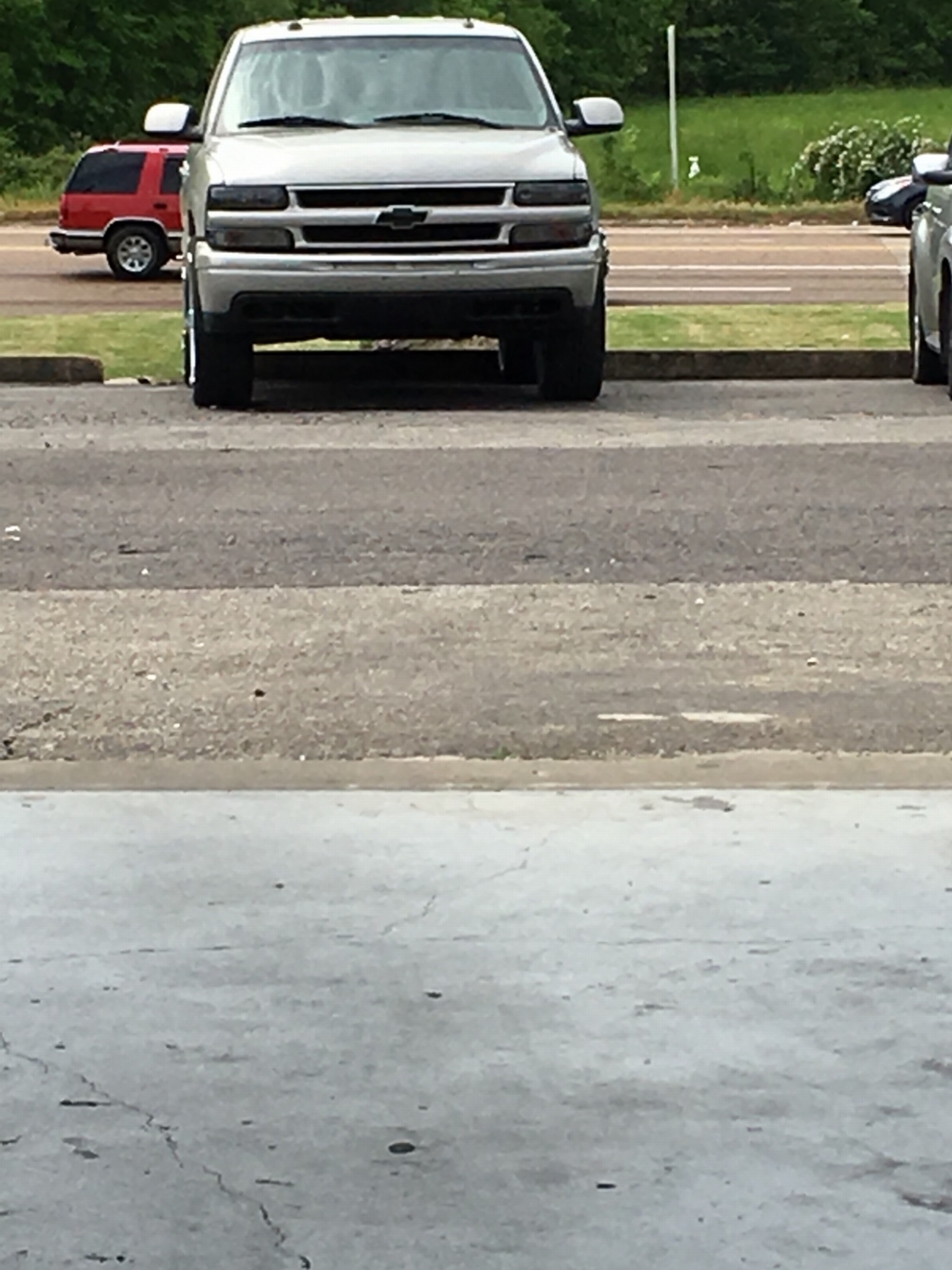

Also i just noticed the wheels looked cocked out at the top .
52,949
It sounds like you have a few things going on. You need to eliminate possibilities and I'd start with that alignment job. There's no way your steering wheel should be at 10:00. If that happened to an 08-up it would be throwing a code for the steering wheel position sensor. After it's aligned right if it still wobbles I'd try a different set of wheels if you have them. If not, try finding another shop that can check the balance and for out of round tires.

Will do ! I’ll keep y’all posted.

Not yet . I had the keys installed again this weekend and no change. Taking it to an alignment shop this weekend
I noticed that when I cranked my keys all the way up, it made my wheels look like the pic you posted. I just put 24s on and I’m getting two tires and alignment tomorrow, because it’s shaking pretty bad between 30-40 and 70+

After a lot of bs I figured out it was bad tires. Even though they were new , they were still junk.
52,949
Out of round? My 26 Venezia's started doing it after 20k miles or so and I finally found out 2 were slightly out. A shop was able to make almost all of it go away and now it's just a tiny bit at 70-75 mph. What brand were yours?

I’m hoping a couple tires and alignment will fix my issue also! Thanks for letting me know what it was before I started in on the list also....

Yeah all 4 of mine were out of round. They were Lexani lx thirty’s. They would balance out fine but at high speed had a horrible wobble.

I just got rid of those and went with a 24.
