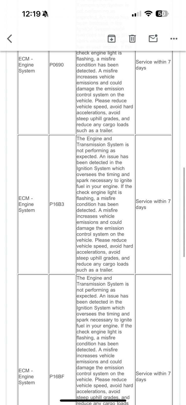

23 Yukon, 6.2. Wondering if anyone has had these codes with a check engine light. Curious what shit show I’m about to endure with the dealer……

P0690 is ECM sense circuit high. Something triggered high voltage to the ECM.
P016B3 is ECM self test Torque control monitoring fault.
P016BF is ECM ignition relay circuit 3 high voltage
my guess is
bad battery
bad ECM
or something happened electrically like a shorted wire or rodent damage to cause the high voltage faults.

IMO, these are high level codes, which by themselves are almost meaningless to anyone who is not a GM mechanic. You need to see the deep codes generated by the control units which then trigger the CEL code.
If you want to get on top of this issue and have some confidence in the opinion of whoever you choose to check this out, I recommend that you get yourself a quality bi-directional scanner to add to your tool box. Then, you will be able to read ALL trouble codes, along with a brief explanation/pointer to the source of your issue. You will also be able to reset/delete trouble codes, after taking corrective action. You will literally save thousands of dollars in diagnostic and repair costs over the life of your truck, and you will most likely recoup the cost of the scanner within 1 year.
If you do not do any wrenching yourself, then perhaps you don't need a quality bi-directional scanner, but you will be at the mercy of whoever you choose to resolve this issue.

Just curious…Where would you go about getting a bi-directional scanner and can you recommend one? Mele Kalikimaka and Hauoli Makahiki Hou!

Autel scanners appear to be a tool of choice here for later model trucks. @Doubeleive may be able to point you in the right direction for a specific model.
