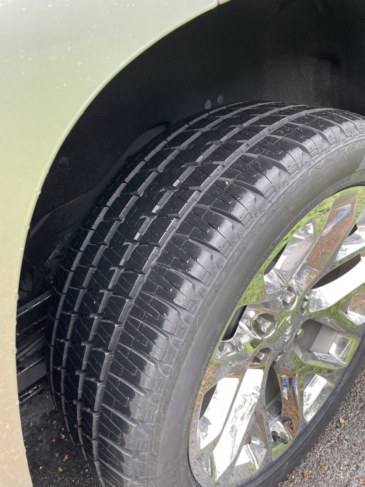

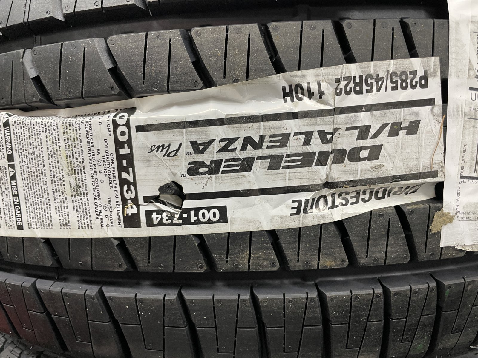

These oem tires are only a 600 treadwear version. I got 38k out of my oem tires, those are mostly long road trip miles. Like you, I've always gotten 55-60k miles no problem. I replaced mine with Bridgestone Alenza PLUS. These are supposedly the same tire, but 80k mile warranty and 800 treadwear. I'm not 100% happy with them. They are a more "rugged" looking than I prefer (tread is DEEP). That being said, they are smooth and quiet. Wet traction is fine as far as hydroplaning but the grip is less when taking off. I notice it spins easier. Dry traction is equal.
Here are a few pictures. Disregard the filthy truck

You replaced Michelins with the Dueler Alenza? I'm so sorry for your loss.
