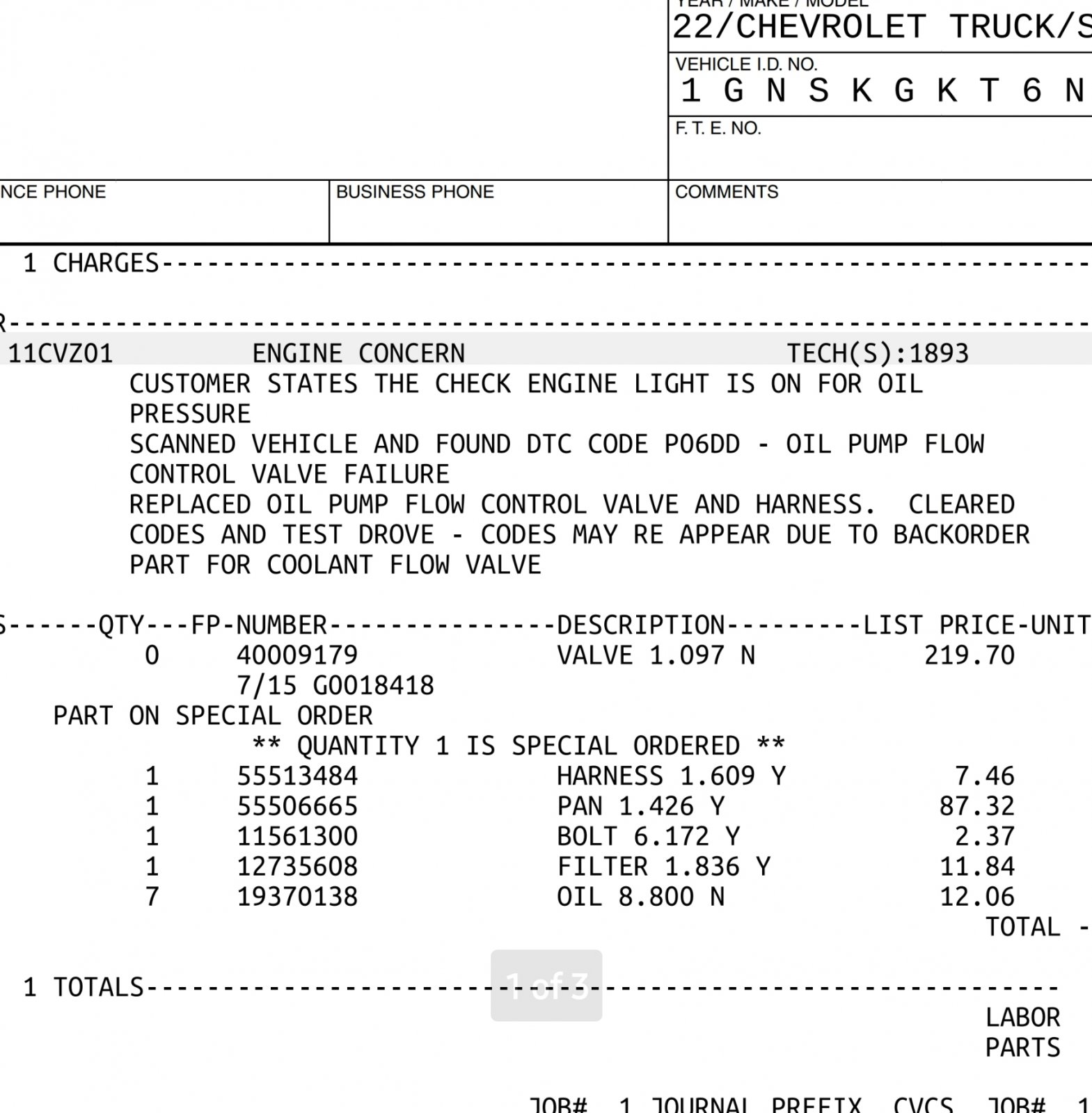

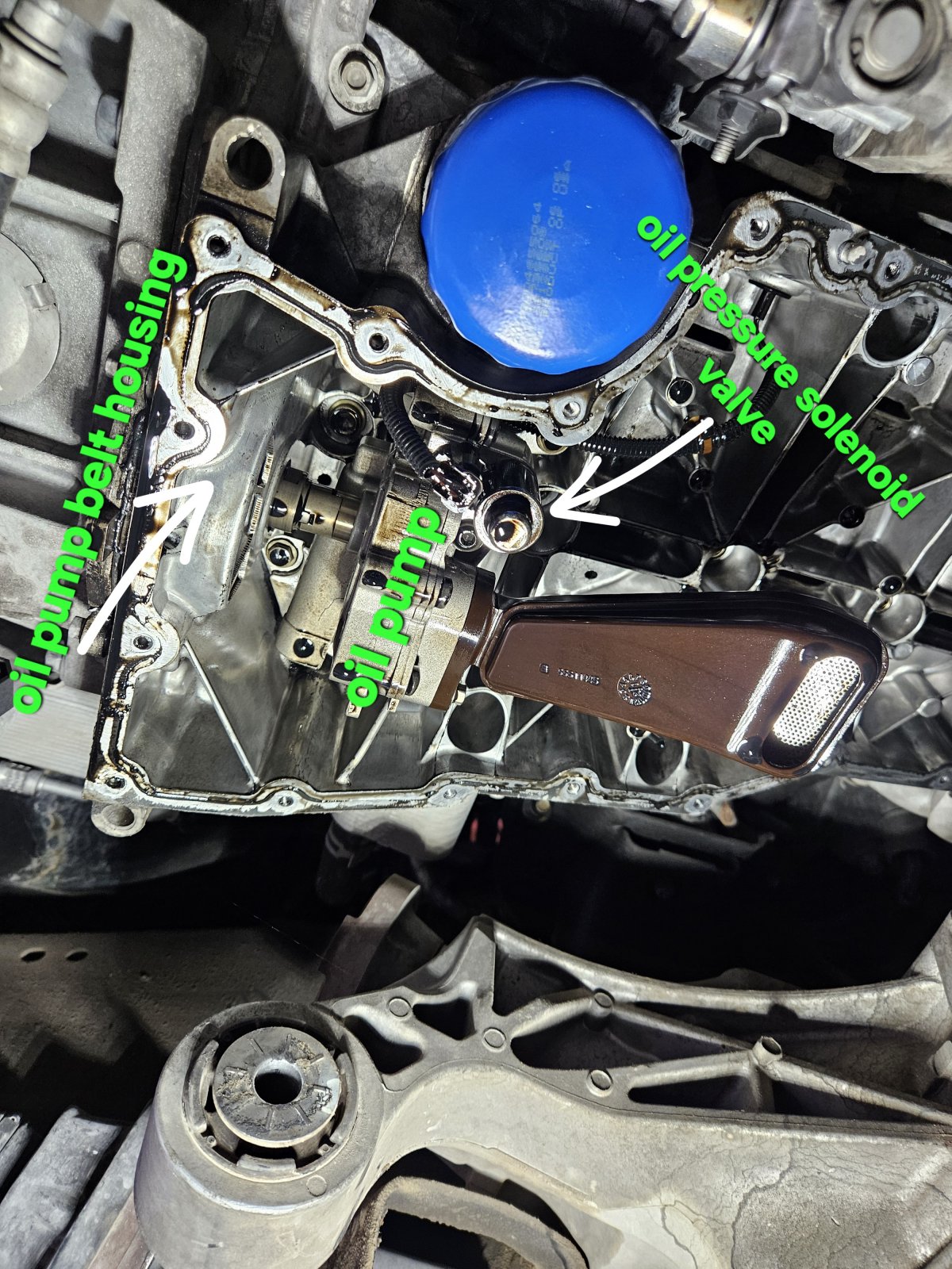

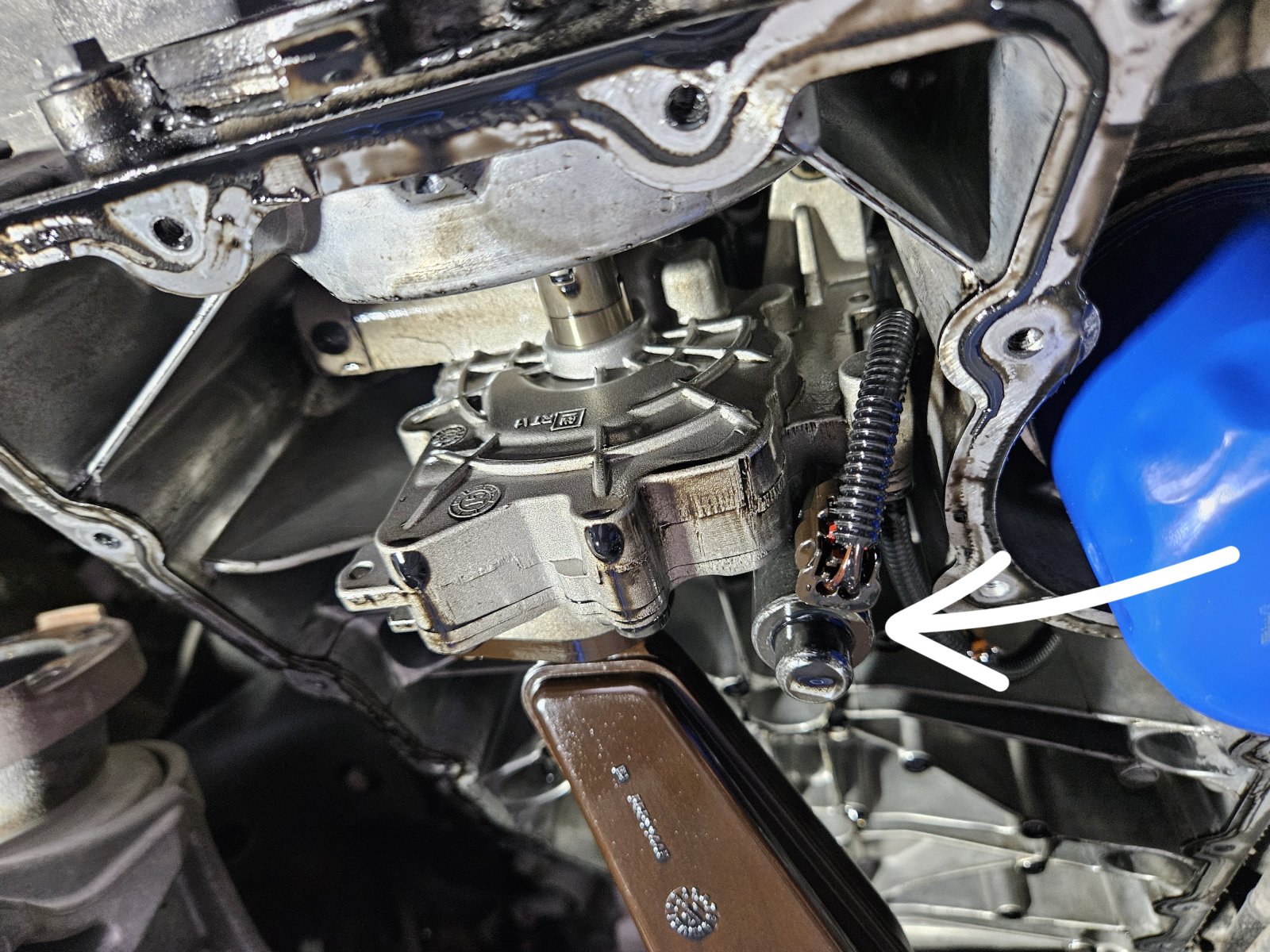

I have had the P06dd code for over 4 month. Oil pressures were fine, watched them on scan tool. Oil level was good. Everytime I would idle for a minute or 2 it would come on and had to clear the code while giving it a good dose of throttle.
Traveled over 5600miles with the issue and finally had enough of it and had a little down time.
Took to dealership on Monday and less than 3 hours they called me and said it was the oil pressure solenoid valve.. part# 40009179
They ordered it, replaced it, and ready for pick up Wednesday at lunch.
I researched this code for months and not one single forum or youtube video ever mentioned this solenoid, that I recall.
I know mine is the LM2 and yours is the LZ0, but I would highly recommend pushing this information to your dealership.
It resolved my issues. Current mileage on my 22 Burb HC is 142,069 at time of replacement.

Odd to me that the wiri g for that solenoid wasn’t better protected to be submersed in oil and heat…

Yeah appears to be quite a bit of shrapnel in there either way. Unfortunate, but I did find two other examples of very similar on the interwebs. Same code, same result.
