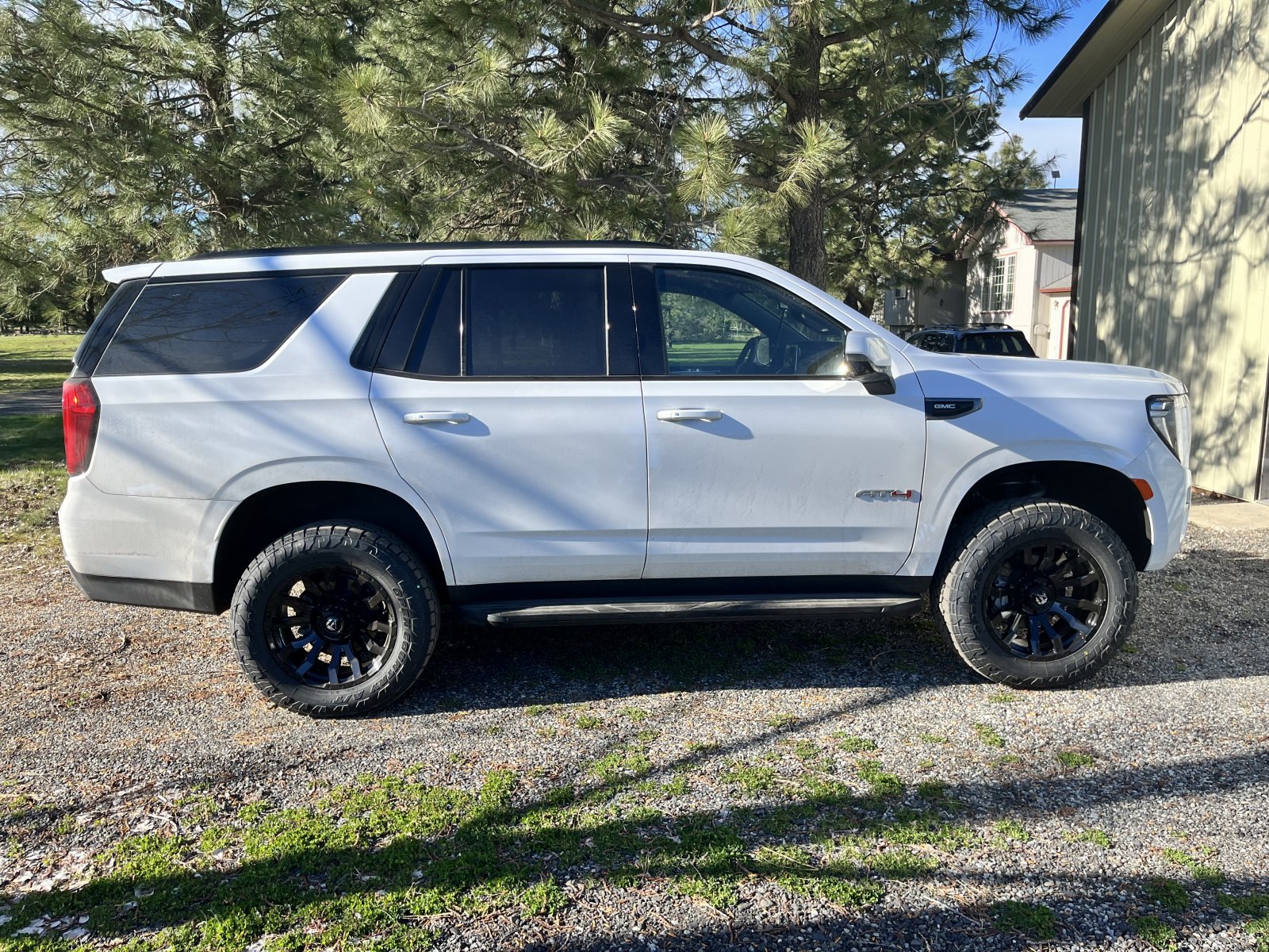

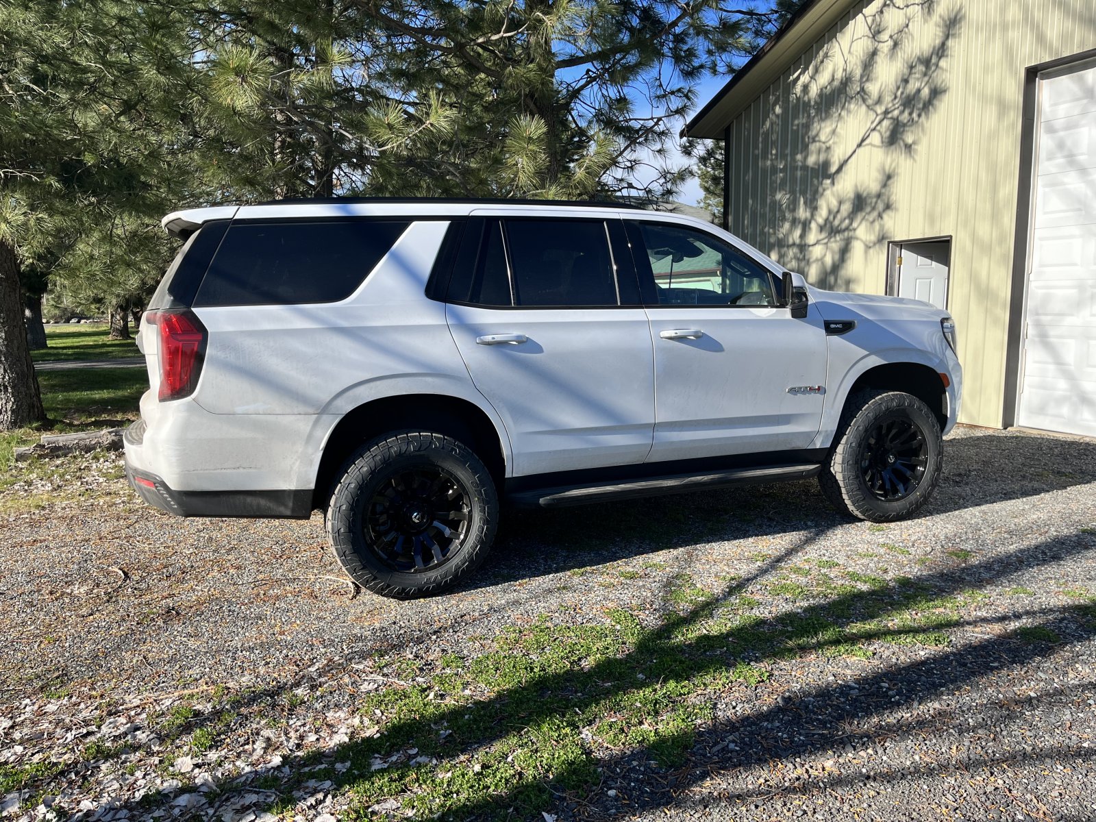

Sharing a few photos of my Yukon with original wheels/tires and aftermarket. Not great photo weather. I might add some others when the sun comes back.
- Wheels are 20x9 Fuel Blitz +1 offset
- Tires are P rated 285/60/20 Toyo Open Country AT3
It is pretty much what I was after. I will get a lift installed next. Tires rub forward and reverse as expected with the +1 offset. So far the Toyo’s are quiet and ride good. Maybe a little hum on smooth pavement at 40 to 50.
It does have OEM wheels and tires loading down the back in this picture so it's sitting a little low.

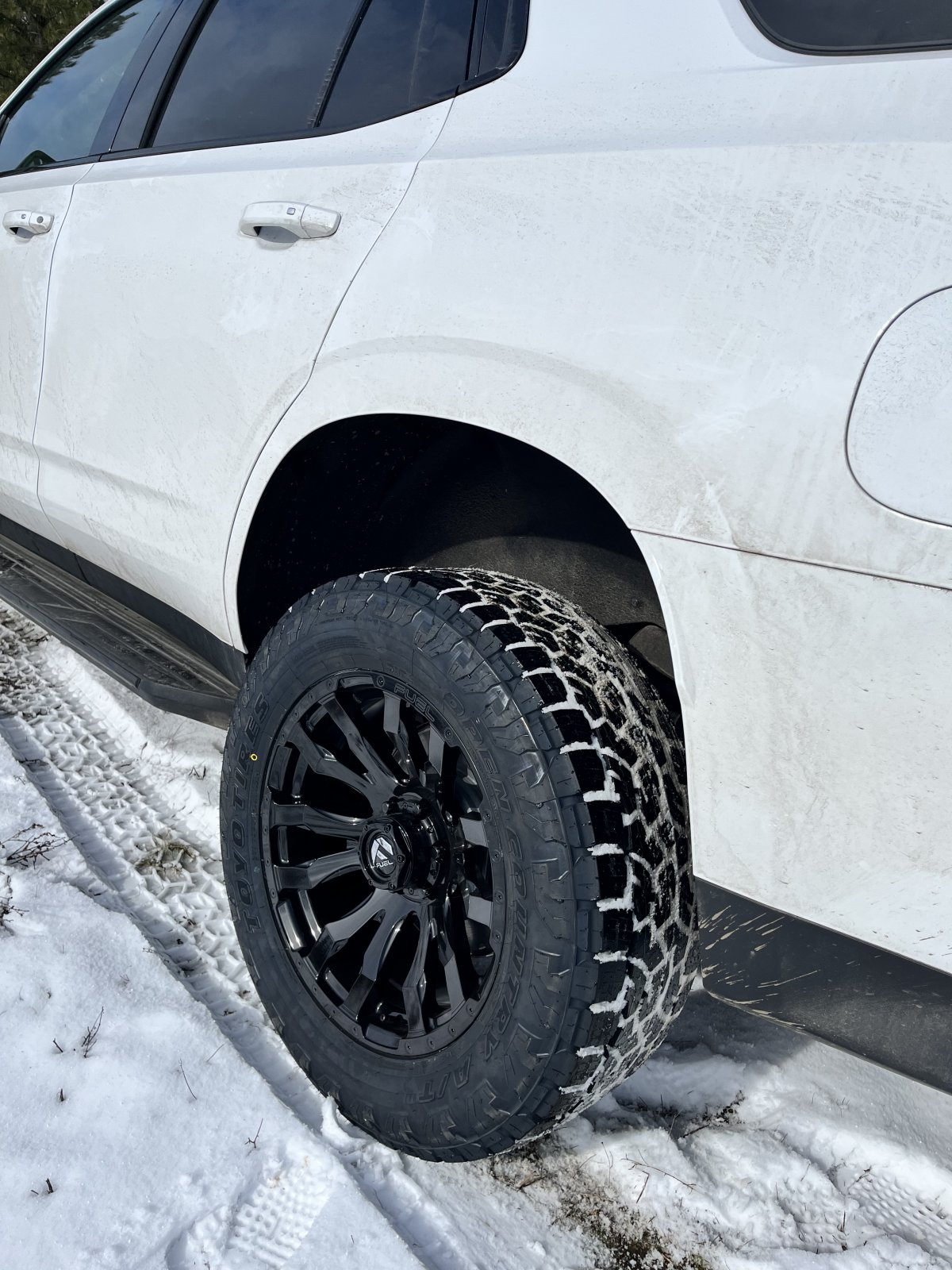

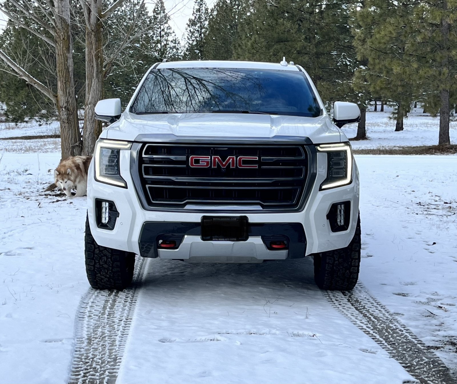

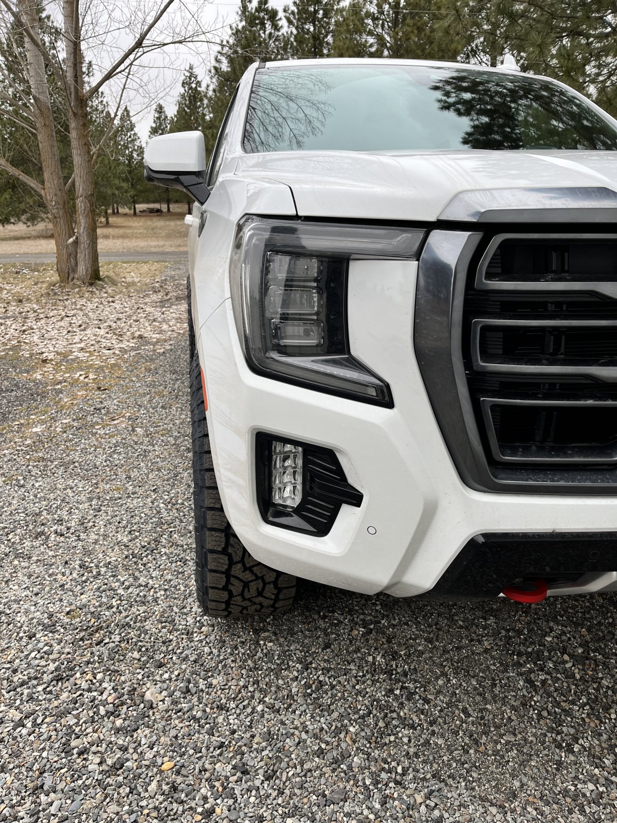

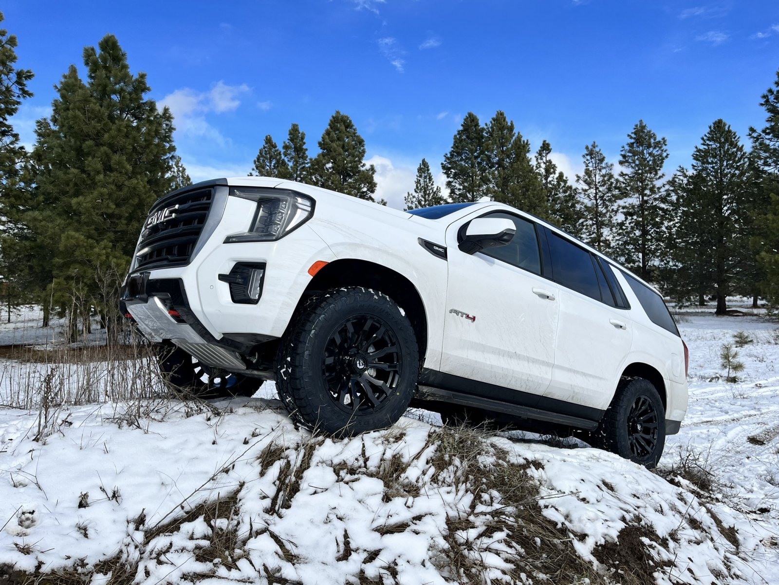

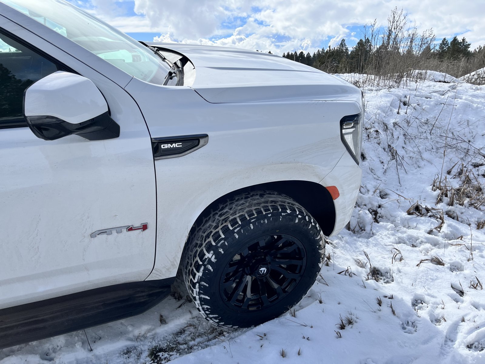

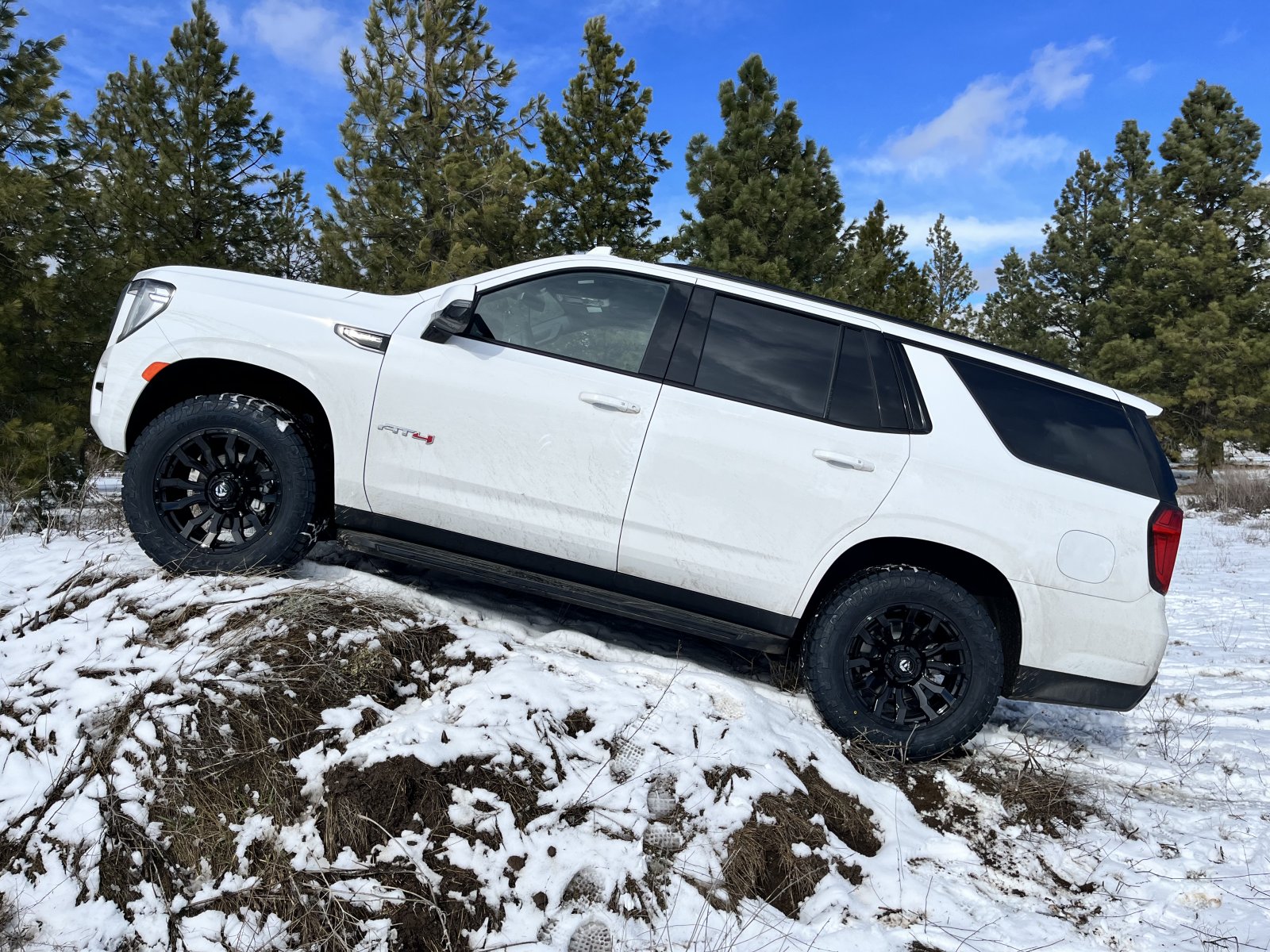

We had some snow and sun. So here are a few photos messing around.

Looks 10x better. I thought the at4s came with black wheels? Or is that just the trucks?

Thanks, @blackelky. All I know is that is the standard wheel for the Yukon AT4. It might be cool to powder coat them satin black, and add spacers.

Your truck looks SO much better now. Night and day difference. Well done!
Any plans to tint the front windows? That will complete the look 100%.

Yes, tint the front windows and I have a black and white front grill to install.

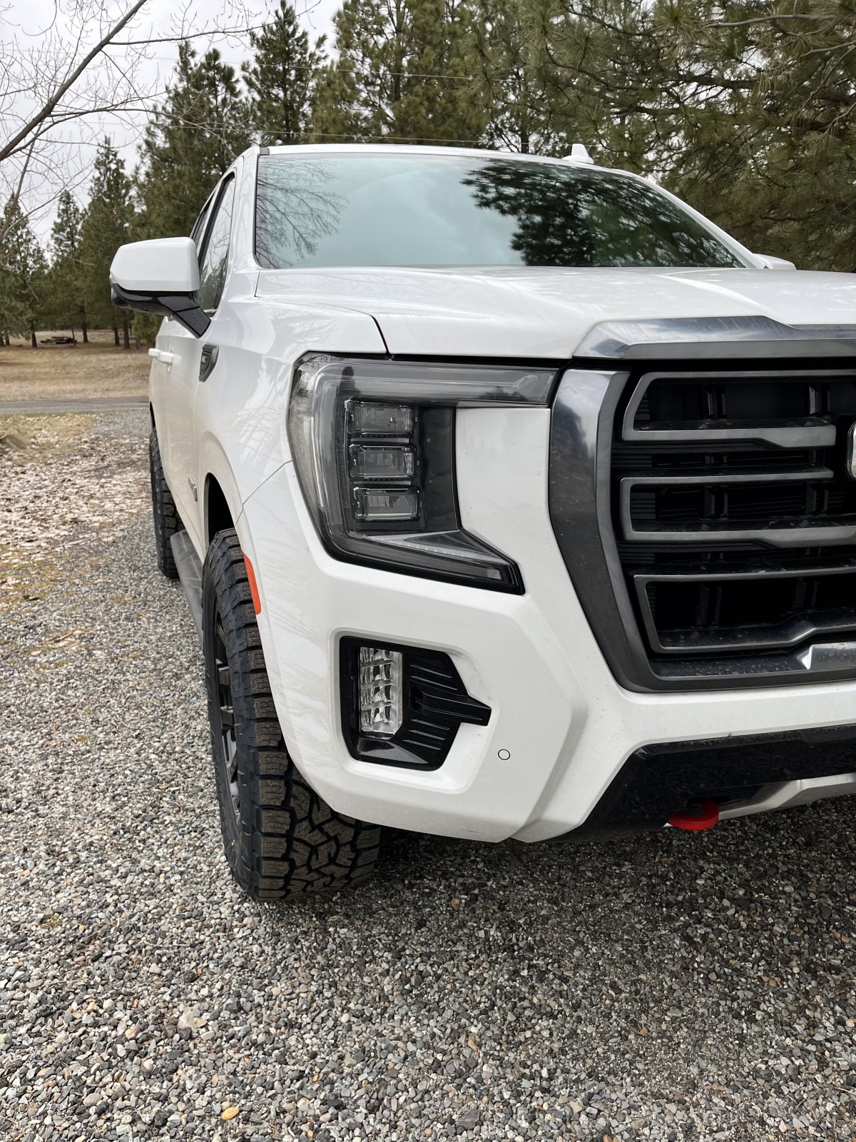

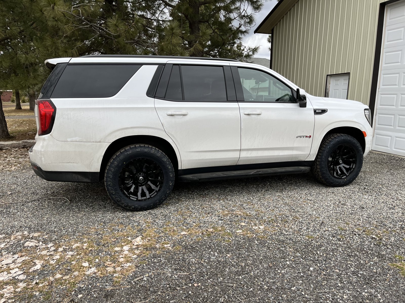

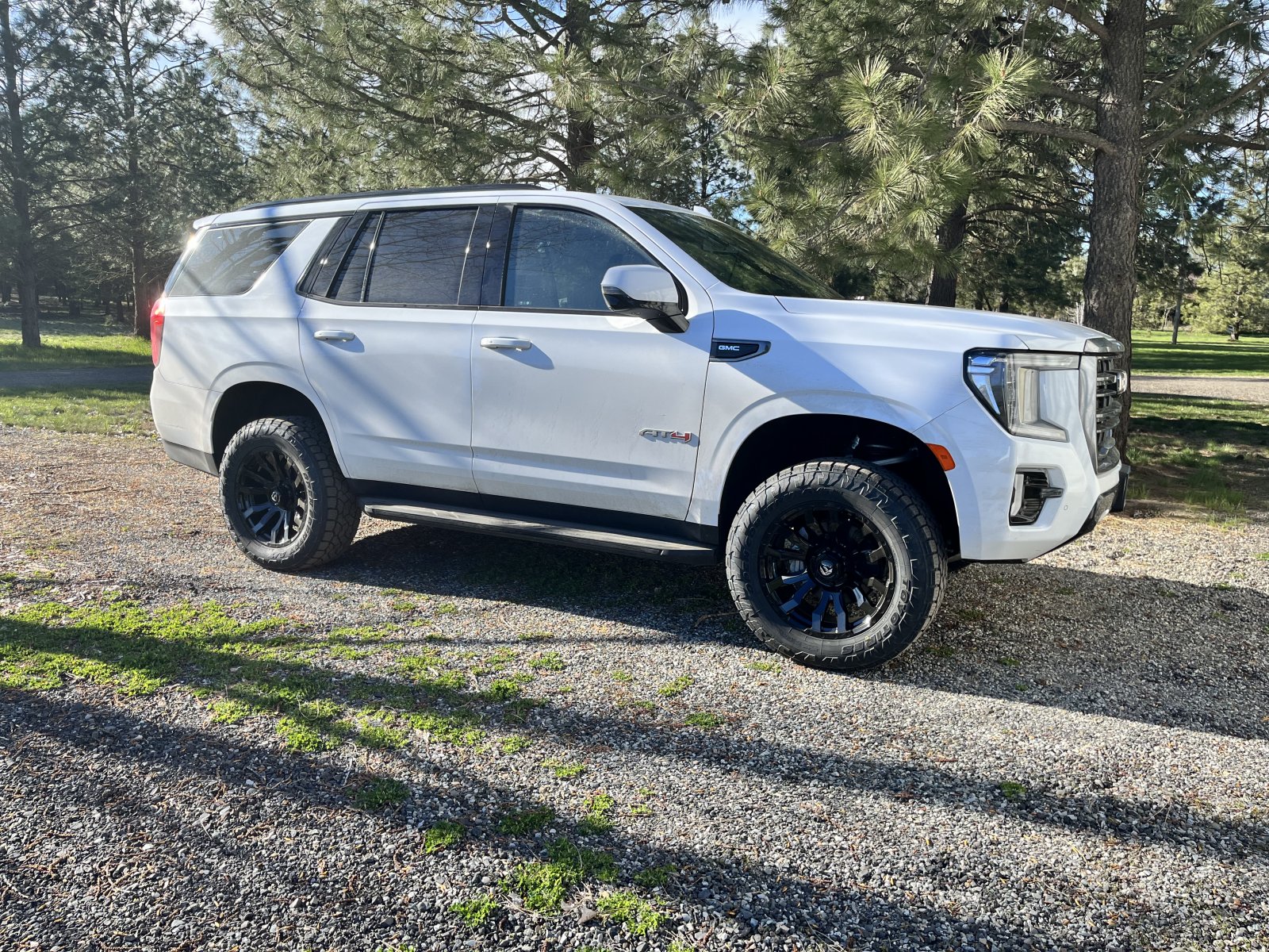

Looks even better with the 2.5” lift.

I installed it myself. Install would probably cost $400. This kit does the job, but I think the Ready lift 3" kit is better quality. I wanted a little shorter so I can fit in the garage.

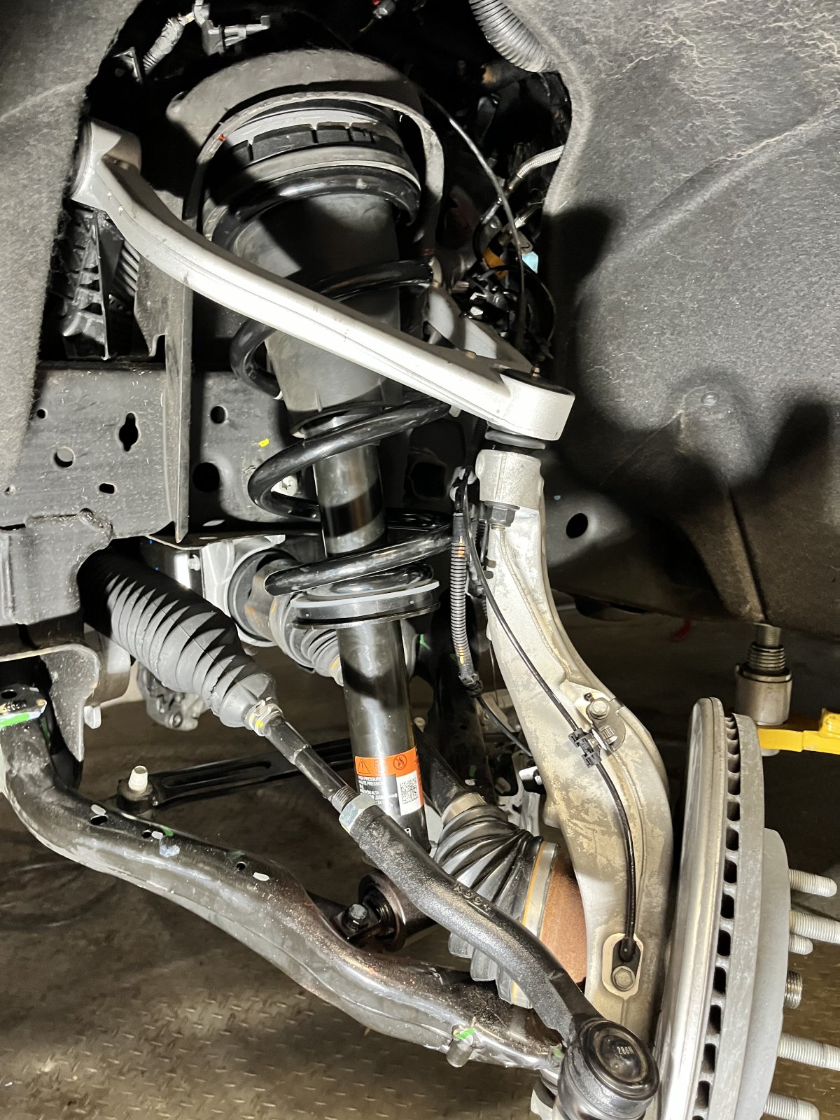

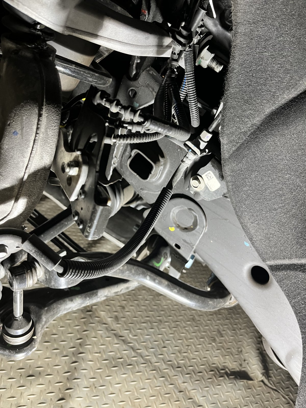

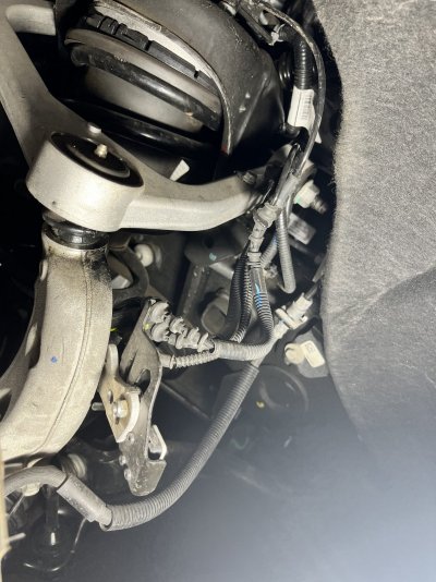

Shows why relocation brackets are needed. They only come with ready lift kits.

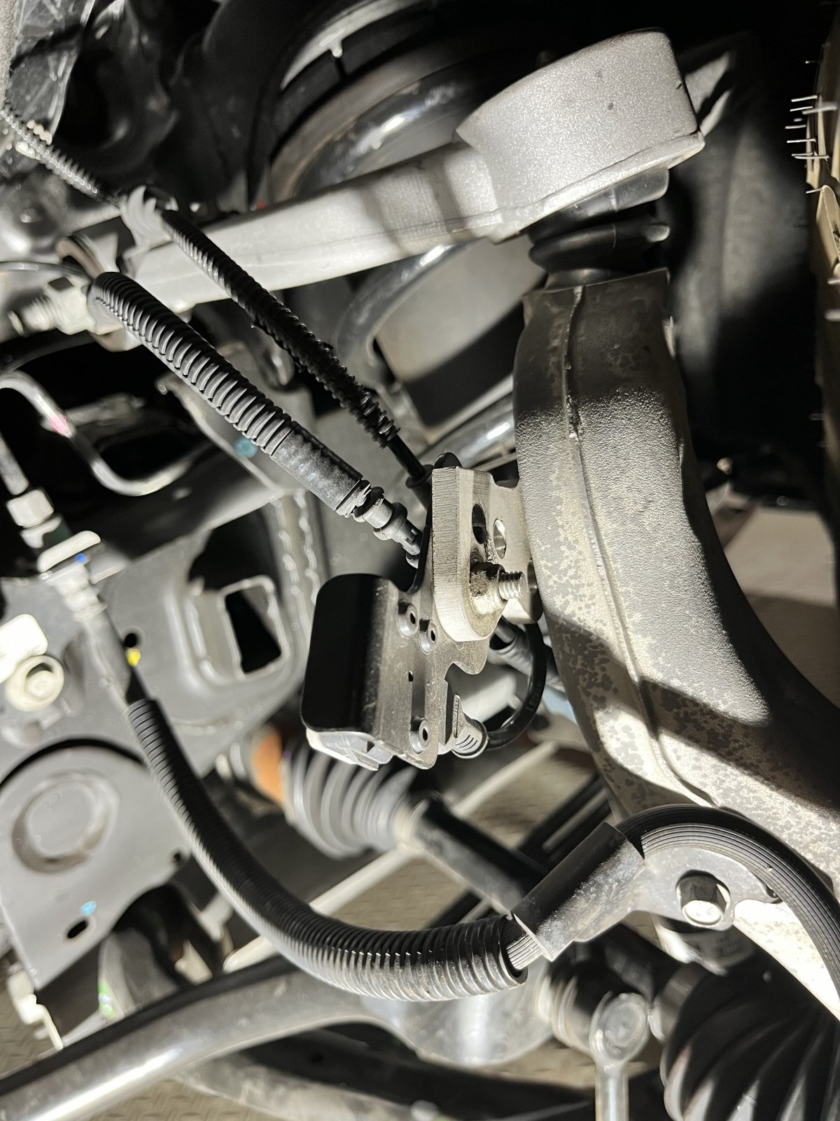

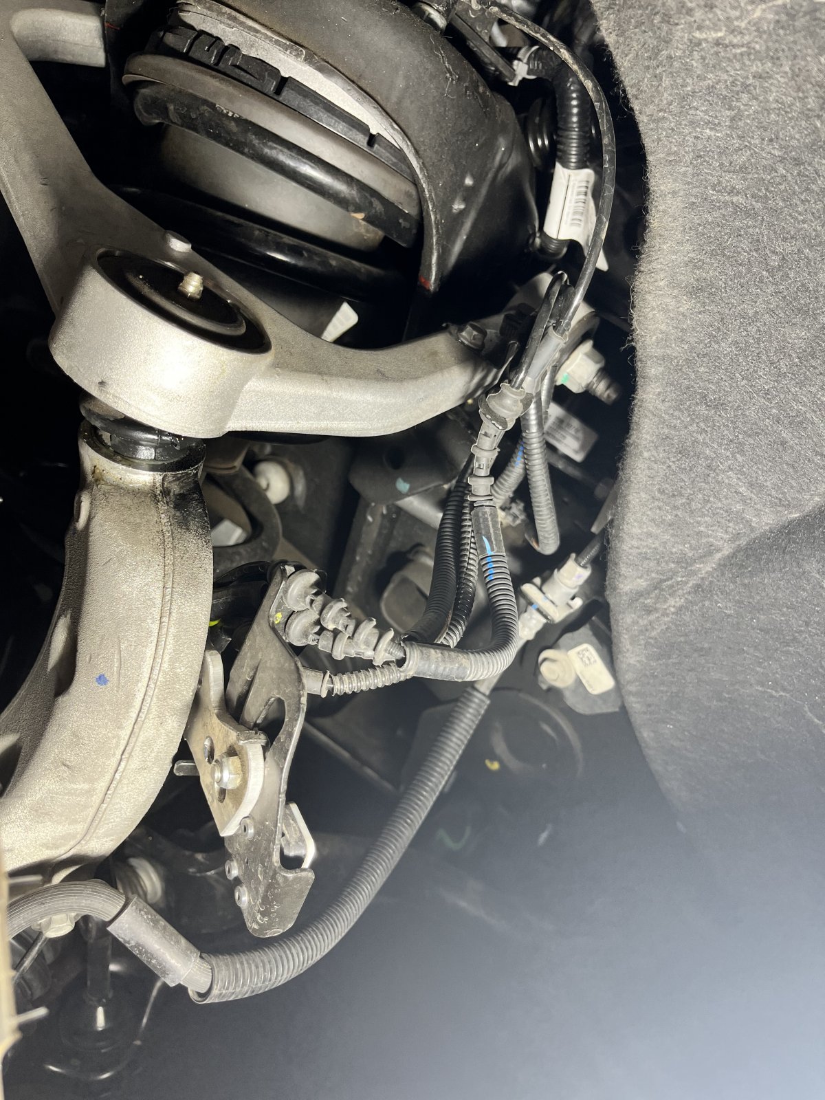

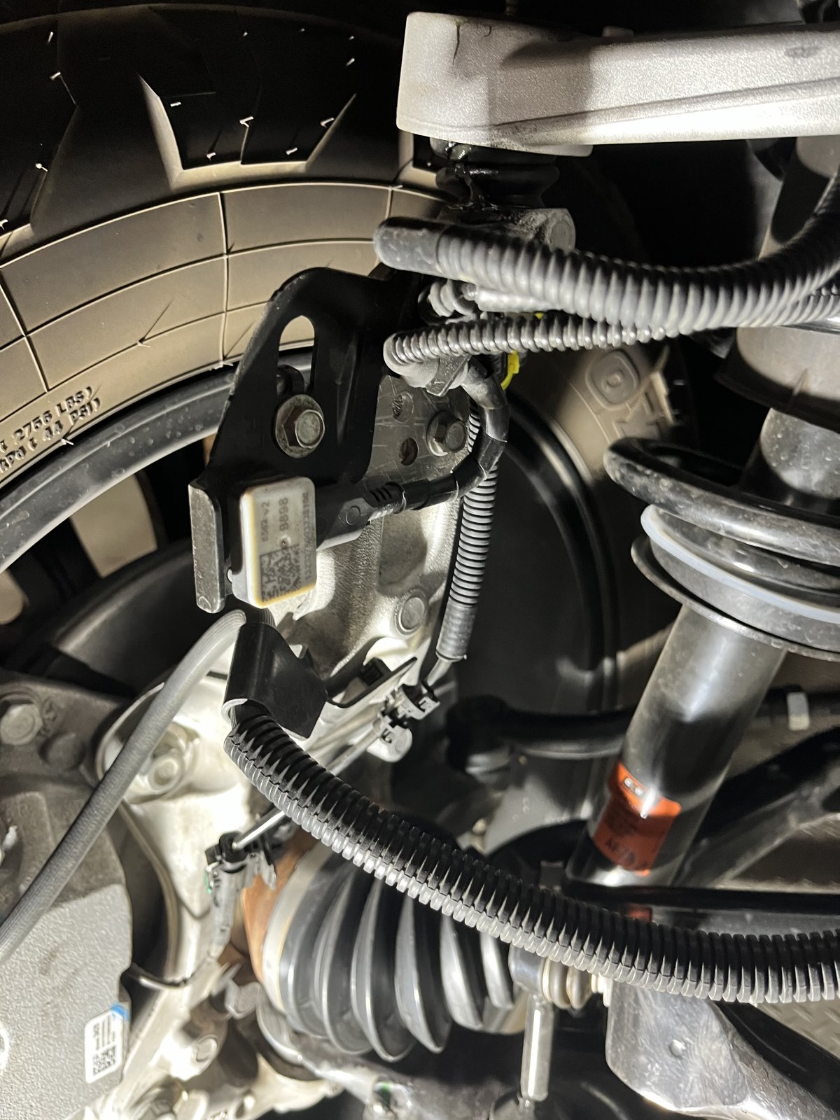

Relocate brackets made from some spare parts I had laying around. Contact only happens at full droop and full turn. So they may not be absolutely necessary.
