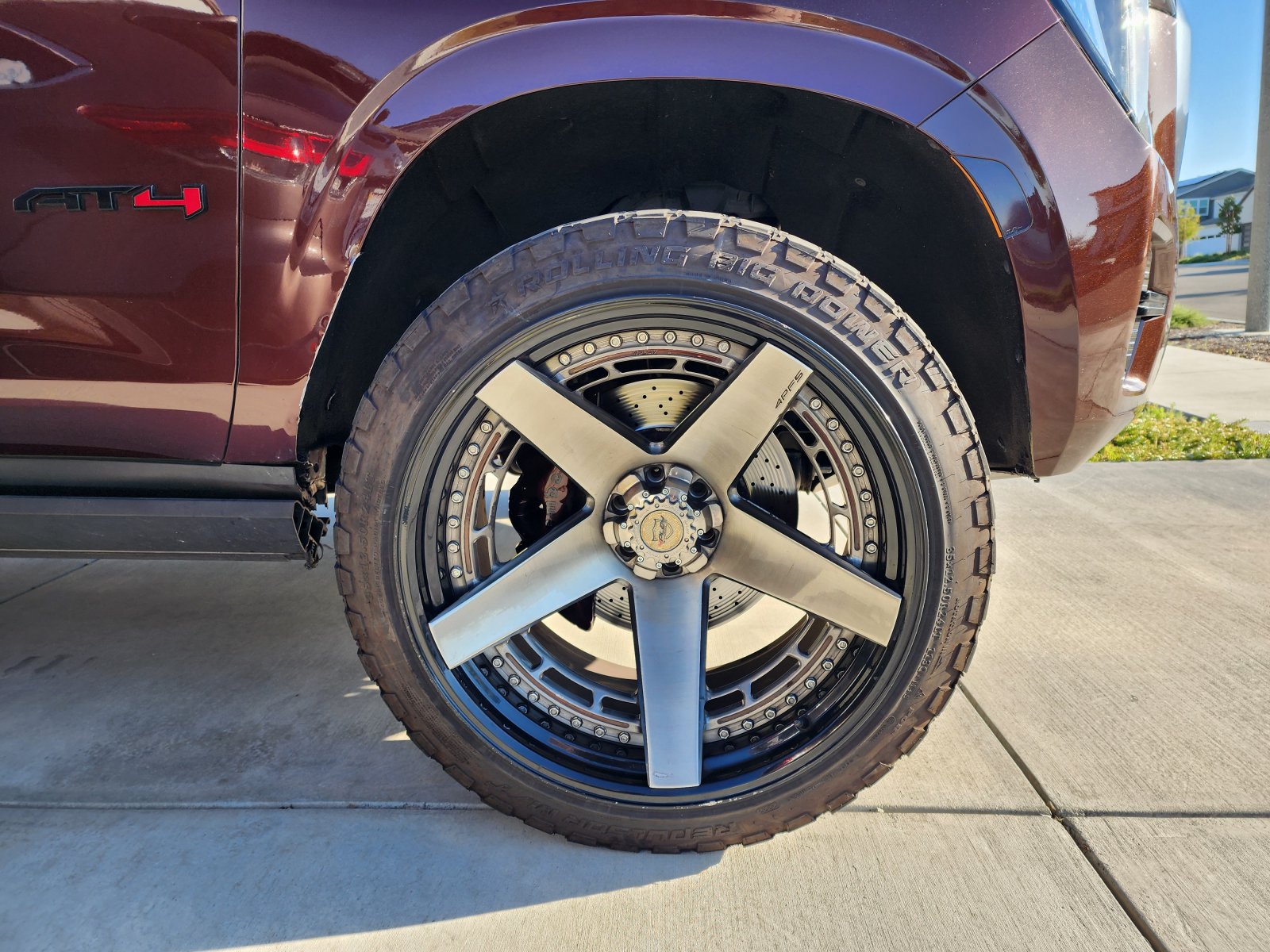

My wife and I purchased a 2024 Yukon XL AT4 in Nov, 2024. This forum was greatly helpful in deciding wheel specs to achieve the desired look we wanted. We installed AT4W 35x11.5 tires on Fuel 20x9 20mm offset wheels. This truck is an air ride model so we purchased links from www.edgymods.com. Once the tires and wheels, along with the links, were installed we had rubbing on the front and back sides of the wheel liners. The Wescott Designs liner brackets were installed which took care of the back sides of the wheel liners. The front of the liners were addressed yesterday. Here's a photo with the liner removed on our truck:
We needed to create some tire clearance but did not want to trim the liner, we want to keep it looking as factory as possible. Here's the structure roughly trimmed up:
This was cleaned up but allowed the liner to still be secured from the bottom without trimming. I don't think anyone would ever see the difference now that it's finished:
This gave us enough clearance for the tire to fully turn both directions without rubbing and allowed room for suspension travel.

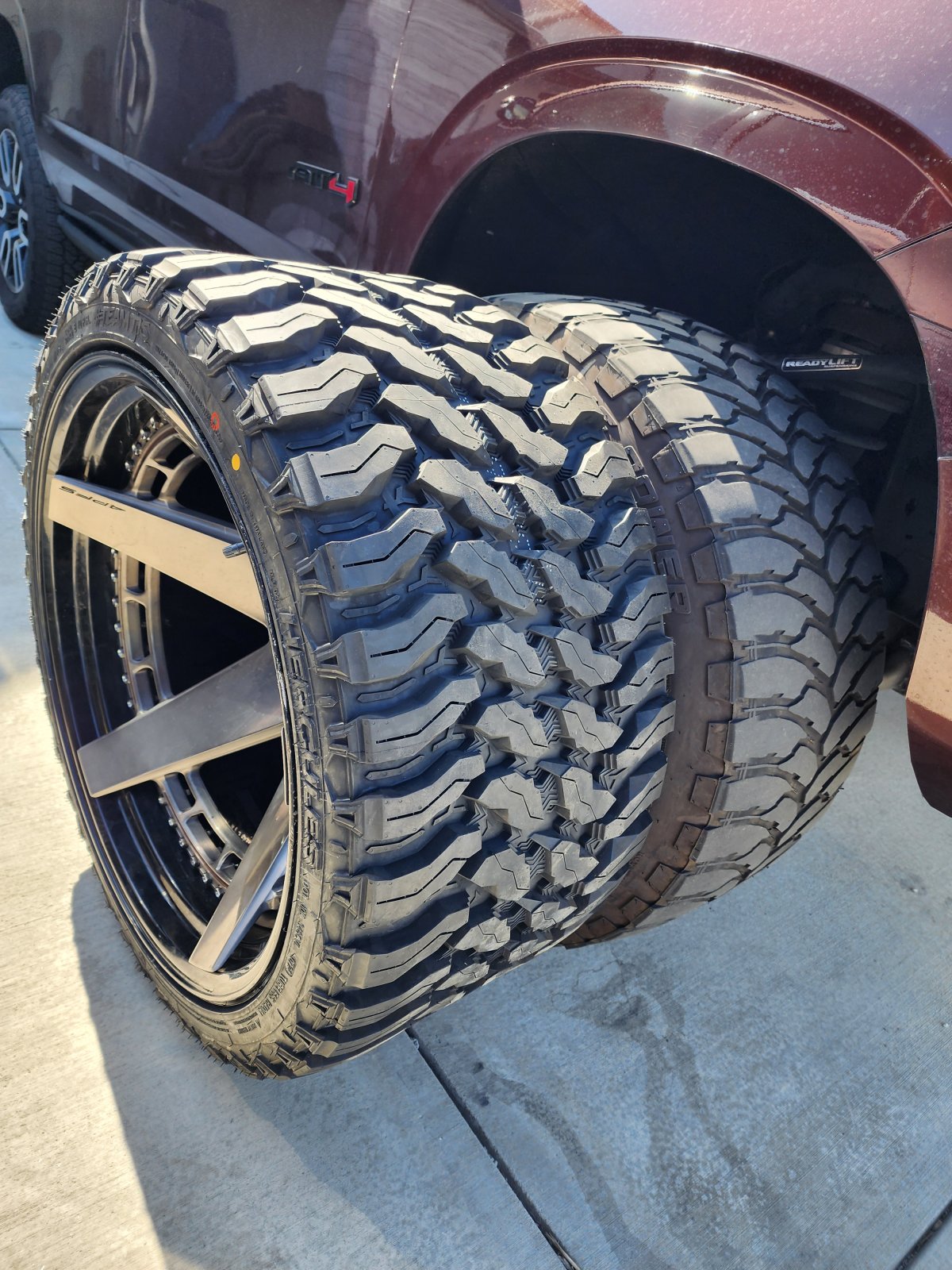

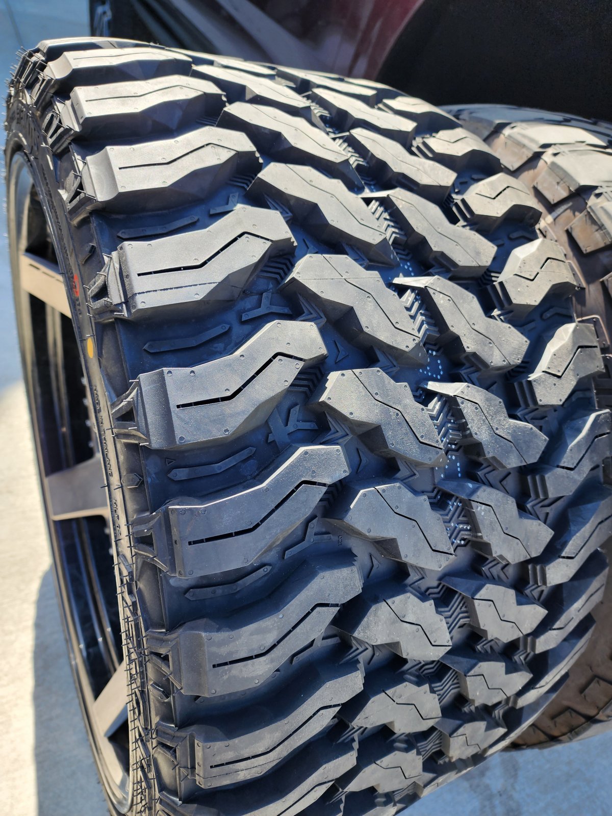

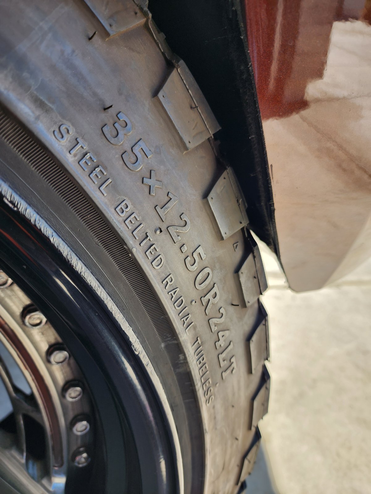

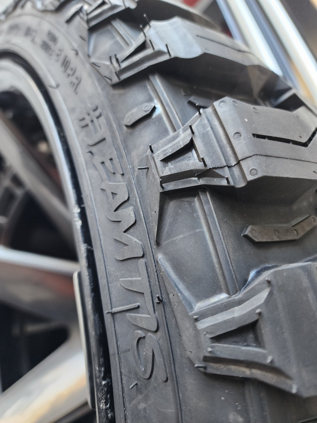

My original setup was 33x12.50 for two rounds of tires. Then my 3rd and current round is 35x12.50 and it rubs like crazy - even with a lot of trimming. I had zero issues and a full turning radius with my 33's, so I've decided to go back down. This time around, I bought 33x14.50. I don't think it's been ever done before on a Yukon, but I'm prepared to do more trimming and possibly remove some of the felt fender liner in certain areas if need be. I trimmed the front wheel wells even more after I switched to the 35's, so I might be okay. I just need to invest in a 3 ton jack so I can remove my wheels whenever the situation calls for it. This time around I decided on a different brand of tire, so I hope it's not as loud as the RBP's. I'll have them installed this weekend.

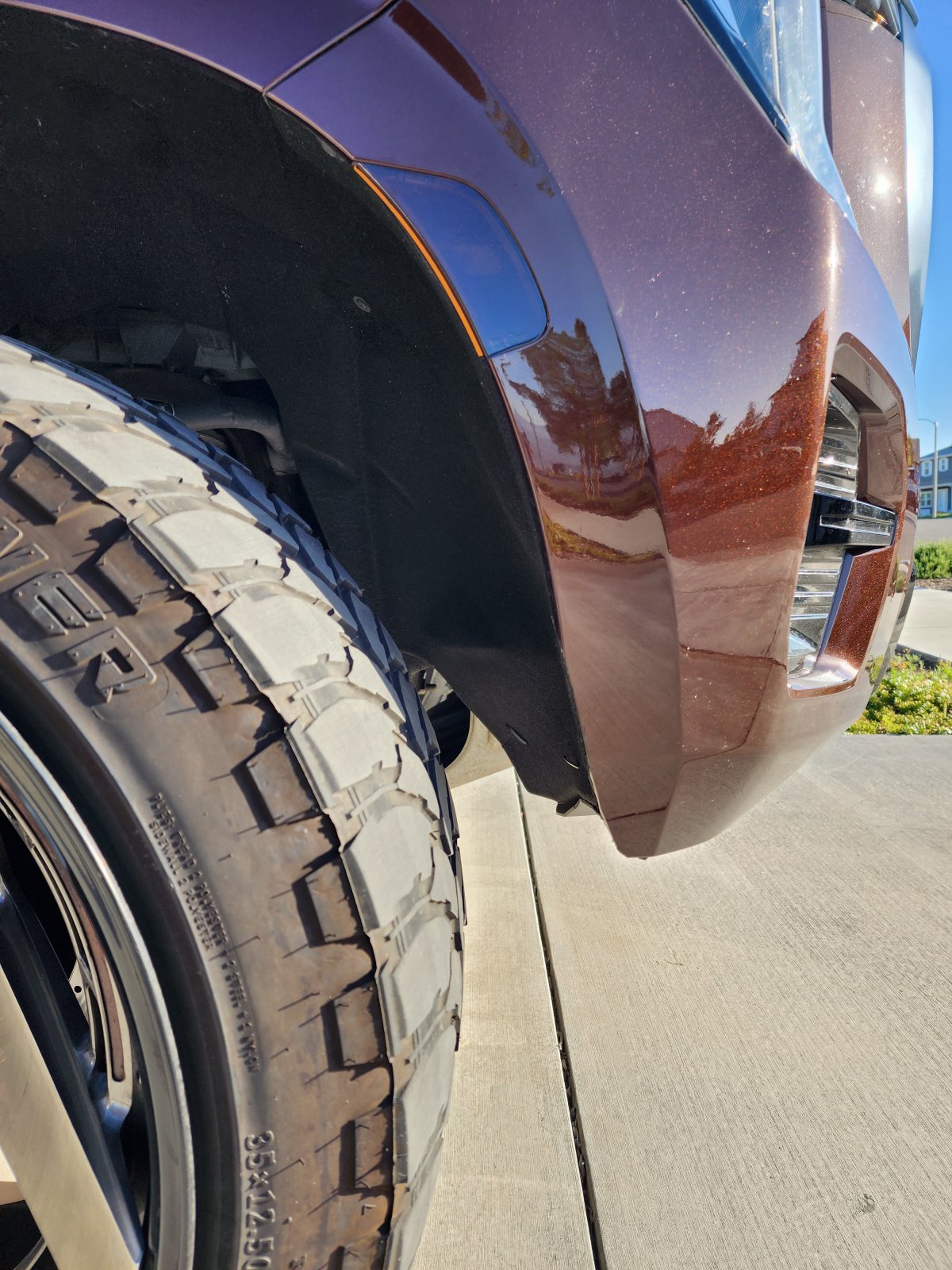

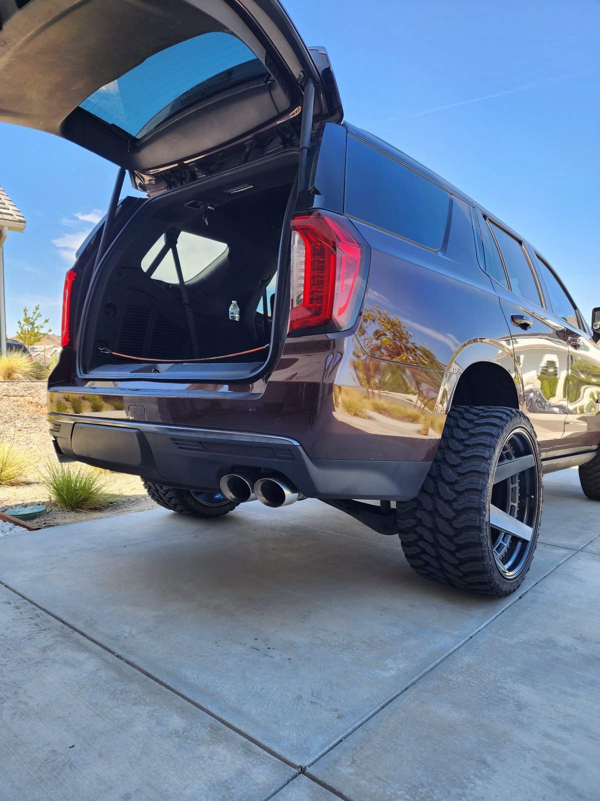

You can't get any more aggressive than this. These tires are beastly. I was afraid they'd poke too much, but then i had to remind myself that they're flush with the rim and doesn't exceed it... overall, I'm happy with the results. It's not everyone's cup of tea, but to each their own.
Tonight I decided to clean up the lower fender in front and behind the tire from when I originally trimmed the metal. I used some tape and a marker as a guide and outlined where I wanted to cut. I originally used metal scissors the first time around, but I wasn't as patient nor did I plan it out. This time around, I was thoroughly impressed with the outcome. the front was a little trickier because of the thick urethane bumper, and trying to make it look clean. The Dremmel helped with the metal behind the tire, but it was a little difficult to cut with the wheel in the way. Now, the cuts look more natural and contour to the shape of the wheel well.

Subtle, but effective. All i need to do now is sand it down and paint the edges.... and do the other side.
