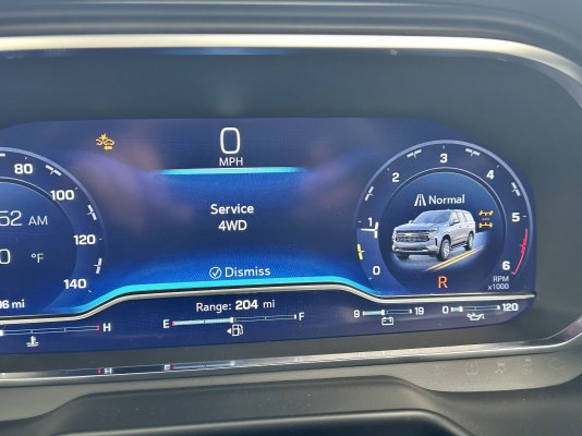

Brand new 2024 RST Duramax on initial startup when cold (like 3°, which is cold where we are at) i get a “service 4WD” message and cannot select any mode for the 4WD. After driving or letting it warm up completely shutting it off, letting the system reset then starting it back up the fault goes away. Less that 1,000 miles on it, I’m going to take it to the dealer just wanting to be prepared for dealer BS on why there’s nothing wrong. Oh and it causes the forward collision avoidance to be inop.

By chance when it's warmed up and everything is working, are you turning it off with it in 4WD or Auto? Try turning it off in 2WD and see what happens. If you Google "Silverado/Sierra Service 4WD message" this is non an uncommon problem and goes back through previous generations. It does sound like cold is often a factor and the bit I read about was position sensors being stuck or not able to properly read where the transfer case is at, so the message pops up.

doesn’t matter what mode it’s in 2WD or Auto it will fail when cold. I never leave it parked in 4WD as I’m not off road and there’s no need to even select anything other than 2WD/Auto.
