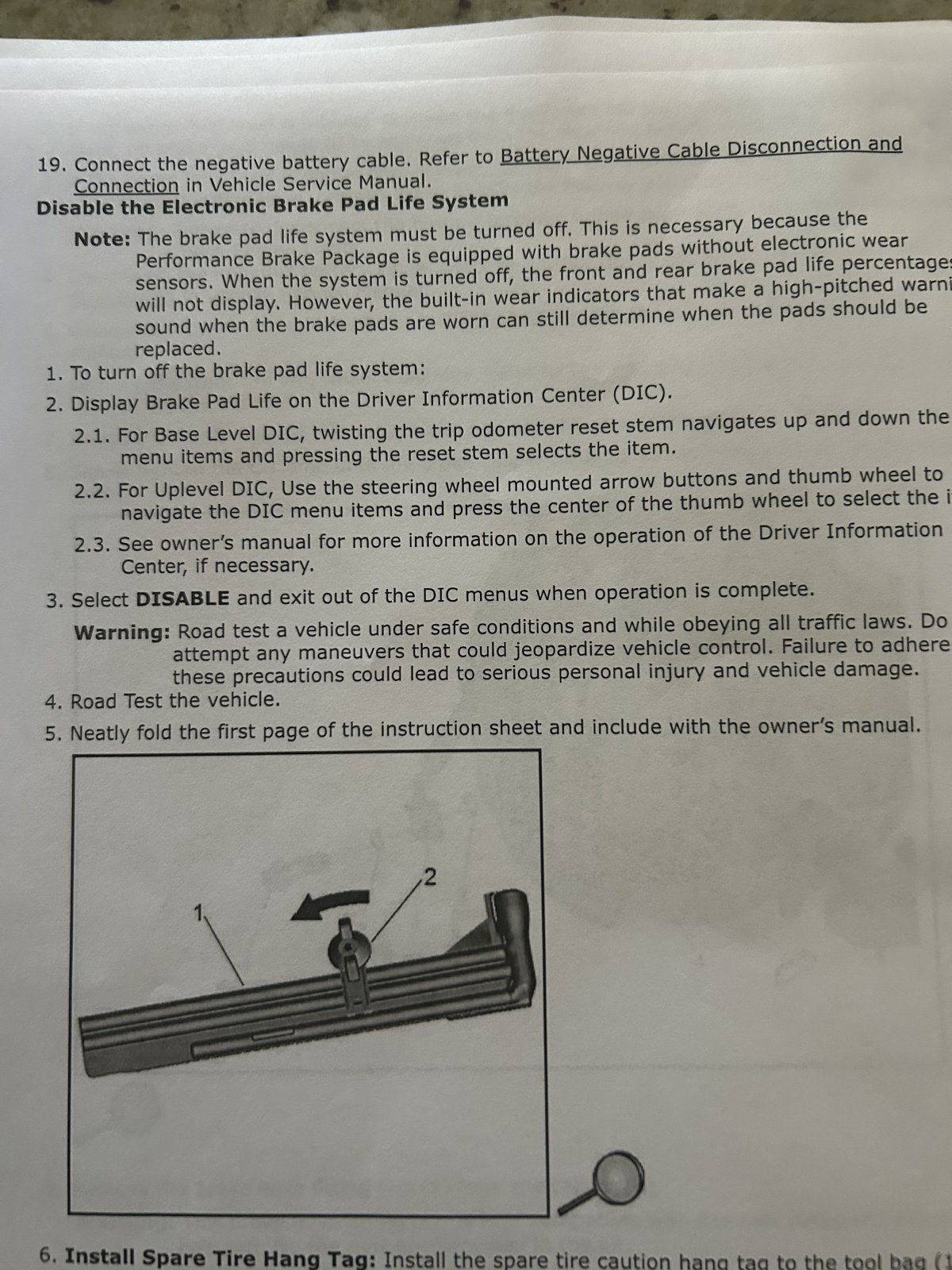

Be advised that GM offers 2 front performance brake kits - the part numbers are different and 95% of the kit is identical but one is $400 cheaper than the other. Plus there are some key differences.
For some reason they are not compatible with all years and models.
The GM site says the cheaper part number does not fit my 2024 Tahoe HC.
The 15 page installation instructions for both are identical except for page 14. One is plug and play for brake life wear and it will display on the DIC.
The other does not come with brake life sensor and the wear indicator must be disabled.
Did you get the correct part number for your 2023?
Page 13-15 describes how to reset or disable the wear sensor.
Unfortunately the website only shows the same instructions for both but a GM parts department is able to get you the correct installation instructions if you didn’t get it with the package or lost the original paperwork.

Think this is what you need for your 2023
