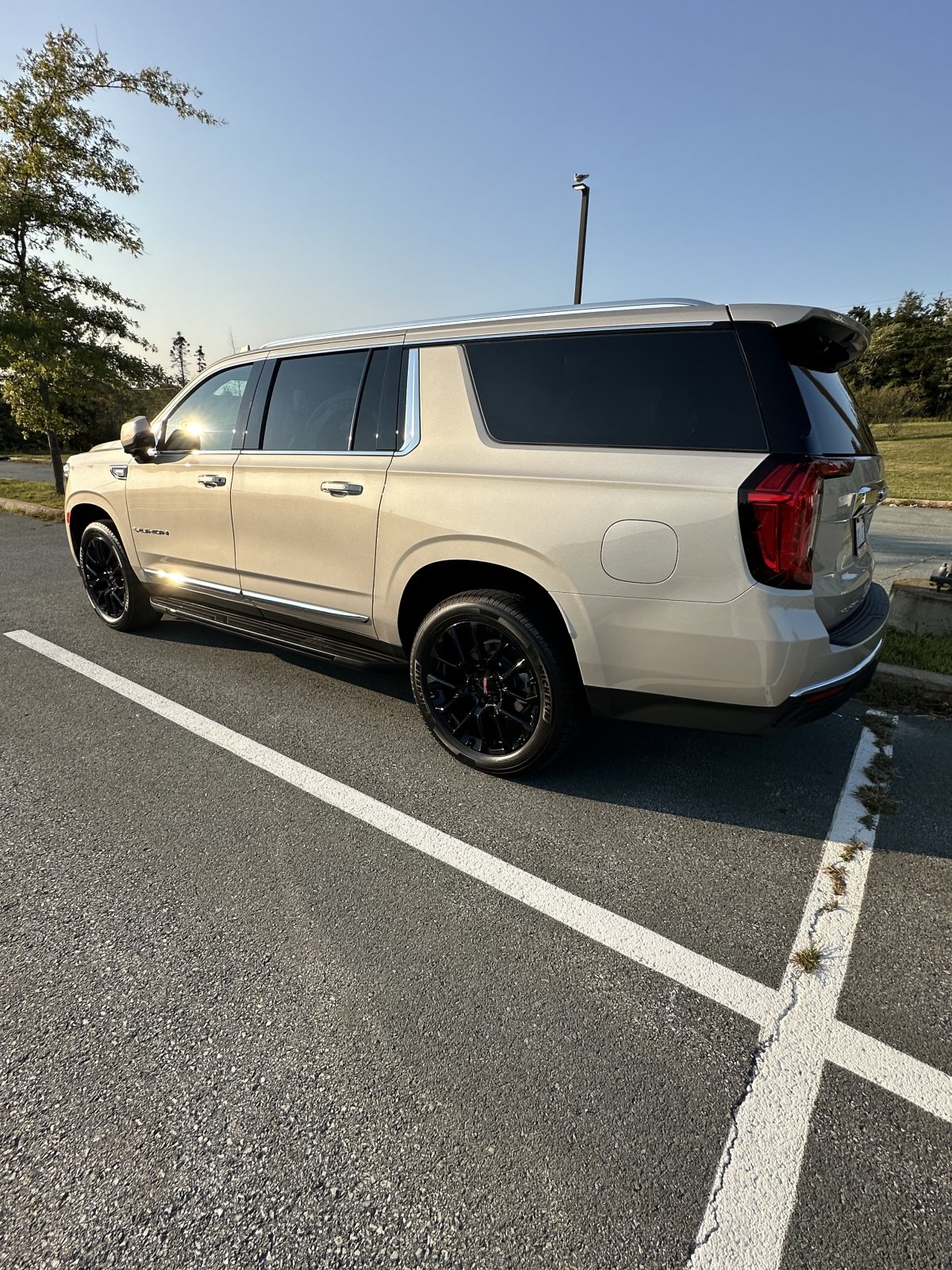

I just took delivery of a 2024 Yukon Denali about 2 weeks ago. Now, I came out of a Bronco so road noise was a given. That said, I want to make sure I'm not crazy. I feel like for the money (despite it being a full size body on frame brick) that there is too much road noise. I have fixed running boards and i feel like the majority of the noise is coming from the lower section of the truck. It could also be the Bridgestone tires.
I have had a multitude of GM trucks and i feel like they were all quieter. Gaps look good, weather strips are good. I am also unfairly comparing it to my wife's GLE which is an egg but it is dead quiet inside.
Dealer says "its normal. these aren't really quiet trucks."
I love it otherwise. So tell me I'm crazy and it's normal. PFA
Thanks!

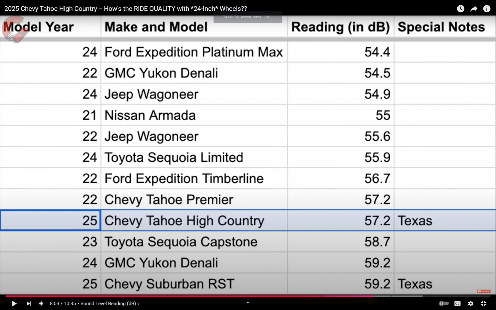

I would download an app on your phone that measure decibles. I was just watching a video on the 2025 High Country and they were getting 57 decibles on the new 24 inch wheels at 55 MPH.
It would be interesting to see what you are getting.
If it is a lot higher, at least you can tell the dealership that you have a data point and your vehicle is a lot higher.
It is easy for the dealership to blow you off if it is based on your feelings, but if yours is off the chart compared to 57 decibles at 55 MPH, at least you can give them that data point.
It would also be interesting to see what other people are seeing with different tire combinations.
BTW, I love that color combination. That really looks awesome.
Below is a chart of different SUV's. I got this from the youtube channel "Car Confections". They have a website that they post this information to.
58 dB. That said its definitely the tires. I rode in my friends high country with the 22's and he did Michelins. Different truck.
