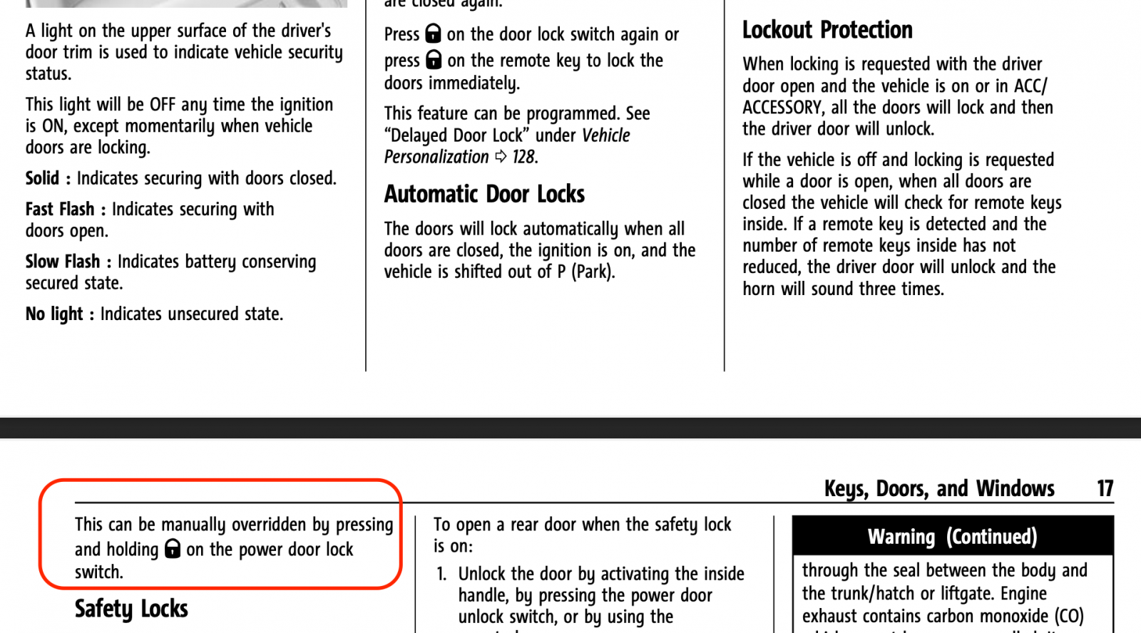

So, the doors automatically lock when all the doors are closed, then engine is running, and the vehicle is shifted out of park.
You can hit the lock button on the door panel if you want to lock before the auto lock. Check "Door Locks" section of your owners manual...probably about page 16.
Manual says "automatic door locking cannot be disabled. Automatic door unlocking can be programmed. See Vehicle Personalization"
The personalization settings are on page 101 I think. Net is you can set the unlock to be Off, Driver Door, or All Doors.

Check Page 16, and into Page 17...under lockout protection; Suggest holding down the lock switch on the inside door panel, next to the door release handle...or possibly on the fob, not sure...screen shot below.
