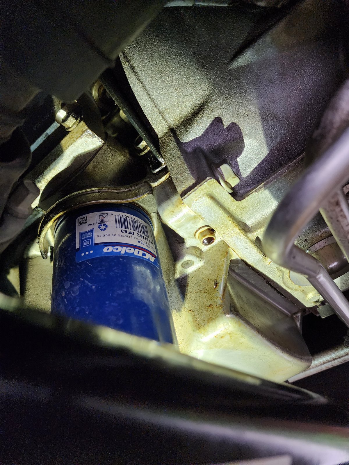

So I'm new to the page and need some help with someone explaining the difficulty level of fixing this leak... it seems to be coming from whatever doo hicky is above the oil filter. Which is coming down and it looks like it's the bolt in the center of the picture... I can't figure out whether it's an easy fix or not.. I don't want to say it's coming from the main seal.. but I do want to tighten the bolts to see if that will keep it from leaking... or is the a job for the dealership?

I can't tell anything from that photo - but your truck is a '22 and still under warranty. If it's leaving oil spots underneath it, that's a warranty issue. Take it to the dealer.

It is under warranty and therefore, DO NOT TOUCH IT. If they see you have, they can blame you and try to charge you. It says in the owner's manual, Take to Dealer with ANY warranty problems.

Welp, it's good to know that the LT engines haven't solved that leaking problem at the oil cooler plate above the filter that plagued the LS engines too.
I agree with the others here. Let the dealer fix that. Those are small bolts threaded into aluminum. If you get down there with a wrench and go all gorilla on them, you'll strip the threads and have a real problem on your hands. Ask me how I know. :p
