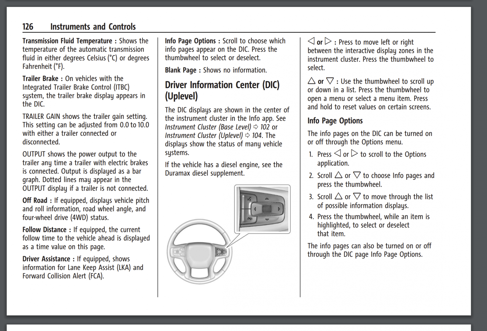

Searched online, within the owners manual and messed around with all the gauges - no luck in finding the coolant temperature (as in the actual temp)
Owner's manual says there are two possible instrument clusters, "base level" and "up level"...up level apparently refers to the new cluster, which we have, and the coolant temp should be an option.

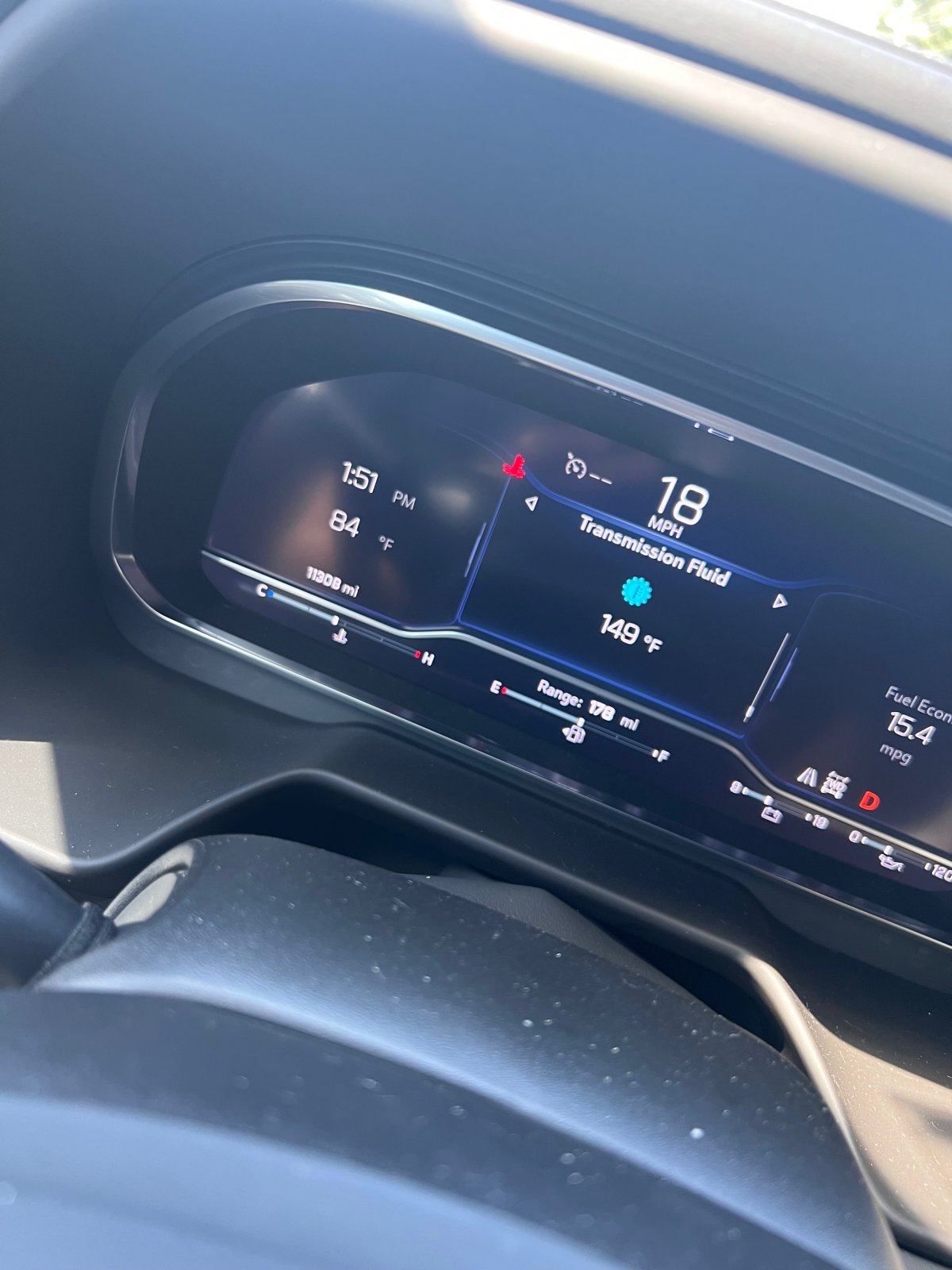

Our last option in the cluster is transmission fluid temp (which is where the base level cuts off) when we go in to select the different pages.
Anybody able to see their actual coolant temp?

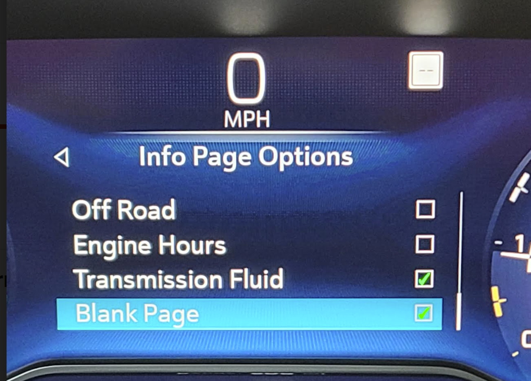

it should be in the dic just like it says in the manual, you have to go in as described in the upper page and select it (using the arrow buttons/thumbwheel), then back out and scroll thru up/down to see it.
i'll ask the dealer and see what they can find out...menu options stops at transmission fluid...which is what is under the "base level" dic. maybe they have different levels of the new cluster. sign of times, $65k rig and can't tell what the coolant temp, oil temp or oil pressure actual is outside of a bar graph.

I have the digital driver display system, which I assume is what the up level is referring to--the dash style. You either have the digital or the analog(?) meters. In the digital system, I had to go into the display settings where you select what shows on which side and I've got it set to show on the bottom left.

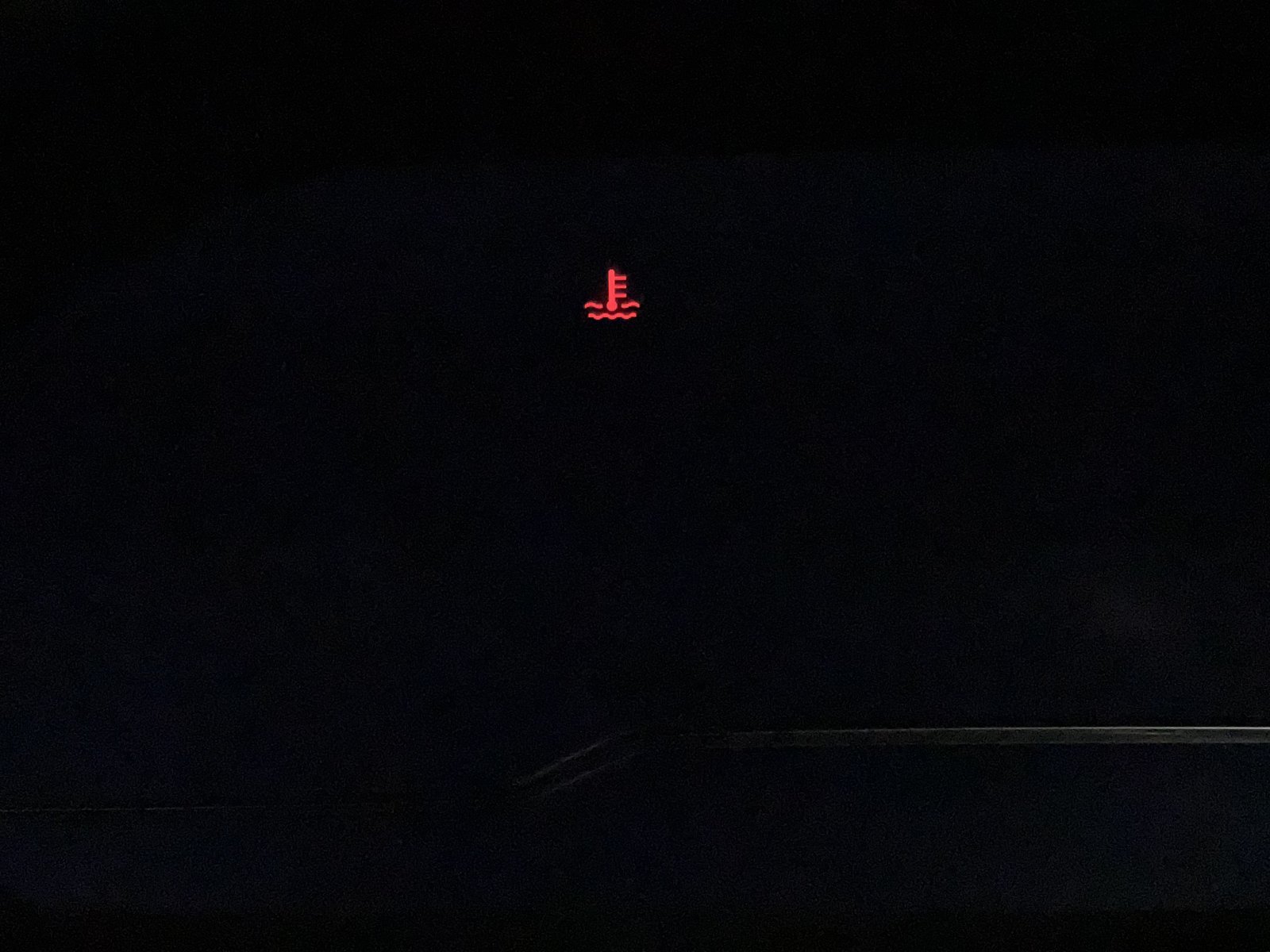

BUT why I'm here, the digital icon for the overheating light came on for me BUT my temperature was reading as just below middle-normal on the digital display. I pushed my blue OnStar button and they weren't able to find any diagnostic indicators from it, as I wasn't sure if that icon could indicate more than one thing.

BUT why I'm here, the digital icon for the overheating light came on for me BUT my temperature was reading as just below middle-normal on the digital display. I pushed my blue OnStar button and they weren't able to find any diagnostic indicators from it, as I wasn't sure if that icon could indicate more than one thing.View attachment 380546

Just had the same issue with our 22 Yukon tonight. What is interesting is the “light” remained illuminated even after turning it off.
This just happened to me. Light was on when I started the Tahoe this morning and when I turned the car off the light stayed on. I guess I'll call the dealer tomorrow and see what they say. Can't really afford to not drive it today though.

Just following up on this thread. The same happened to mine (22 Yukon XL). I did have my OBD scan tool with me just because you can't leave the house without one when driving this pile of junk car.
I had a U101 code in there but that sounds unrelated.
The temp gauge was a tad below the mid mark like it always does. The coolant temp reading in the scan tool read 210F.
Coolant level was fine.
Light stayed on even when car was off (same as other report here). After a few minutes, I remembered to open the door to cut accessory power and they tried again. The light went out after that but still unnerving since I was 4hrs away from home on the road.
Let the car sit for 15min and restarted; everything seemed fine.
Light hasn't come on again.
