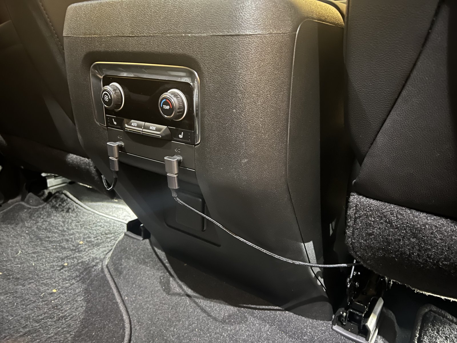

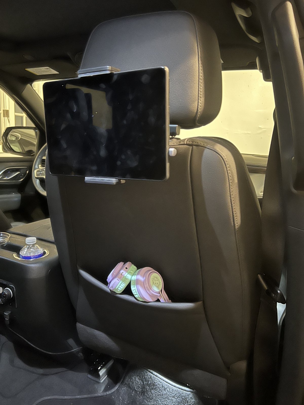

We ended up just buying a couple Amazon Fire HD tablets and headrest mounts, also on Amazon. I then ran the USB charging cable through the back of the front seats (between the “leather” and the seat padding) and out through the bottom using an electrician’s fish tape. Plugged it into the two USB outlets in the center console using 90 degree USB adapters. Added in two sets of Bluetooth headphones. Works well so far and cost less than $300 all in. This could easily be replicated with an iPad or any other kind of tablet. The kids love it and they have access to more games, apps, etc than the RSE offered.

Thanks for sharing that again here. I knew i seen it but couldnt remember where.

Wow, so it was suggested by my salesman that aftermarket is an option, but at the time and without having the visual kinda made me not want to take that route. But now seeing it installed I can see there are some pros. One thinking about what I may or may not be able to do with the RSE unit and what apps/games it will play nice with. Two the ability to swap out units as they get outdated. Three if kids (which I’m currently waiting on number 5 to land any minute) happen to damage/break a unit. Question are you able to sync your tablets to mirror each other? And play audio over the factory stereo?
