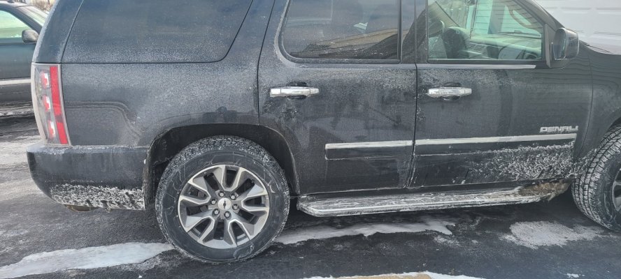

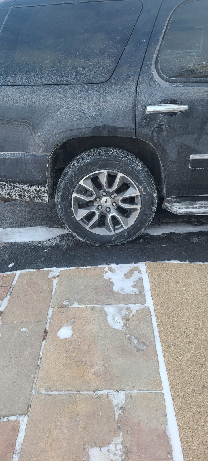

I was able to buy some 2021 - 275/60/20 wheels and tires , wheels are 20x9 stock from a Sierra. They told me these will fit in my 2009 Tahoe. Anyone tried this?
B-train
Sep 12, 2022
2,717
4,936
A friend of mine just put new silverado wheels on his 13 denali and they worked fine. He did wheels only and put 275/55/20 tires on them. They look great, not sure on the larger tire size though

I've noticed a ton of factory take-off wheels coming up for sale on craigslist and FB marketplace as people bought brand new rigs over the past few years and go right to aftermarket wheels. The factory tire size for the 20" wheels is 275/60/20 instead of the 275/55/20 that our generation truck came with. I've wondered the same thing and don't know for sure.
Update: They'll fit but they're right at the limit so they rub for some and not for others. Some say they don't like the ride with the 60s.
