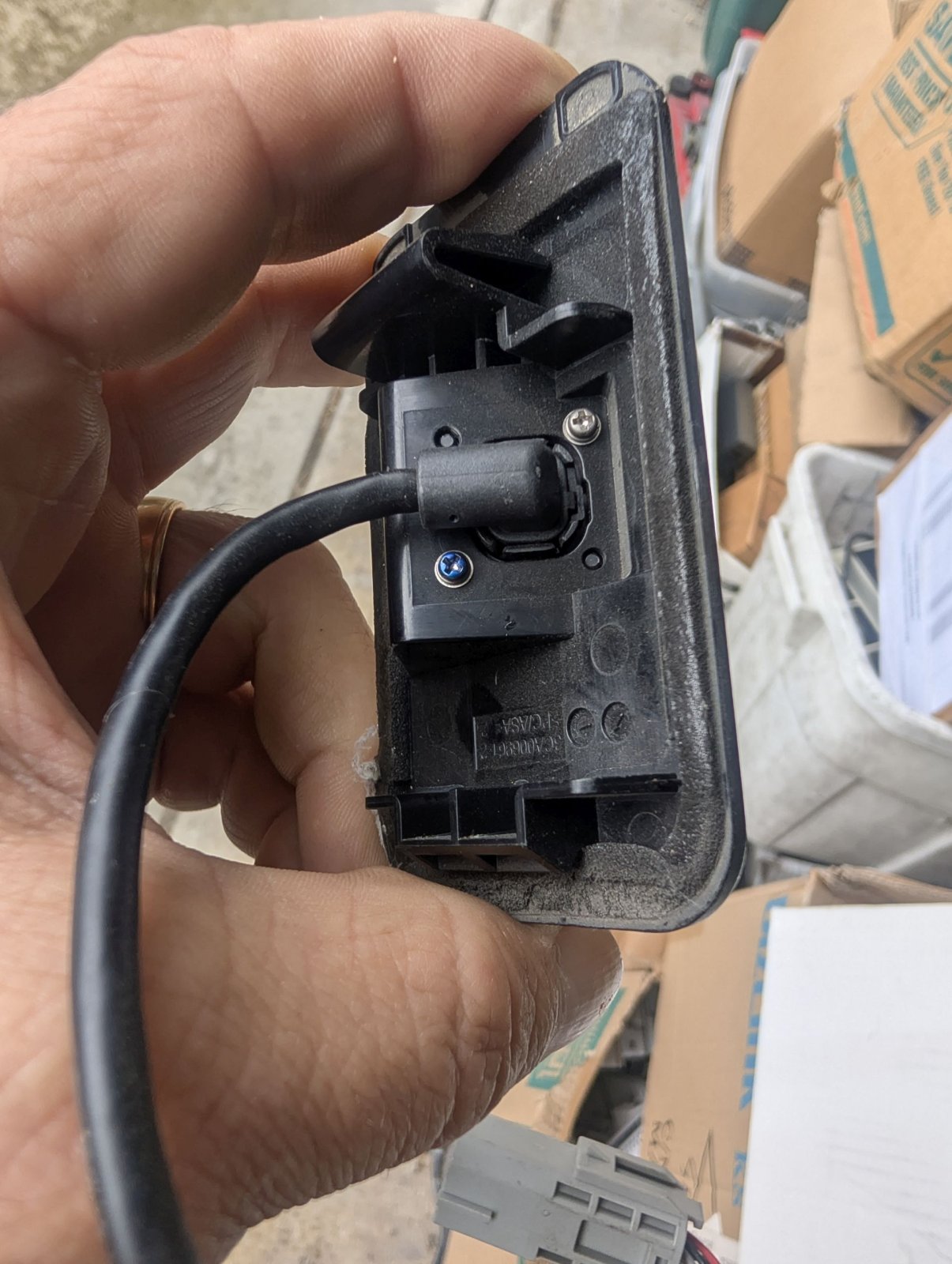

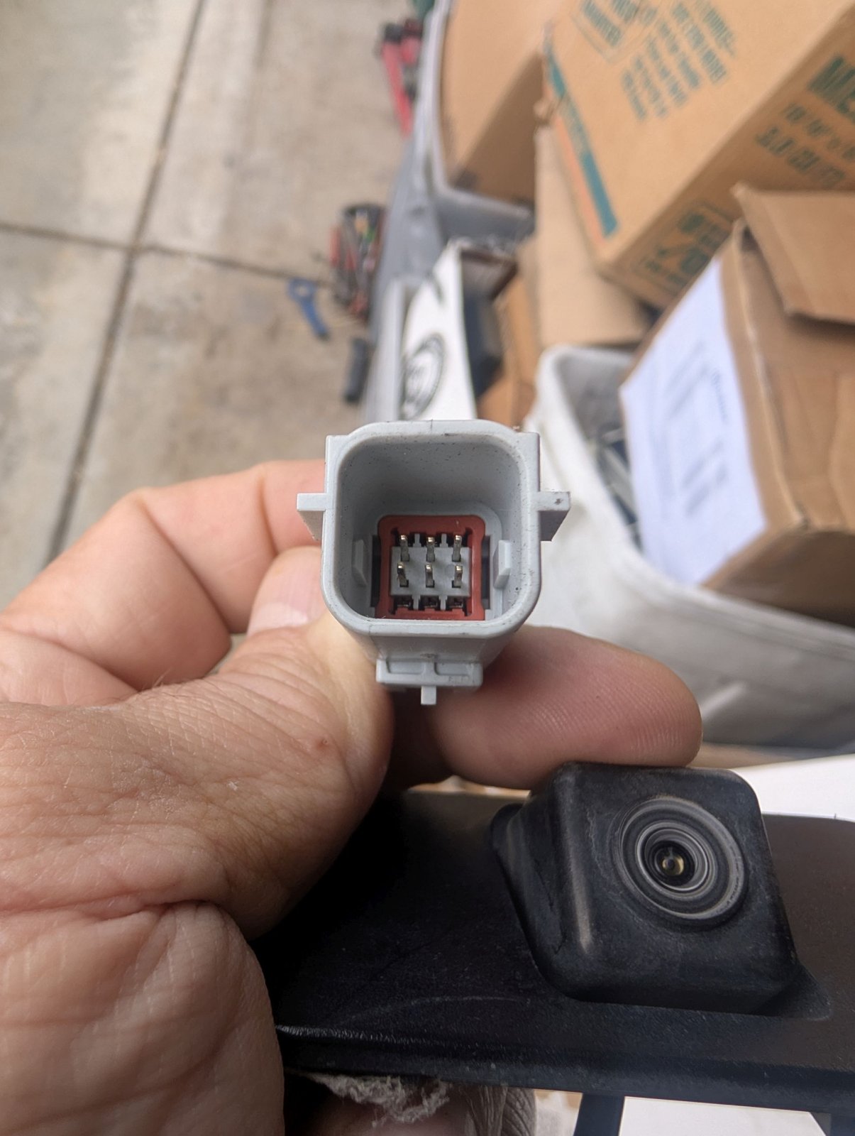

I replaced the camera on the wifes 2016 with a new oem one, under the assumption it would work better it made no difference.
given that doing the job is "no fun" I have not yet tried any another camera's. The one on my 18 silverado seems to work pretty well, but not sure if the actual "camera" can be transferred over the mount is completely different.
you would need to look at the backside of a pickup one and the backside of a suv one to see.
on my gtm900 the entire setup can be dissembled down to the lens about the size of a rolling dice
this is the backside of the suburban one, it has 2 screws so it can be pulled out of the mount, why it has 6 wires I don't know maybe it has some kind of ir ring
