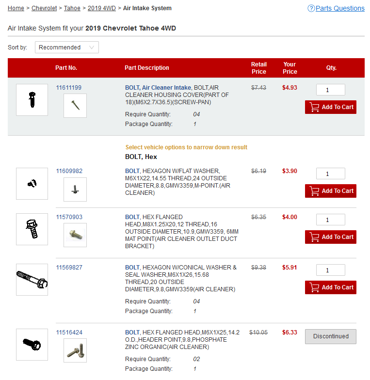

I assume that you've used an online GM dealer parts lookup tool. Here's one that shows five different screws in and around the airbox for your model year. Four of those have pretty good pictures so perhaps you can tell from those by comparing the existing screws you still have.
N
No Strings
Jan 7, 2023
Well, my friend - you found it. All web searches never gave me gmpartsgiant as an option. Thank you so much, I truly appreciate it.

Are they like these? My 2012 Yukon and 2015 Acadia take the same
Buy Auto Supply # BAS01001 (5 Pack) Aftermarket GM Style Air Box Screw Replaces 11611199 https://a.co/d/bzPHpBb
Thanks. Those are the earlier model year screws, mine are Phillips head screws. I'm sure the one you provided would work.
