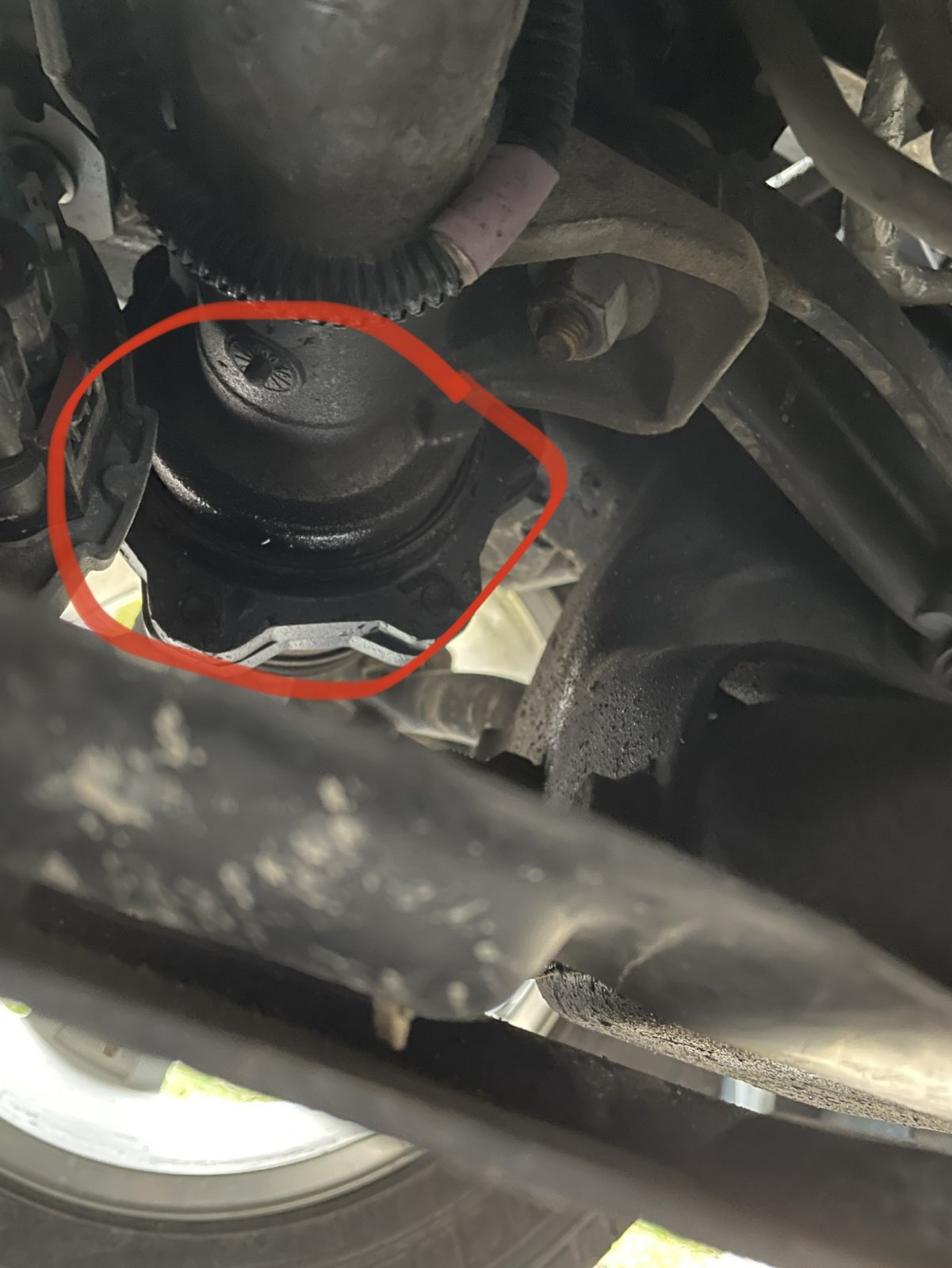

Changed the oil on my Tahoe this morning. 2019, 4x4 37k miles. Have a small leak, noticed it first on the back rear corner of the plastic belly pan, passenger side. Took a pic of the axle, where I see the leak. Any thoughts?

I dropped the truck off at the dealer on Thursday. Turns out CPO extended my b2b warranty until 46k miles and powertrain until Dec of 2025. So regardless, GM pays the tab. Hopefully nothing on back order and I can get my truck back soon. Will update once I know the source of the leak

Busy week, didn’t have a chance to update. Picked it up Tuesday morning. All set, it was the front passenger axle seal. All under warranty, no complaints.
If it ever happens again after the warranty is up, it's an easy job to replace it. The one in my '07 lasted 200K so hopefully you won't have to revisit it ever.

Agreed ^^^^
I replaced tons of these on 2000-2003 yukons when I was at the dealership. Pretty easy job
