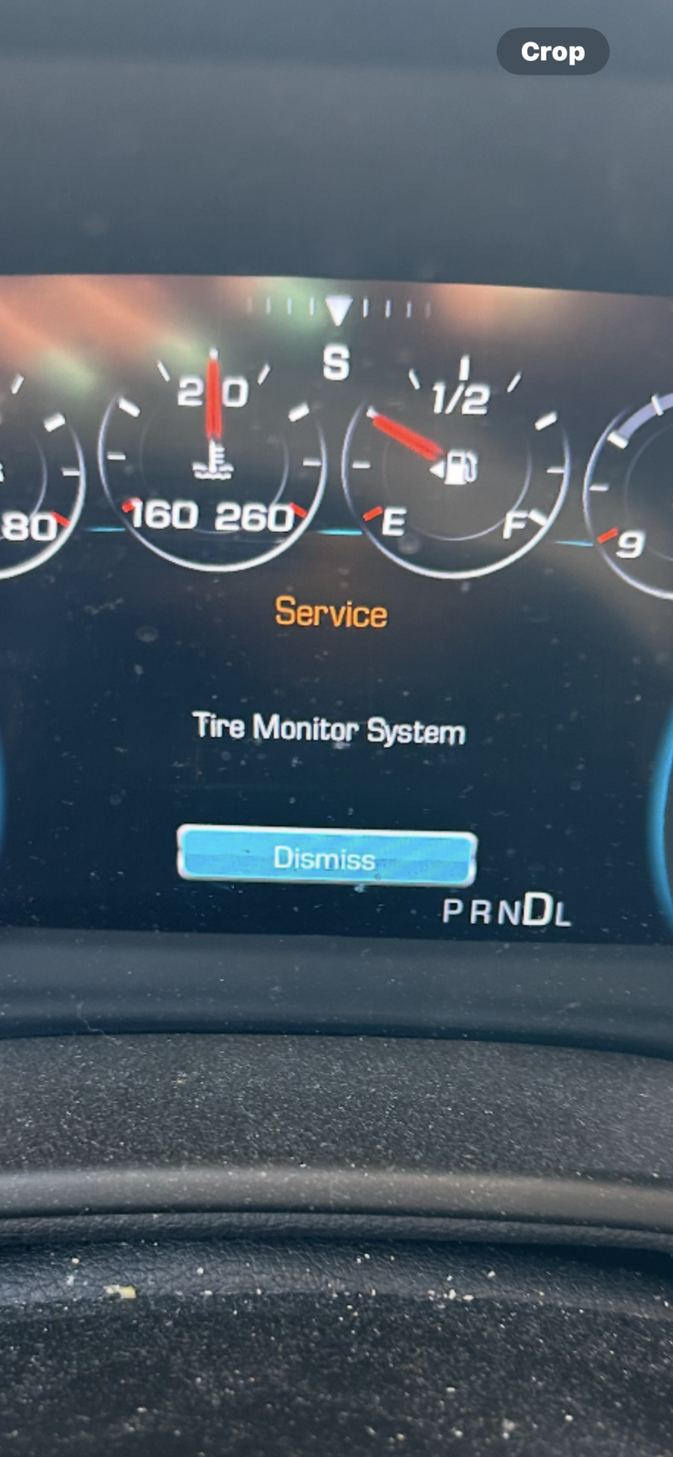

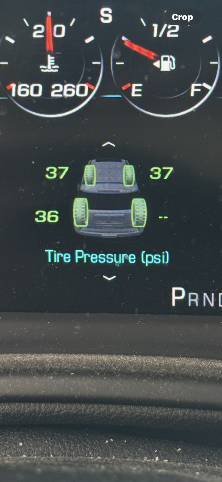

I have a 2018 GMC Yukon Denali. My wife told Yesterday my dashboard displayed a message saying service tire monitor system. When I got home, I went over to the car and I looked at the dashboard and scrolled to the tire pressure and there was nothing now for one of the tires meaning a pressure reading. Does anybody know what this could be and how to fix it? Here are a couple of pictures of what it said. any help is greatly appreciated. Thank you very much.

Is that easy to fix and how do I know for sure if that’s the problem could it be anything else?
B-train
Sep 12, 2022
2,710
4,920
You'll need access to a tire machine and balancer. Then use a tool to activate the new sensor when installed on the vehicle, or go through the relearn process for all 4 with the key fob/corner light/horn honk/ air pressure adjustment.
Either way is easy. Get the OEM sensor for $60. The aftermarket ones seem to have ****** batteries that don't last long.
Remember, once one goes, the others aren't far behind. Your wife can live with the light, won't hurt a thing (I've been canceling that message for a year now one mine because one of the new old stock GM ones pooped the bed after 6 months......go figure). I'd wait until you need new tires and then put all 4 new in at the same time.
