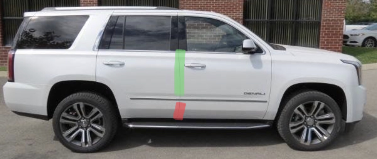

For example (this is NOT my vehicle):
The area highlighted in green is fine, no problem. The area highlighted in red is where the problem is — it’s not flush. The worst part is the very bottom of the red area.
I wonder if GM would warranty this. It can't be within 'normal' tolerance.

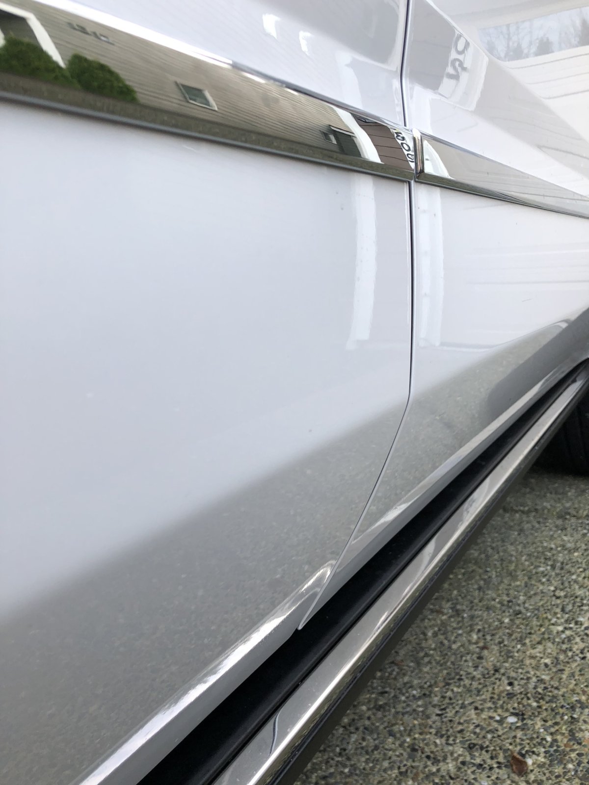

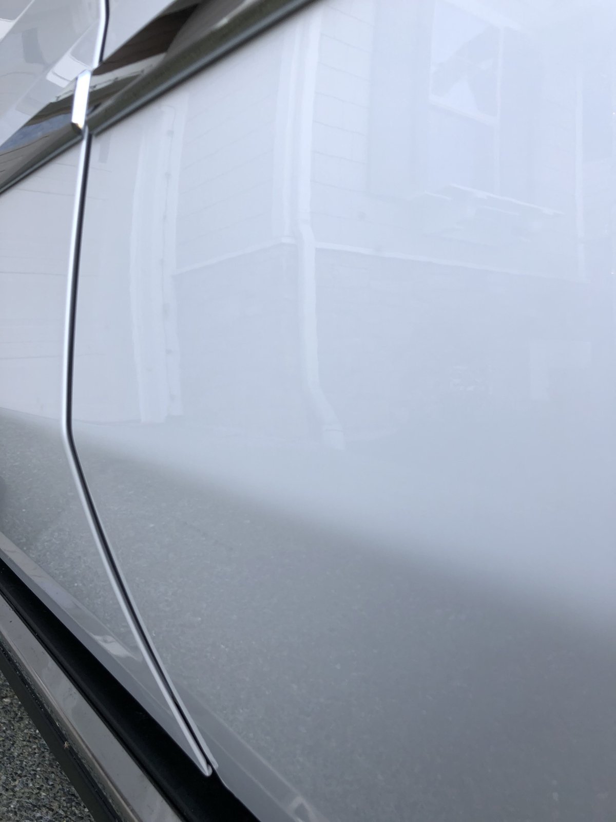

Alright I just went out and took some photos.
Driver side -- see the issue? It isn't flush at the bottom:
Passenger side (flush):

Ehhh it might just the pic, but I’m not sure you’ll find anyone working for GM that can get that door anymore flush.

^^ If I run my hand across the lower panels on driver side it's not smooth -- the door is sticking out. It's completely smooth/flush on the passenger side.

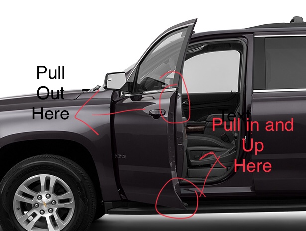

Guys, open the window all the way and door all the way. Have someone pull on the door from the window frame down as if they are trying to open it and you put your hands underneath from a squatting position as if you were getting out and dropped something and pull as if you were trying to close the door but more of an upward motion. Do not jam on it just gently pull up, I can guarantee you will get that bottom corner to pull in a little more. DO NOT PULL LIKE YOU ARE TRYING TO KILL SOMETHING, just a gentle tug.
