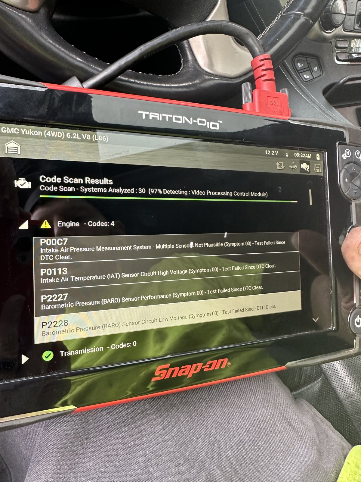

So I switched to premium gas around 100k miles. Before that I’d get like 415 on a full tank of mostly highway. When I switched to premium more like 460-480. When I replaced the Mass Air Flow I’m now at like 535 the last two fills up. When the code was run before new injectors. Check engine like would come on randomly. I was getting tons of mis fires in one cylinder. It would stop after so many key cycles but then a week and a half later same thing. So I swapped all the injectors since the labor for all was an extra half hour over just one. When I got it back I was getting codes I’ll attach it here. I had 3 codes one day and then 4 then next. However when the 3 codes showed the engine was running when the 4 codes showed up the engine was not running the car was in accessory mode. I don’t have a scan tool the shop used theirs but to me I would think the engine needs to be running to show active codes but I’m not sure. After I replaced the mad air flow sensor no codes but I had the negative battery off over night and literally connected it and drove probably a mile to the shop where there were no codes. I’m not sure if it was run enough to show codes or not. It was still doing it for the week I drove it and no engine or any lights in so I just swapped the MAP sensor. I don’t feel like I notice any sluggish behavior and my MPG seems to be going up with the new sensors. I’m actually starting to wonder if 1. I’m being overly sensitive to the Random what I’m calling rough idle because of the check engine light being on(since I’m not seeing any RPM really change) and it’s intermittent. It’s a V8 and I can’t say that it didn’t always have a bit of a rough idle compared to my 2011 Acadia Denali. Might be just the fact that it’s an 8 cylinder or I’m wondering if its possibly an engine mount going bad also. I’m heading to the shop today to have them pull codes to see if I have any.
On the screen shot I added the three bottom codes were the original ones after injectors with the engine running. That screen shot is from the following day before MAF sensor replaced and with the car in accessory mode engine off.
