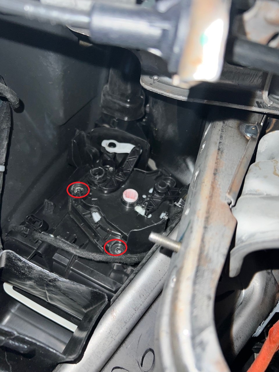

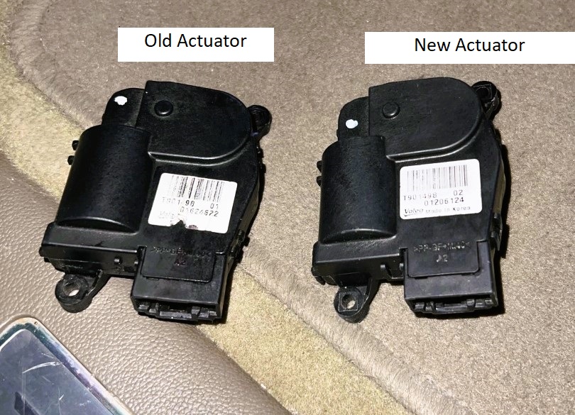

solson96
Oct 23, 2022
Ok thank you! I have a crappy code reader and it read B1011, U0121, and U0140. The last two are lost comms with ABS and Body control module. If it is the controller how could I get it programmed, a specific program and tool?
S
solson96
Oct 23, 2022
I got the new actuator but it will not seat down enough for the screws to go back down into the housing. There is a gap too big to even start one where I was hoping it would suck it in all the way but I dont want to crack it. Any ideas why this might do that? I tried putting the old one back on but it was the same thing! Murphys law kicked in when I said oh this will be R2, remove and replace as we used to say in the air force!

Did you verify that it was the correct part and part number, Does it have to go in a certain way to make sure it seats properly, maybe a youtube showing R&R.
