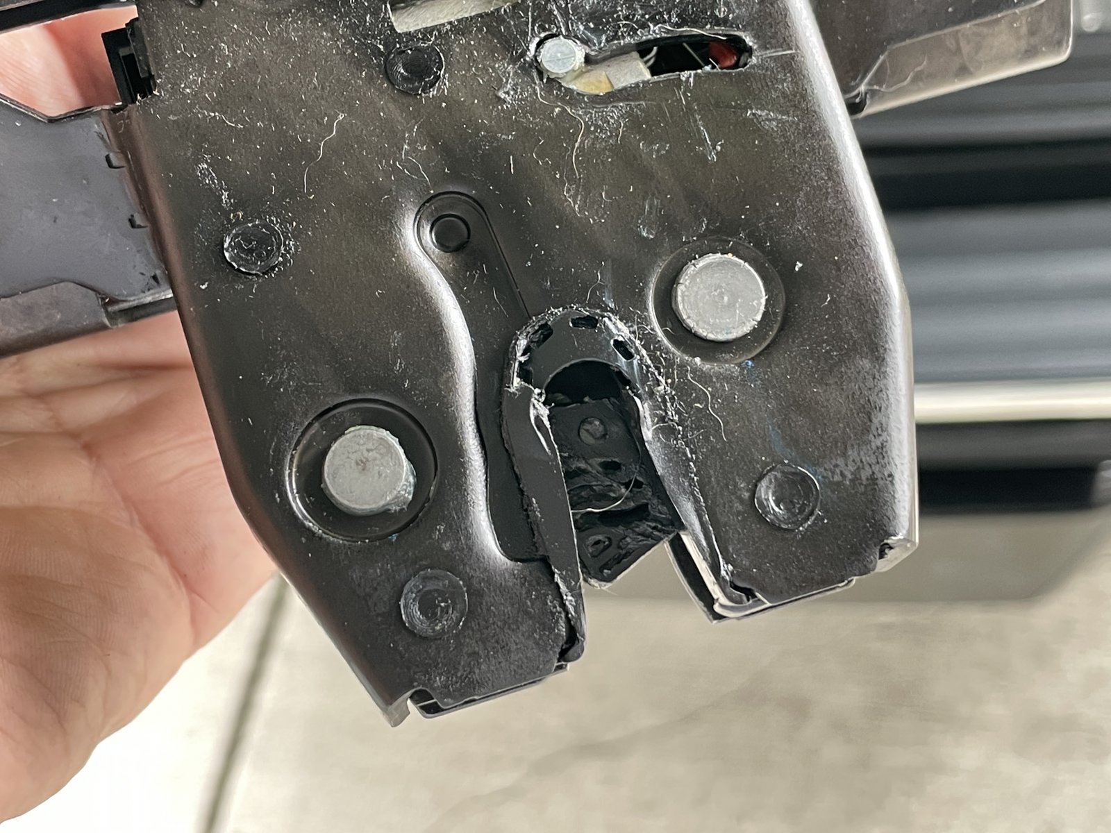

Ok so update. Took a while to get to this because I was down with the new strain of Covid (BA5) from July 1 to 13. Got me bad; I really underestimated this thing.
So I ordered a replacement latch mechanism and just installed it. I’ve tested it probably 30x now with different open and close scenarios. Seems to have solved the problem (knock on wood). There is a tangible difference in the actual unlatching sound. A loud distinct click that never existed before. So far so good. Cautiously calling it resolved.
The installed one is the new one.
Thanks, all for your input.
