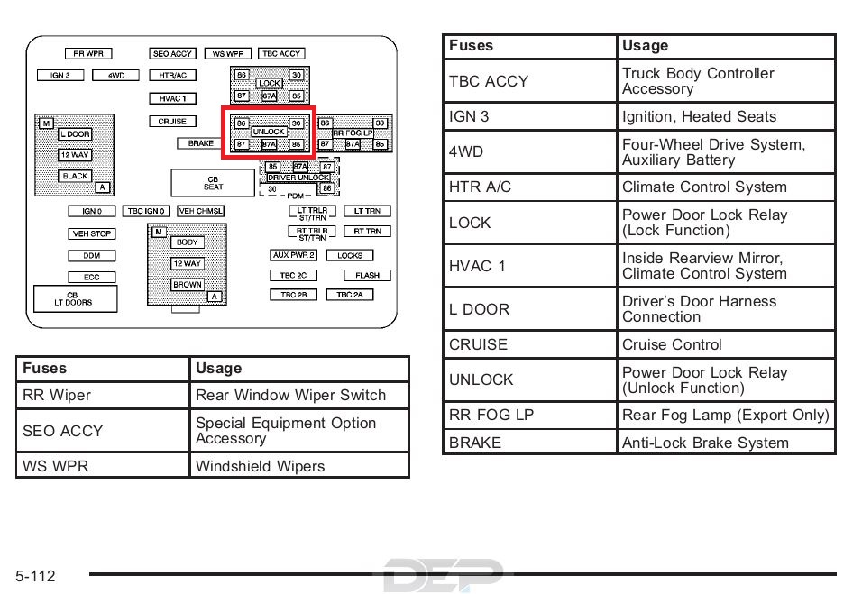

There's an Unlock relay in the fusebox that's accessible by opening the driver's door. I'm not sure if that's for the liftgate or not but take a look:
