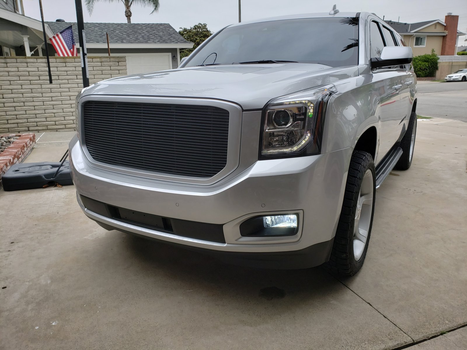

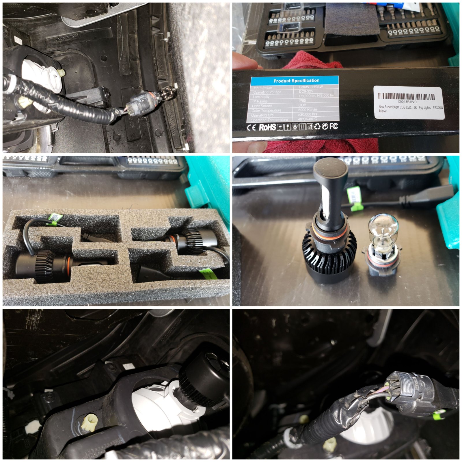

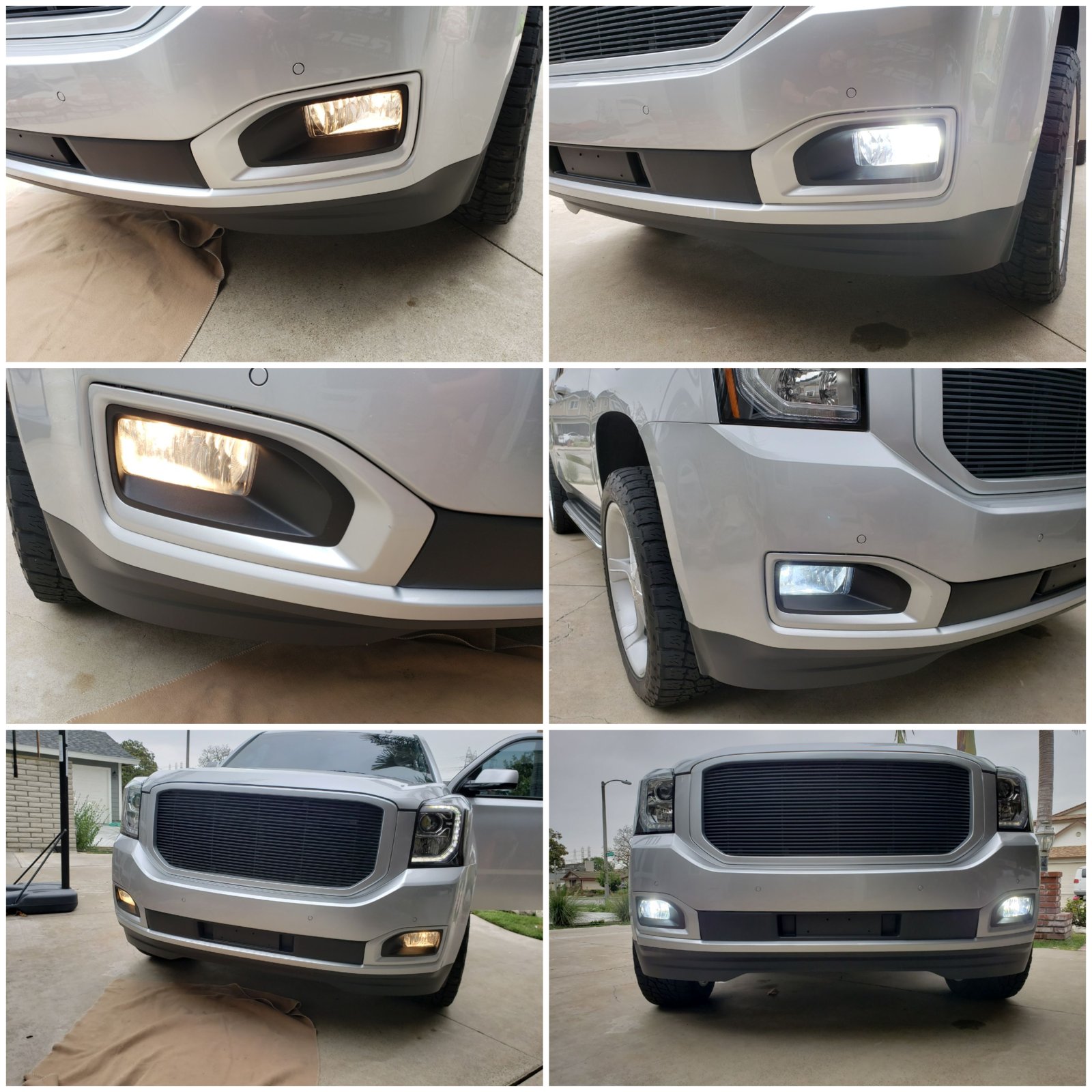

Quick update; received in the PSX26 LED fog lights and they fit perfect! Took some pics, hopefully this is useful for any of the other members, it was baffling for me that most of the research for the model all said the light was a 5202, so not sure if earlier models took this and they changed in 17? My truck was a late 17 production, so not sure if some 17's and 18 models are different? Either way, the LED fogs are so much nicer and match the LED lighting for the headlights low and high. Thanks for the help and input tool2269!
