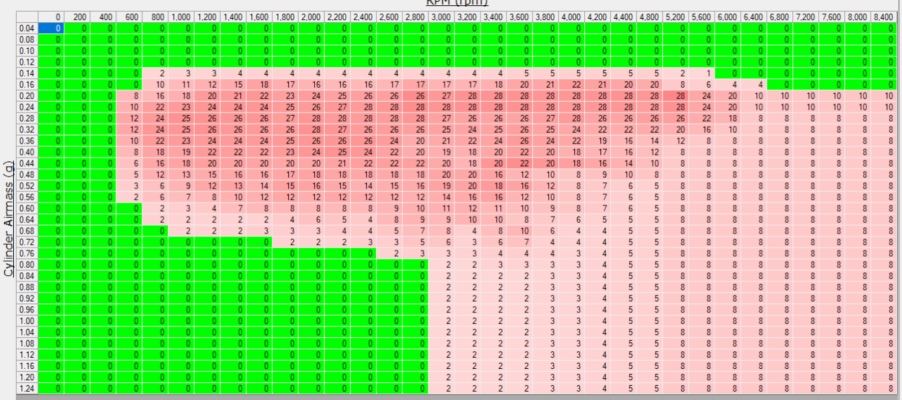

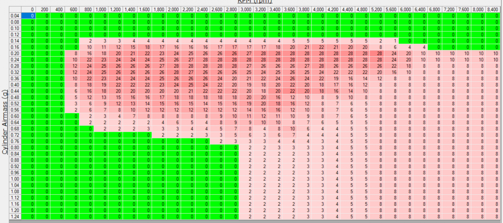

Yesterday I made three changes, power enrichment pedal enable, PE torque request and adjusted the cam timing. Check out the pictures of the cam timing table. It revs out now.. where as before the engine would run out of steam in the higher RPMs.
Changed 12419 PE pedal enable
Changed 12418 PE torque
Changed 33102 and 33103 reduced by 50%
