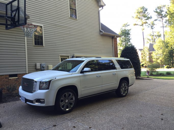

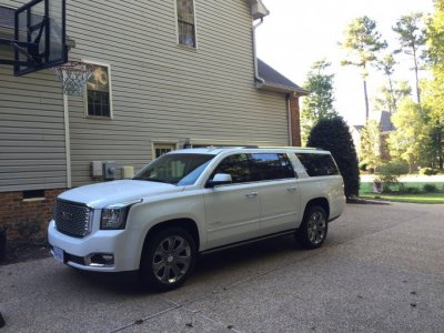

9/15/15 - I took delivery of my 2016 Yukon XL Denali around noon. This truck was DX'd from another dealership approximately 100 miles away and was driven here on Monday (9/14/15). I took a quick test drive and was focused on the buffeting issue. It was definitely there but didn't seem to be as bad as previous vehicles that I had driven. On my way home I noticed some severed vibrations above 70mph all the way up to about 80mph. I called the service department yesterday afternoon and made an appt for this morning. We needed the room that this vehicle provides fairly quickly (lots of travel with soccer, aging parents, etc. - my wife, two young daughters and two puppies less than a year old). Some say why didn't you just swap it out with another one? This configuration was exactly what I wanted and, unlike White Diamond, the Summit White's are hard to locate, especially a 2016.
9/16/15 - took car in and described in detail what i had experienced (the buffeting and the vibration). 3 hrs later they informed me that a GM representative happened to be onsite and that they found 3 of the 4 tires to be significantly out of balance (via road force balancing). They have 20-30 (I don't recall which exact number) tires in stock of the same exact model that's on my Yukon XL (22"). They are having to put a tire on a rim to get them all matched which should solve the vibration problem. I was put into a Chevy Impala from Enterprise (there is world championship bike race in town for the next week so all larger rentals are gone, apparently). Stay tuned.
