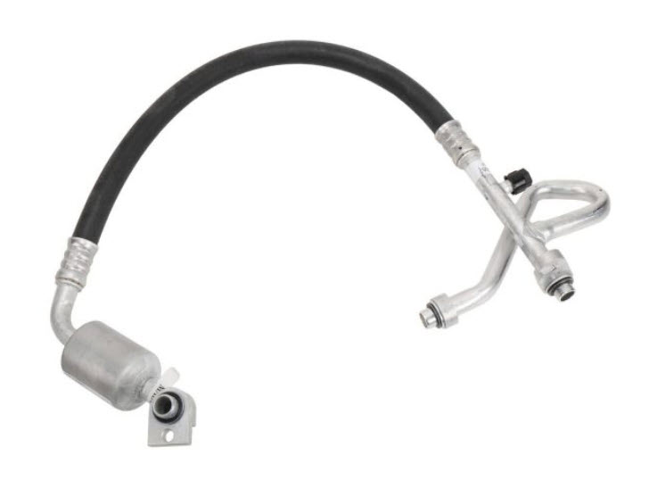

I am replacing the AC Compressor and flushing all the lines. My question to the group is can I flush the "
Air Conditioning Compressor Hose Assembly - GM (84459867)". It has what looks like an accumulator inline see below. I don't want to spend another 100 bucks if I don't have to. Help. Thanks in advance

It’s the compressor to evaporator line. If your compressor failed and spread shrapnel through everything, I think it’s worth replacing all of the lines. Rock auto has it for $72.

Thanks for the reply, I bought a new line but flushed the other lines, condenser, and evaporators a couple of times. Replacing both expansion valves as well.
