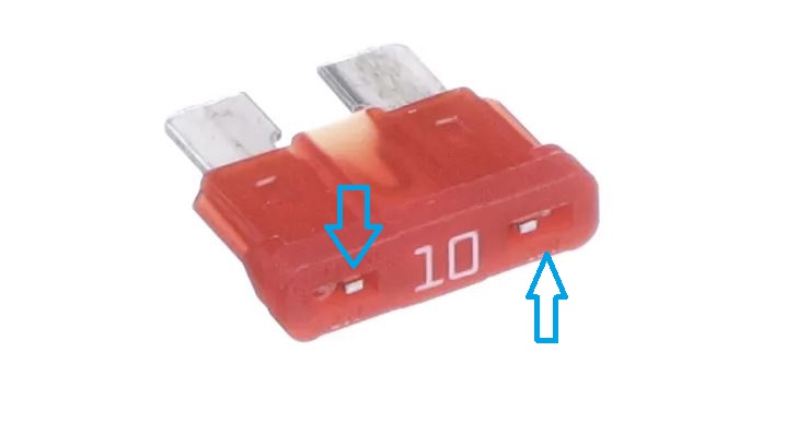

only thing I can advise is to check all of your fuses, easy to do with a meter all you have to do is touch the 2 outer pins to check for continiuty, you do not have to pull the fuse out
only takes a few minutes to check every fuse there is
