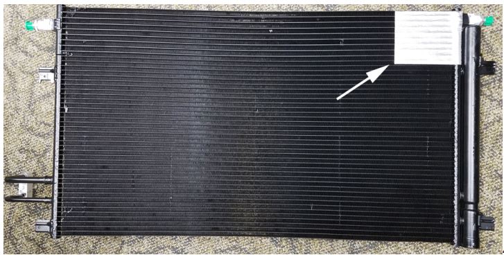

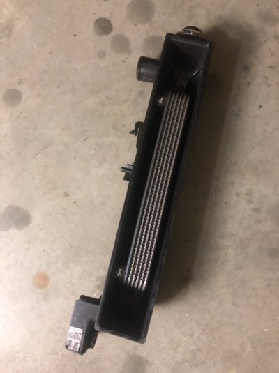

I believe most standard models have a trans cooler that is on the side of the radiator. The models with towing package have an additional cooler in front of the radiator. At least that's the way it is on my 2019. The trans cooler is the top few inches of the unit and the bottom is the condenser for the AC. The fluid flows first through the standard cooler and then there are lines that loop around the radiator to connect to the secondary trans cooler/condenser in front of the radiator.
It was the same way in my 16. I’m doubting the guy knew his stuff.
