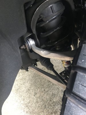

Post pics of upper control arms and droop stops. It could be the limiting down travel and need of lift UCAs.

Ok I suspect it’s the upper arm hitting droop stops. You can visually see the arm marks on the stops if there has been contact.

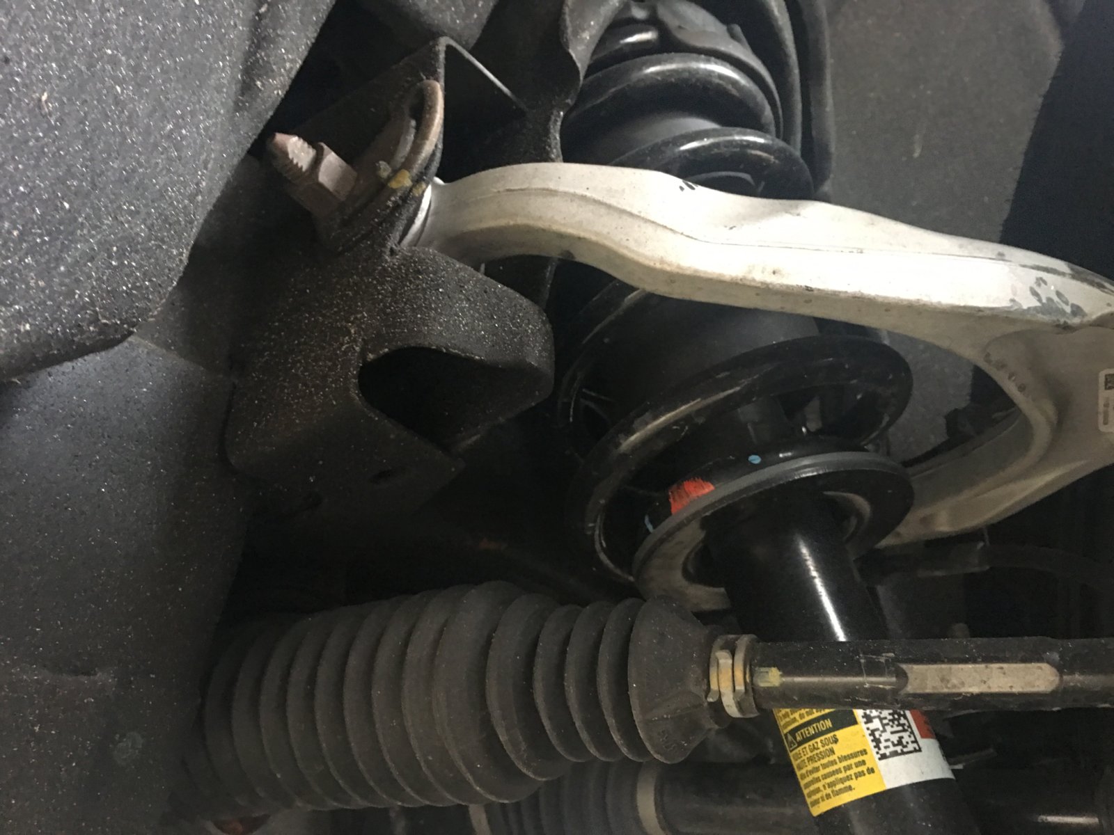

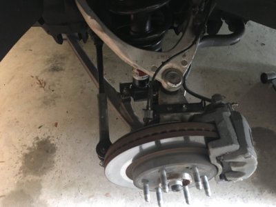

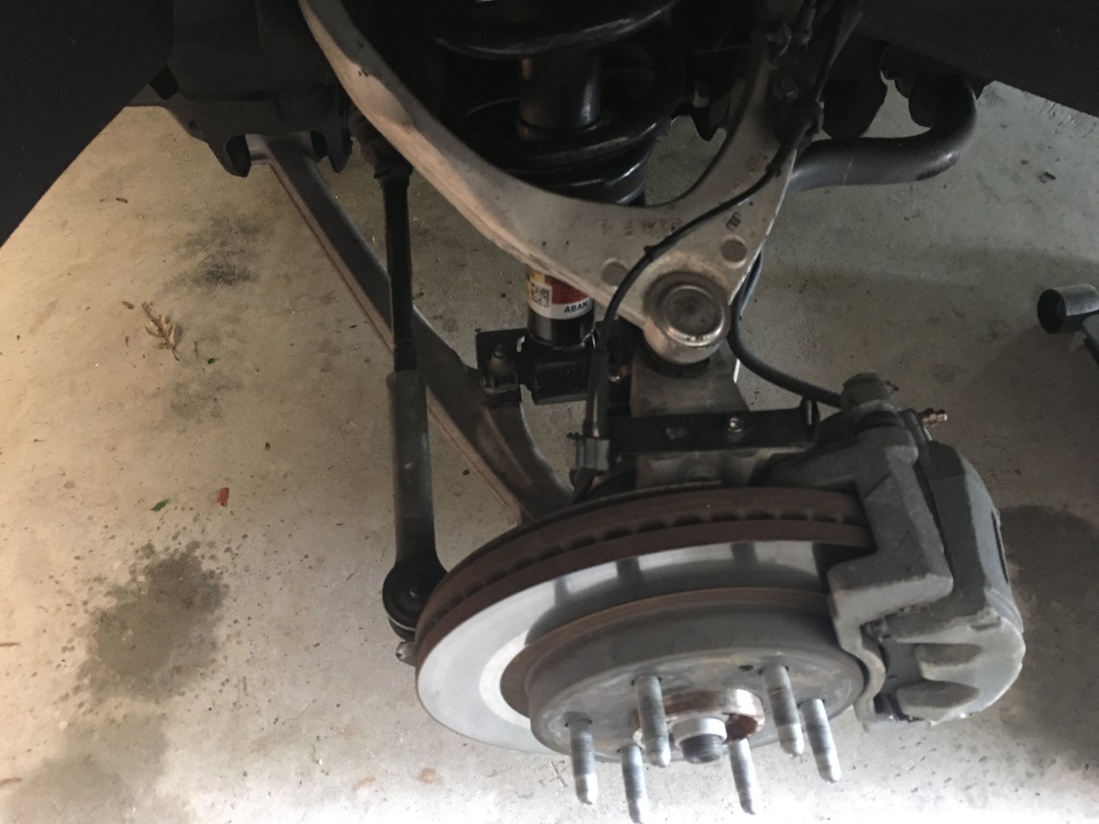

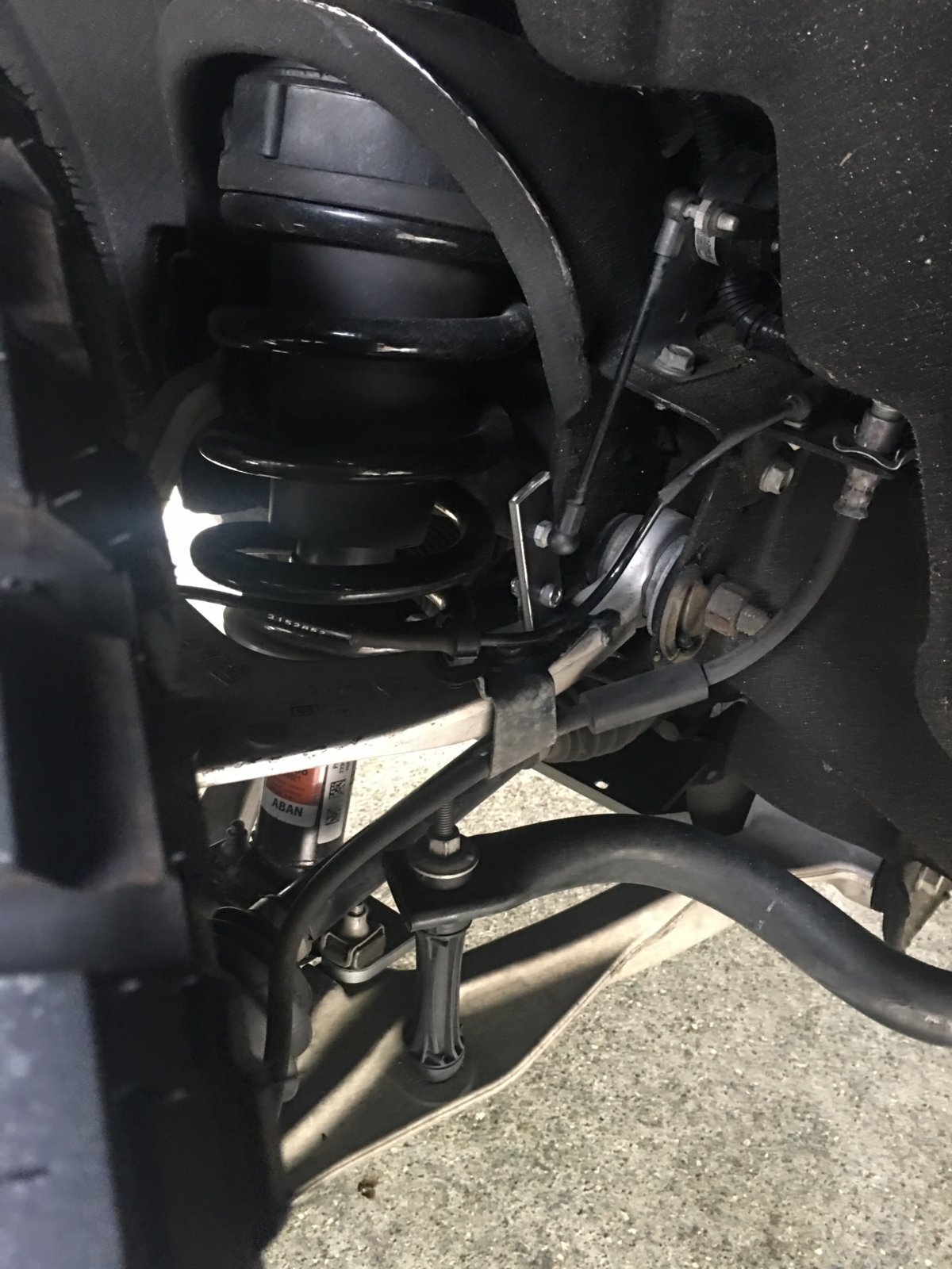

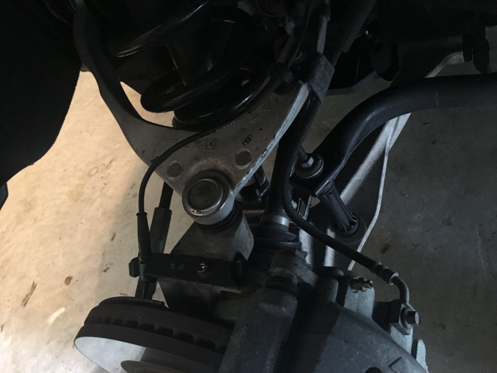

Sorry in the delay. Here are some pics of the
I apologize in the delay. Please see pics requested. I installed the magna ride brackets and it rides smoother however the noise is still there. It does not make it all the time just on rough roads bumps etc... Let me know what you think. Thanks again

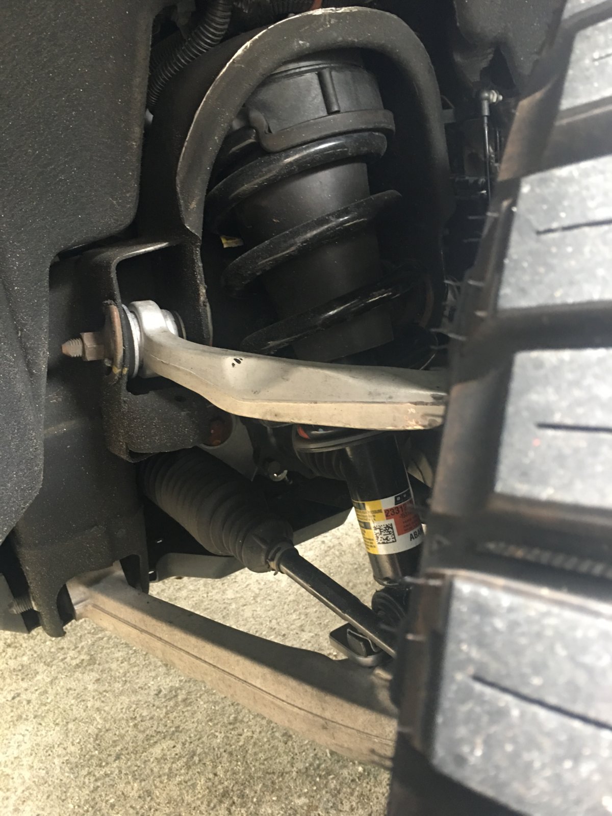

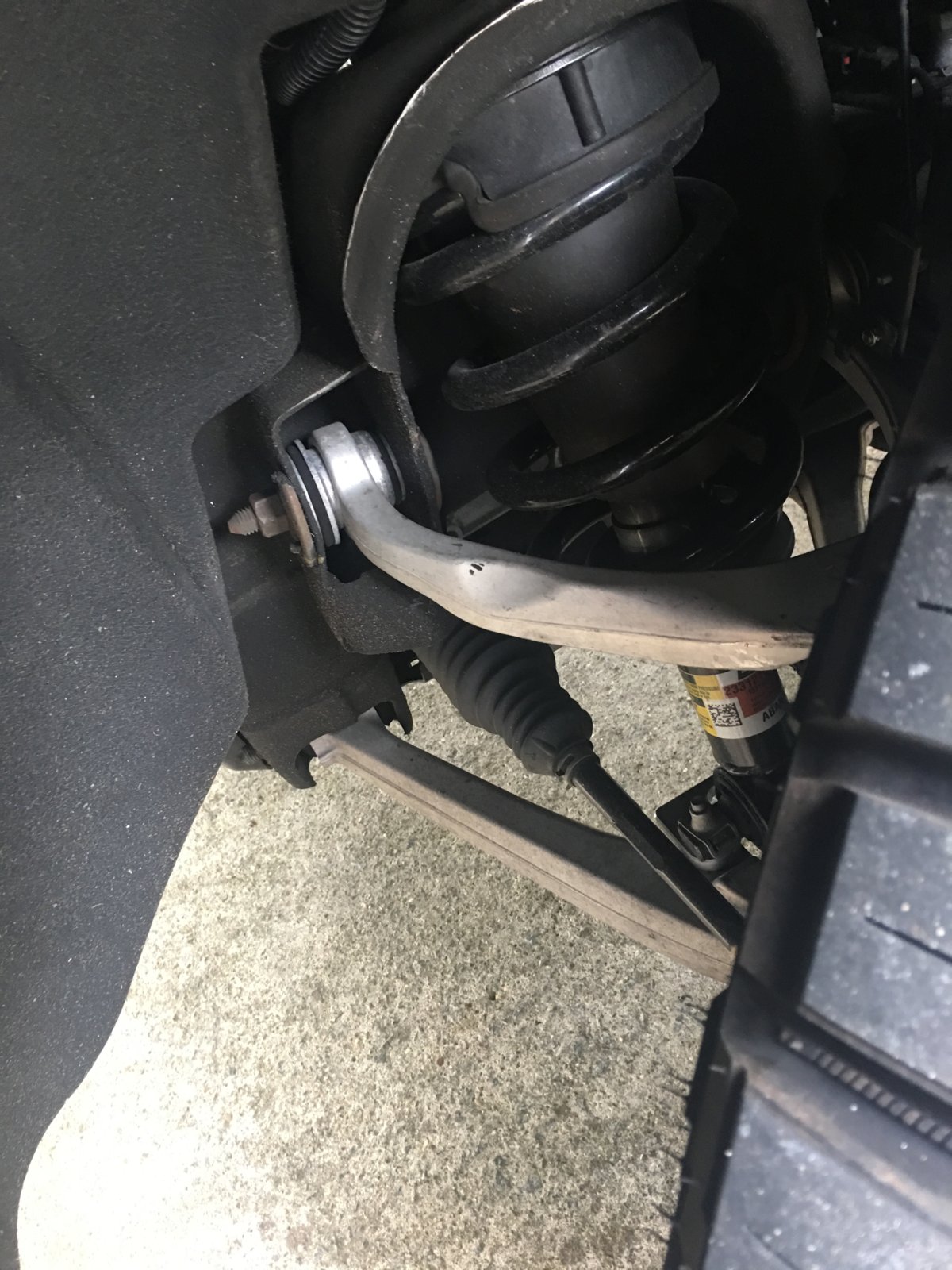

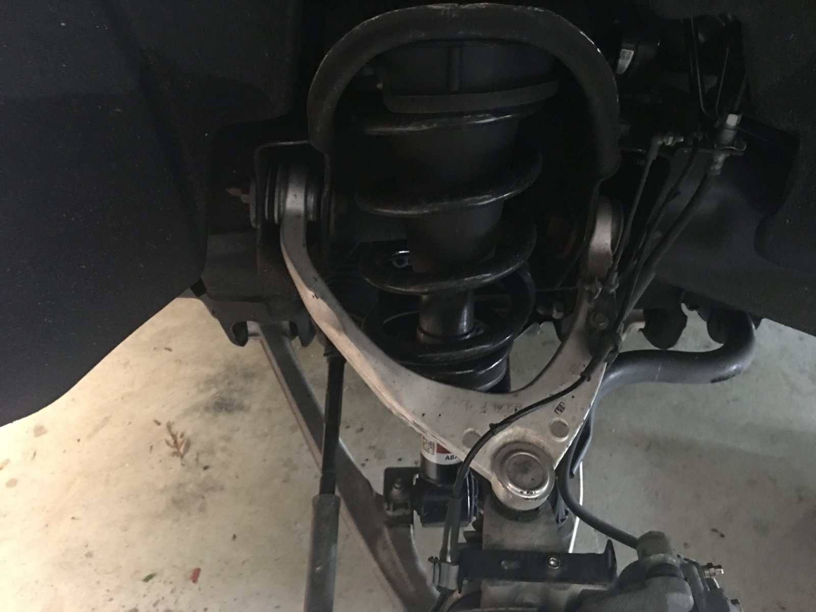

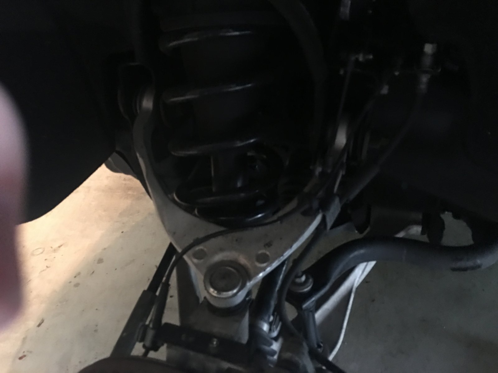

Thanks for pictures and maybe I wasn’t clear on what to show. Leave the wheel on the truck and under its own weight on the ground. Need the gap between arm and droop stop. I will try to find a similar picture online to show what I’m looking for but I’m pretty positive it’s that area contacting which is the sound you’re hearing

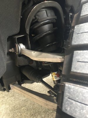

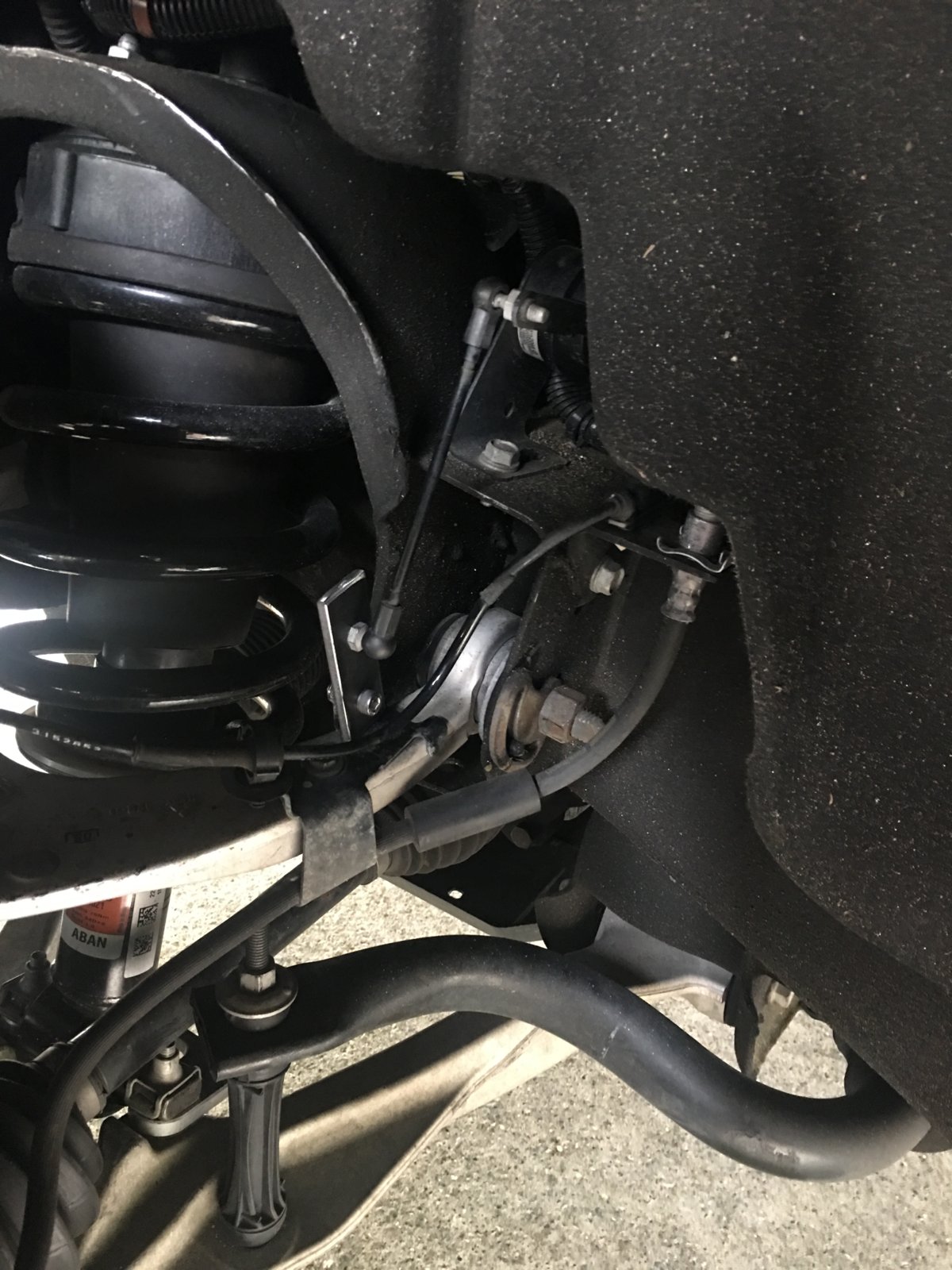

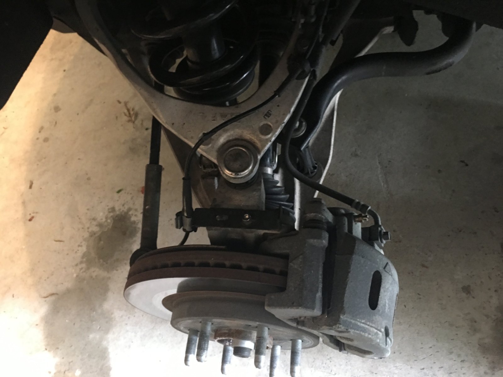

Sorry, here they are with tire attached. Not 100% if this is what you are looking for. Thanks again.

So this kit looks like it has a very small lower spacer (looks like .25" for ".5 of level) which means that the remaining 1.75" should come from an upper spacer. Is it possible that they did not properly tighten the bolts that mount the upper spacer to the frame's shock tower OR the bolts that attach the spacer to the shock? Both of those would cause the shock to jiggle around and potentially clunk when you hit a bump. That's where I'd check.

That's much better but doesn't appear to be hitting the droop stops. How does the passenger side look? Get an videos of the sound?

Thanks for your reply. We checked all the bolts on top and they are tight. It only happens on rough roads or bumps.

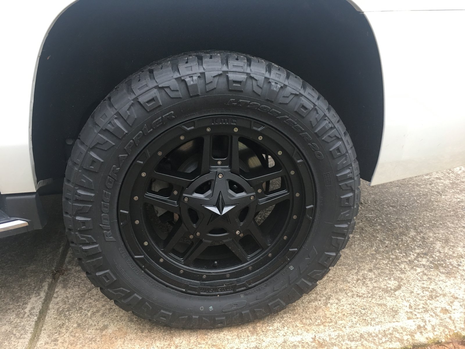

DenaliBQ
Dec 1, 2015
296
49
do you get any rubbing with that tire size ? what is the size 33" ?
