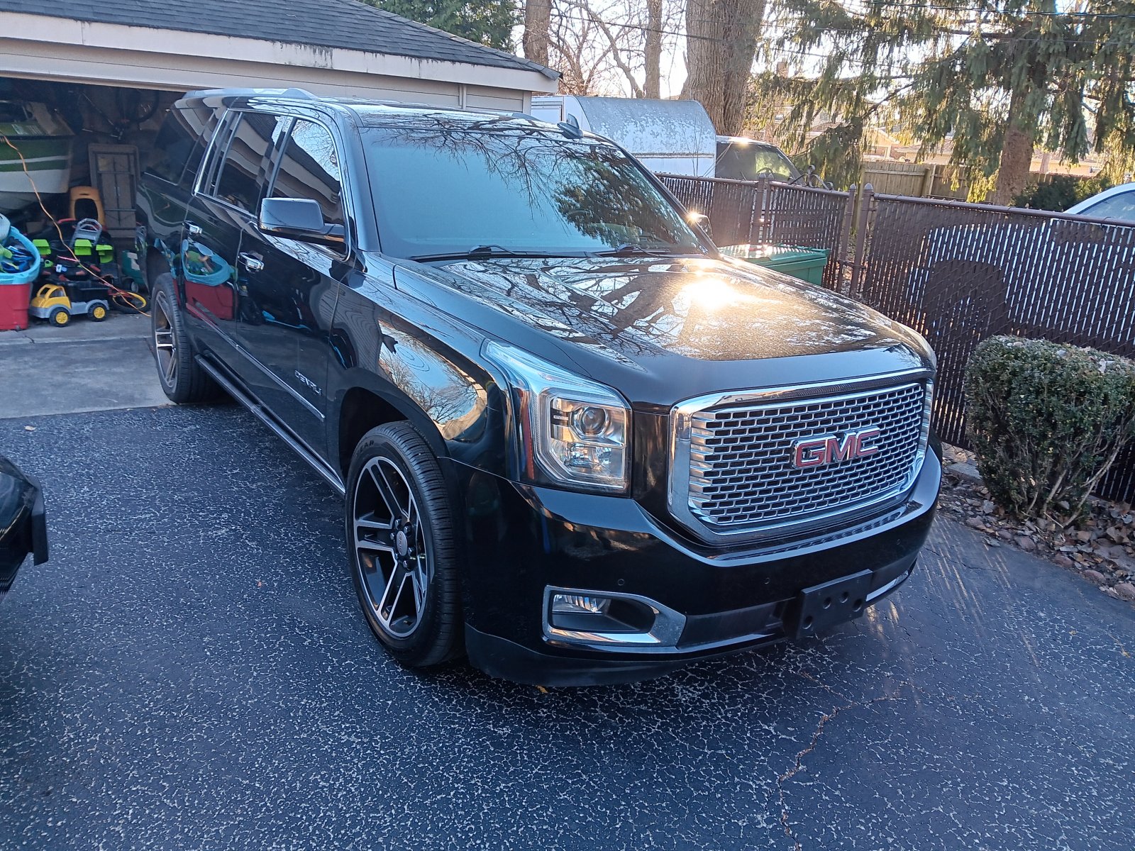

Pics of the truck, please.

Thank you both, I attached a picture of the truck. I do have a scanner to read and clear codes but this isn't showing up on it. Do you guys have any recommendations on a better scanner that will allow me to do more with these trucks? This calibration is a good example. Is it something a dealer has to do or could I do it with the proper scanner? I've researched this error messages and they point to the front facing camera for lane departure/adaptive cruise failing, not the bumper sensors. I was more so wondering if it would have to be calibrated by the dealer if I bought a used one or if I could put it in myself and solve the problem.
