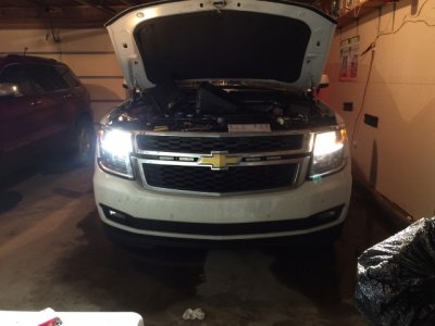

Finished Install
Hood Open (OEM on Right - HID on Left)
Hood Closed (Both HID)
