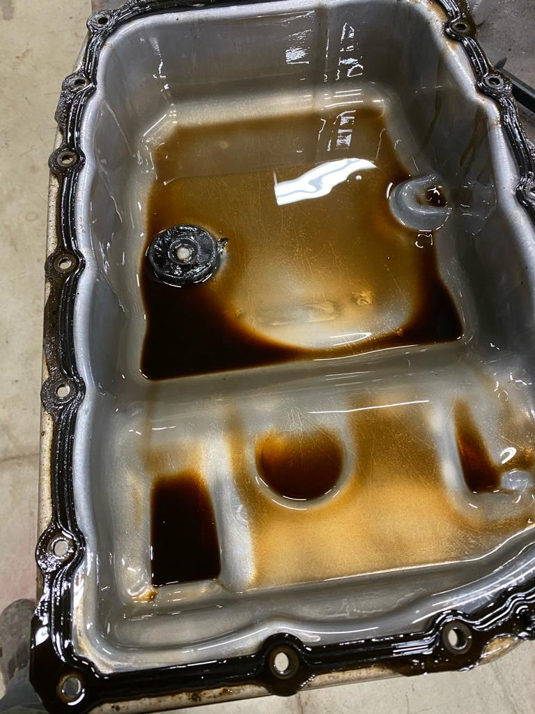

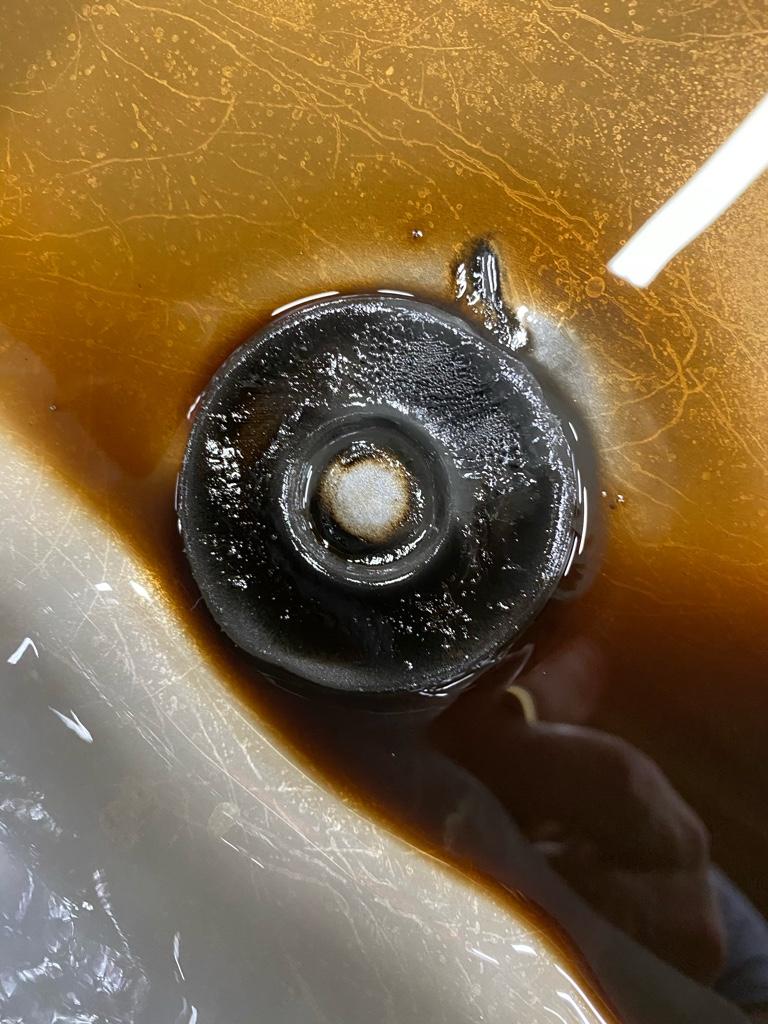

Dropped the pan.
- oil has a strong burnt smell to it.
- small amount metal flit around the magnet
I’ll replace the filter and refill with new tx oil and see if there’s an improvement.
Damn you GM for making me drop the exhaust to drop the pan.

It looks like your on the early signs of a trans failure. You will likely get more out of it but be prepared to rebuild/replace it. No yellow metals so im guessing clutch and steels.
Also the exhaust drop for the trans service is BS lmao. I hate it.
