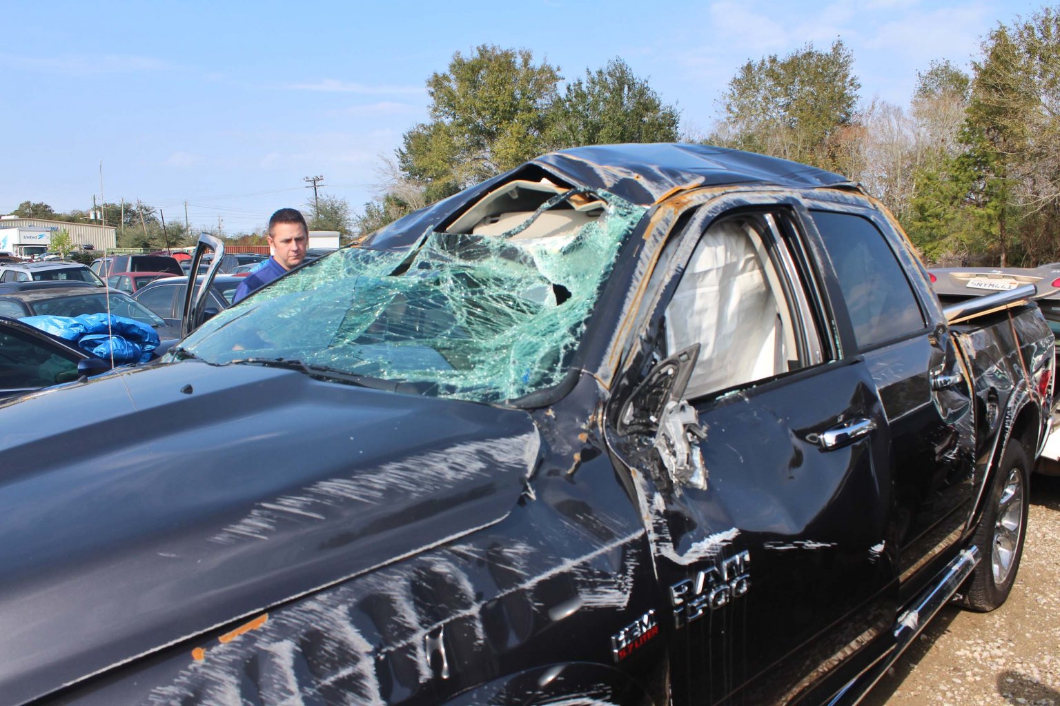

Wrecked the new ram...got rammed in the rear by a crown vic going 75...up and over and roll

DAMN DUDE !!! I hope you are OK !!...Get yourself checked out thoroughly...a hit like that can F**K you up and you might not know it until months later.
