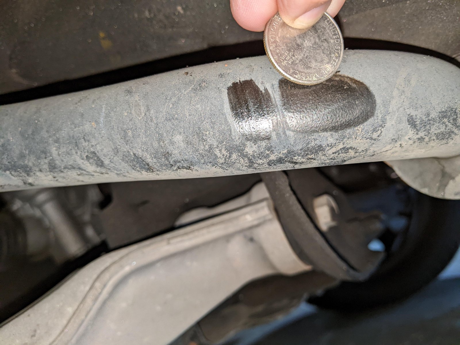

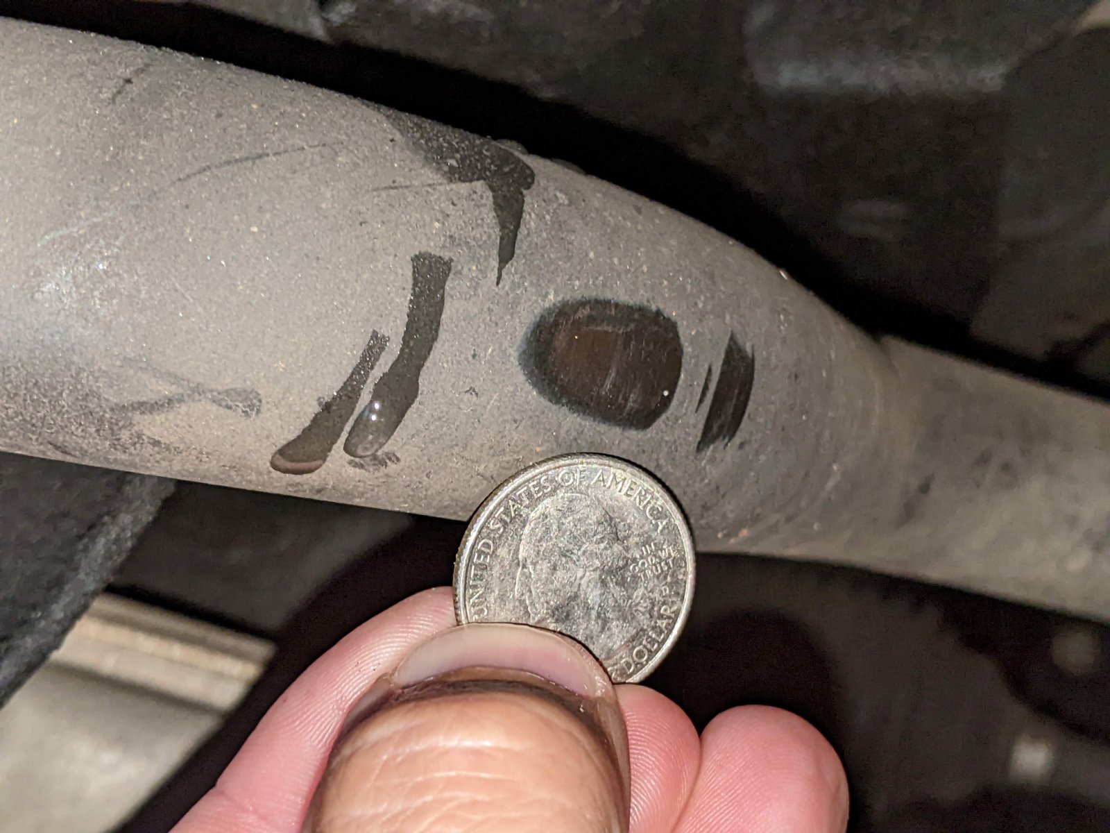

Here are two pics of the sway bar and where it's being rubbed with a quarter for size comparison.

With bar having two places rubbed looks like smaller size tire rubbed also.
That's a good point. I have no idea what it looked like before I changed the tires.
However, I can hear it rub the sway bar now and as far as I remember, I never heard any rubbing with the smaller tires. Family noticed it too so I'm assuming it didn't rub before.

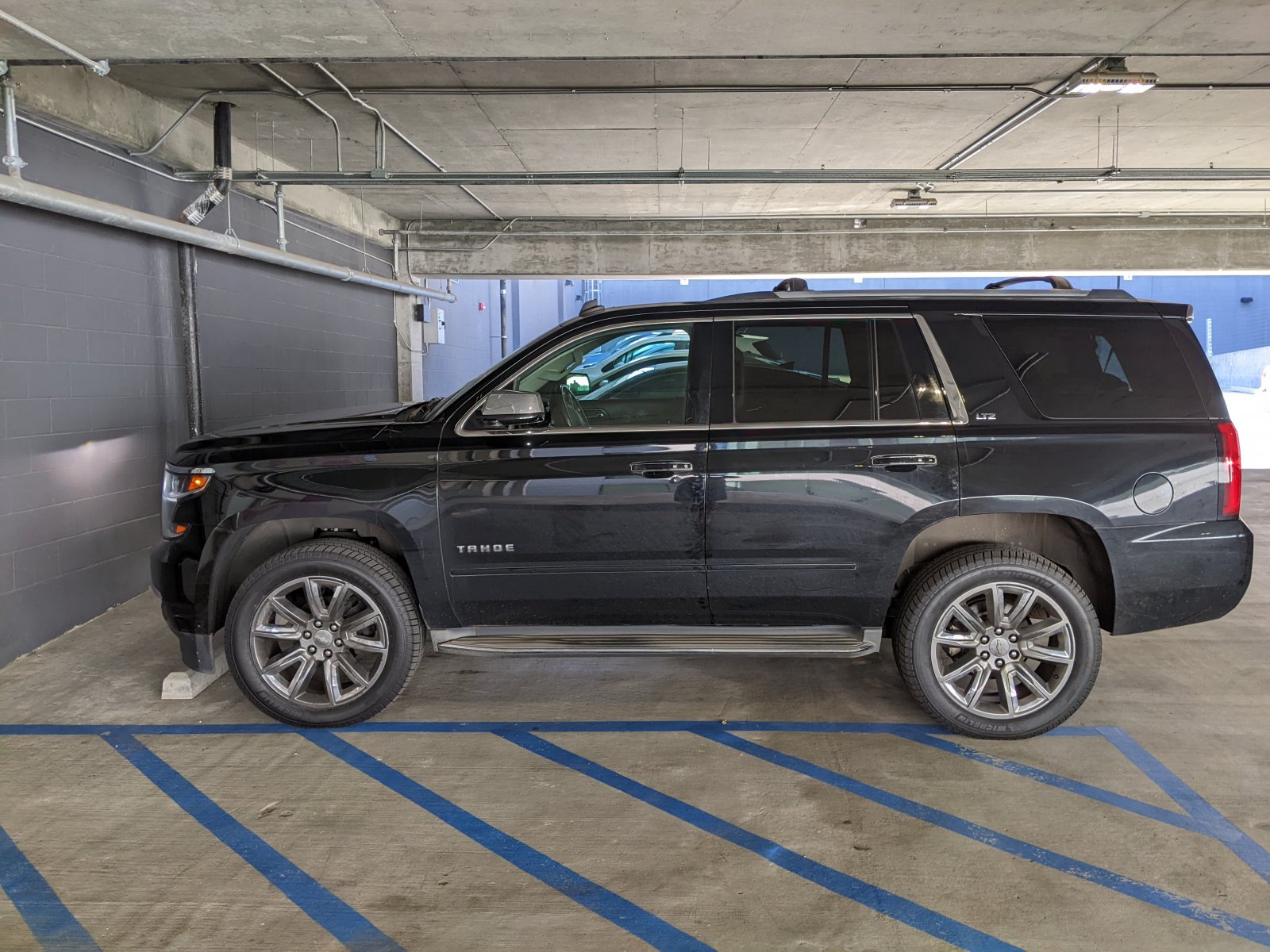

Here's a pic I just took. It's actually my wife's car so that's why it's so dirty. :)
BlaineBug
Dec 29, 2019
1,179
678
Clown World
That's a baby rub. My Michelin tires are original and have 51,000 miles on them with the factory 18" wheels. I can see minor rubbing on the wheel liners as well.

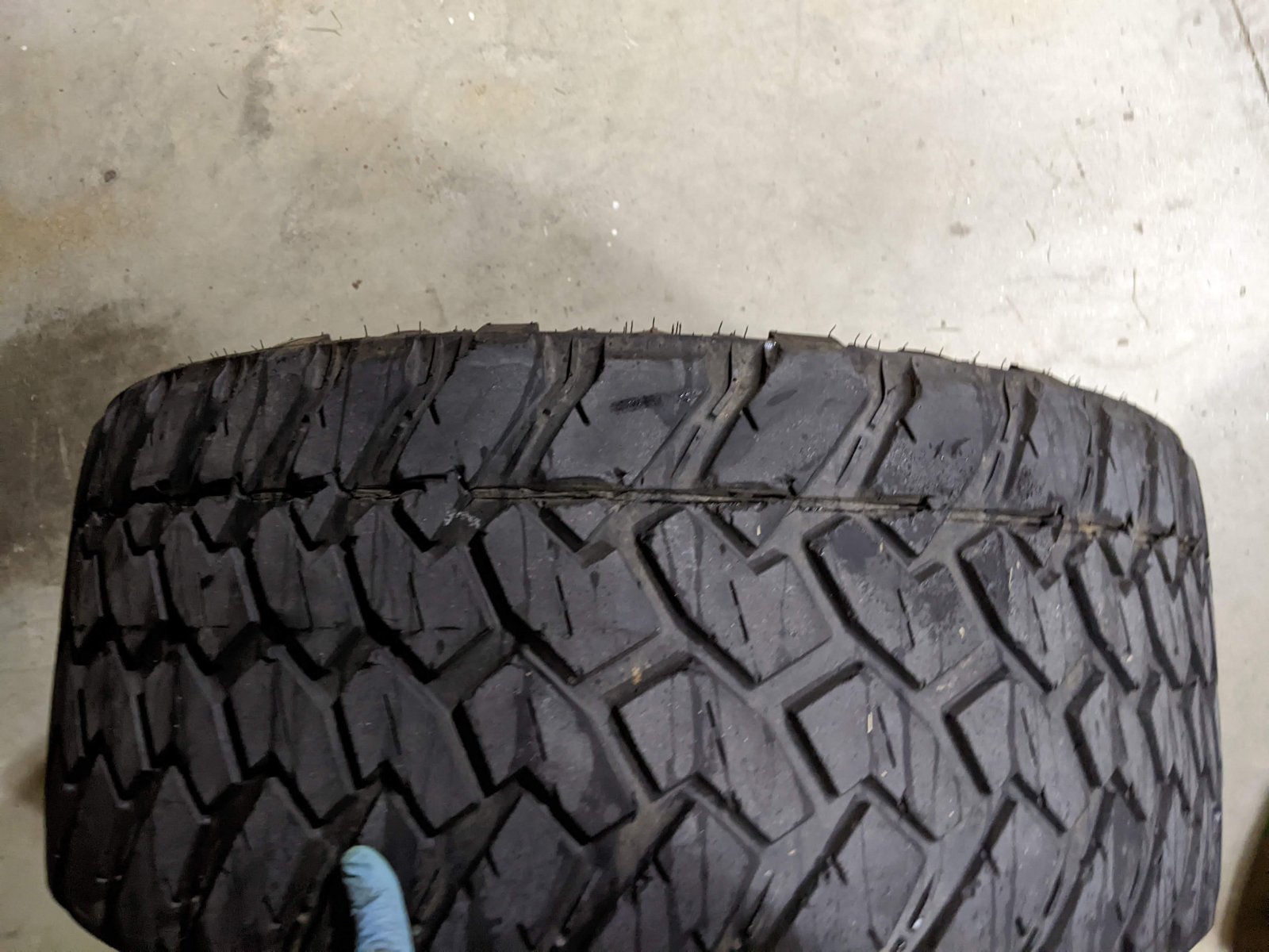

The car we bought for my son had some giant tires on it that rubbed the body underneath. There was literally a cut line all the way around the tire from where the metal had "dug" it out over time. That's what I'm afraid of. Here's a picture of the tire we took off his car.

Are you saying yours rub the fender liners in the wheel well? If that was the case I wouldn't be concerned as those are just plastic. However, these are rubbing on metal, granted it's smooth metal. But metal vs. rubber, metal will win.
I have never heard them rub but I can see tiny rub marks on the fender liner.
You're right metal is stronger than rubber but your rubber isn't solid either and if it rubs at full lock that's a rare event. I wouldn't worry about it personally and especially wouldn't introduce wheel spacers to your mix. The 1/4" wheel spacer you are talking about isn't a bolt on spacer either and will just give you less threads for your lug nuts to engage. Totally not worth!

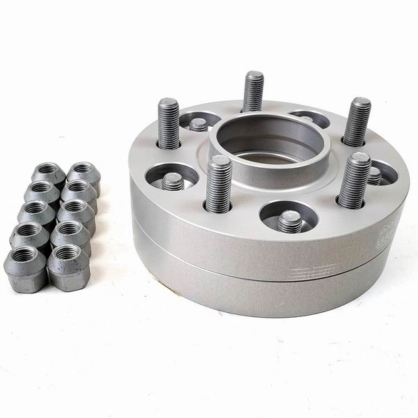

I'm not a fan of any wheel spacers due to the leverage that they create but the "safest" would be one like these which essentially gives you another full set of lug studs and another hub face to mate with the wheel. Of course in order to be able to do that the spacer has to be a lot bigger than 1/4".

For such a thin spacer though they are just a spacer not a bolt-on spacer, so regardless if lug or hub centric (although better) they are still pushing your wheel away from the mating surface and reducing the amount of usable threads you have. Unless these Bora spacers are different from what I have seen.
We have a set of these on my son's 4Runner. So far they have functioned well.
