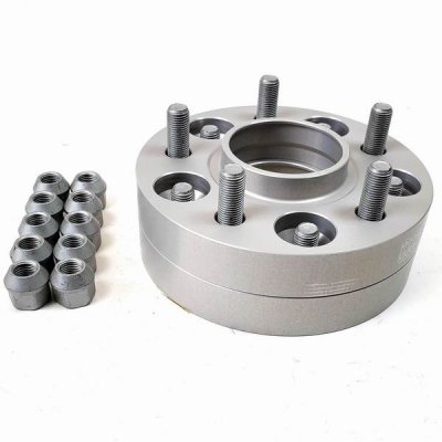

I'm not a fan of any wheel spacers due to the leverage that they create but the "safest" would be one like these which essentially gives you another full set of lug studs and another hub face to mate with the wheel. Of course in order to be able to do that the spacer has to be a lot bigger than 1/4".

For such a thin spacer though they are just a spacer not a bolt-on spacer, so regardless if lug or hub centric (although better) they are still pushing your wheel away from the mating surface and reducing the amount of usable threads you have. Unless these Bora spacers are different from what I have seen.
We have a set of these on my son's 4Runner. So far they have functioned well.
