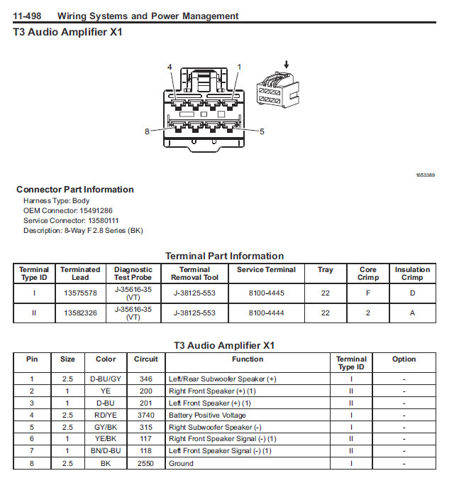

I tried connecting my line output converter to wires 1 and 5 but i don’t get any signal

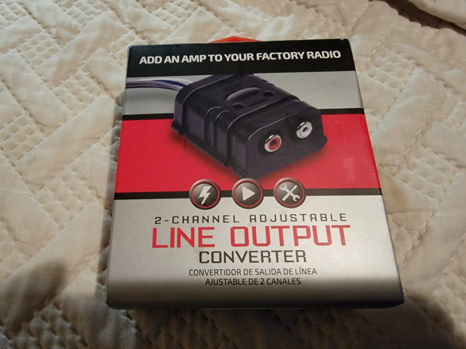

Hi, I used a METRA PART # AAPAJLO adjustable LOC on my 2016 LTZ. It will accept 55 watts . I purchased it from advanced auto for approximately 20 bucks . I have it driving a TARAMPS smart 3.1 on 3 eminence 18 LFD's This one has the remote turn on option so I just hooked the orange wire to the acc spade coming out of the fuse box beside the jack and ran the blue remote from the LOC to the TARAMPS sub amp. I summed the peaker level in puts and ran them to pins 1 and 5 which is the sub out +/- on the 8 pin amp plug. The bose auto pilot is off but i didnt have any issue with the amp cutting off. This amp only takes 4 v max so the LOC gains are set fairly low as is the amplifiers gain are as well.
where is the t3 connector located ?
