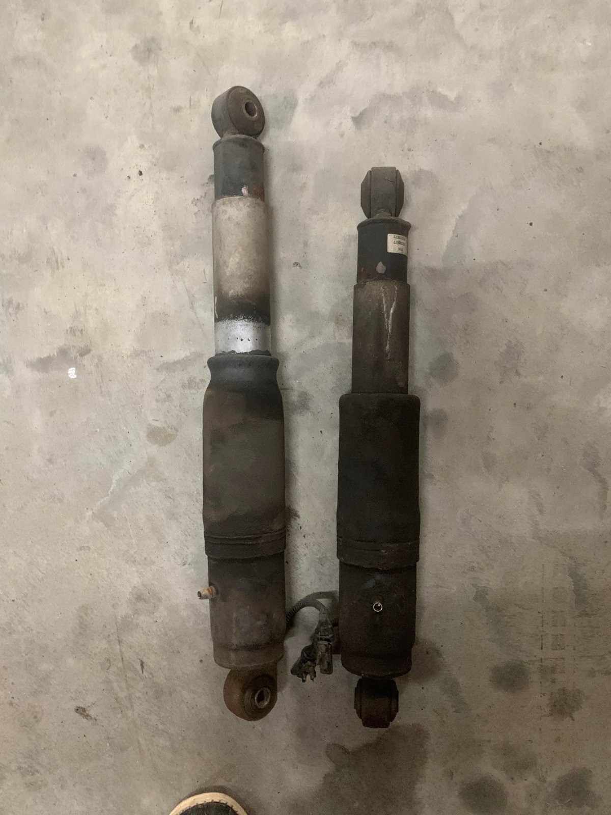

Just a little update on my road wagon ..... I purchased a bi directional scanner and during the scan process i noticed the rear air shocks was kicking the compressor on but didnt see the vehicle move ....so i got a new set of rear shocks and changed those last night and the passenger side was stuck half way extended and the drivers side was completely flat ..... drove it and it feels 10 times better !! but by just looking at the shocks on the vehicle you really couldnt tell that much difference until i got them off and laid them beside each other ......I do still have several codes that showed up on the scanner but Im still learning this new scanner so ive got to do some research on what these codes mean
