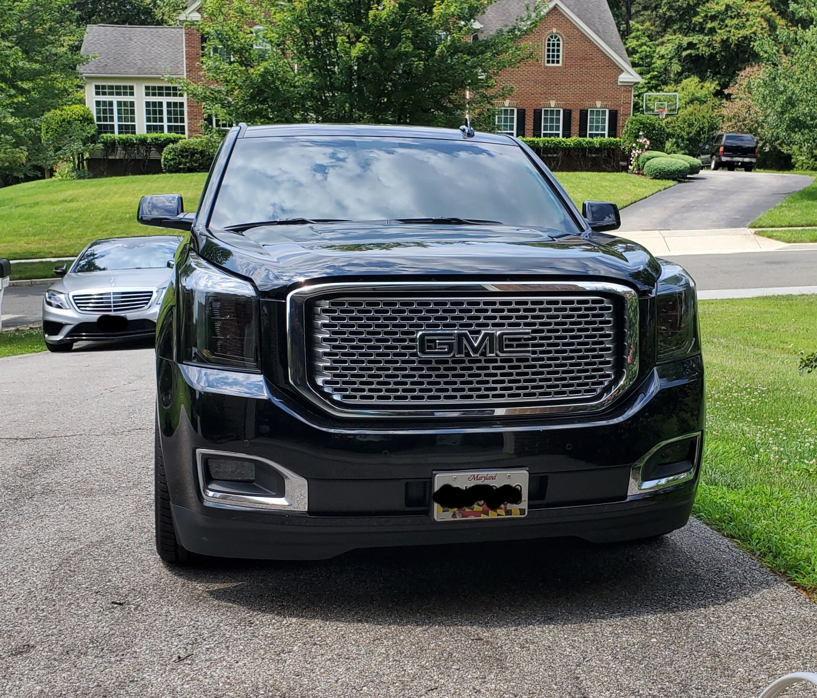

Got my set in today, They look really good. Going to install them over the weekend.
I do have a Question tho. Despite owning this vehicle for years, I just noticed recently that during the day when only my DRL's are on and I put the vehicle in park, the DRL's turn off and then don't come back on until I put the vehicle in drive. Is this normal function for these vehicles? I feel like I have seen other Yukon's on the street that have their DRL's on while in park.

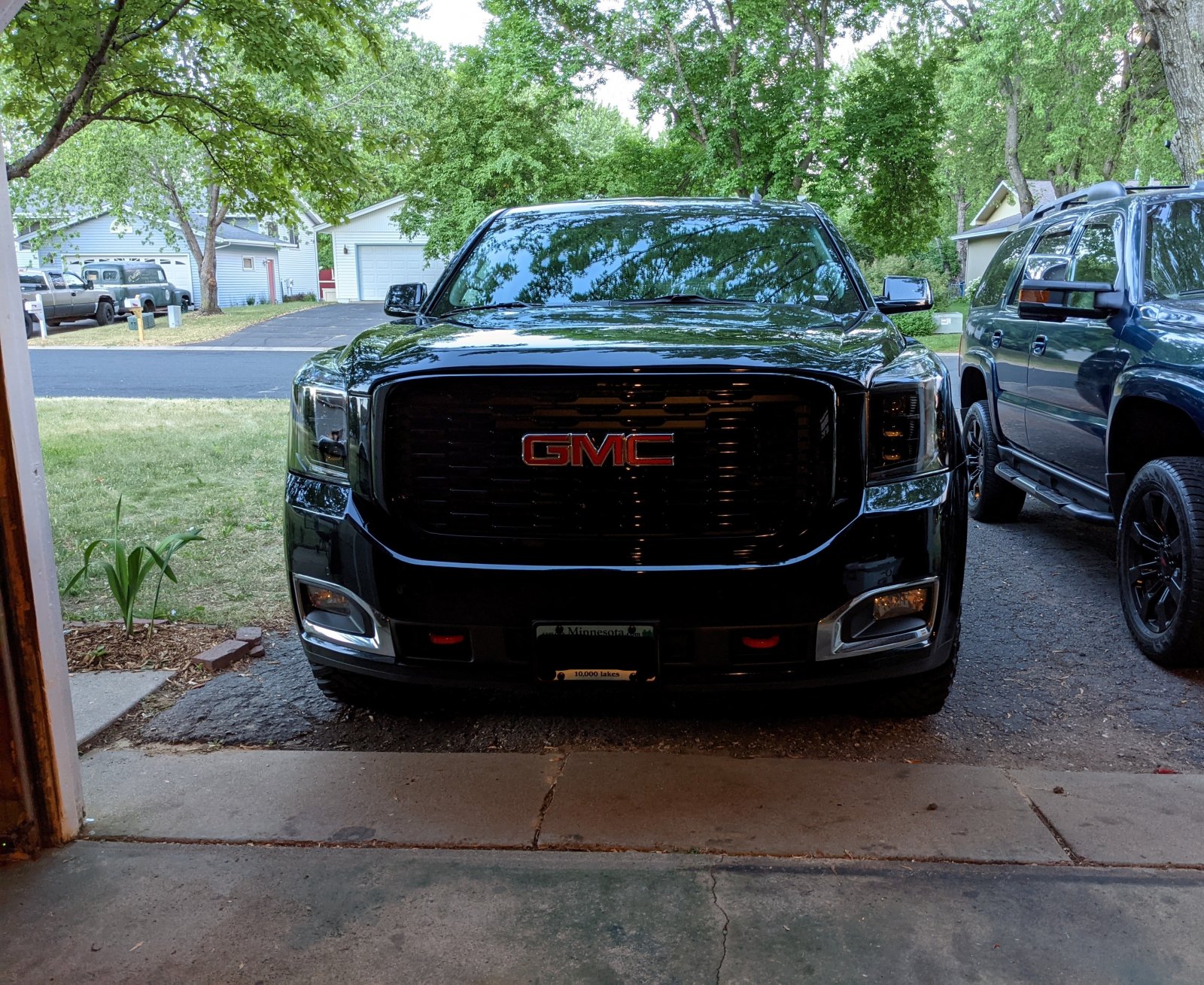

The lights ended up delivering today and was able to throw them in over the lunch break easy. They don't fit as perfectly snug against the fender as the stockers but holding them butted up against the fender while tightening the top-most bolts first seemed to get them pretty close. No hyper-flashing even with the aftermarket esky tails which was a concern. Going to leave the grill off until it's dark enough to calibrate. Grew impatient to leave 1 of the stock HID's in for any good comparison - maybe I'll throw the passenger back in tonight if I have time.

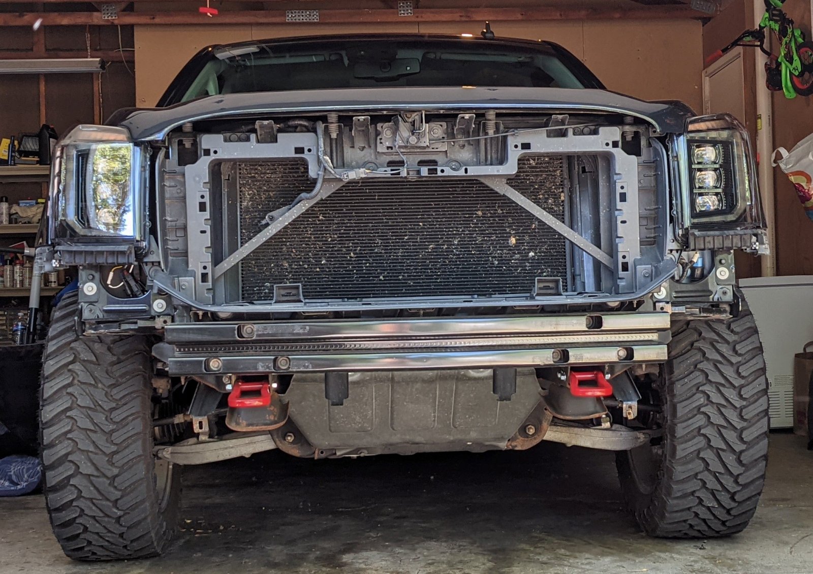

Take a shop vac to that radiator.

Heck yeah. Ended up brushing it with Maguire's & mineral spirits then hittin the rad with rustoleum.
The plug wires showed up yesterday ended swapping those. Noticeable difference after 100K+.
Would have been easier with the drivers side 33x12.5 off instead of going around it. The plugs went out/in ok though sitting in a chair. Used a ball-swivel head ext get #3 and then a 1/4" fuel hose at the plug end to fish around the steering shaft and in. #8 under the PS firewall sucked. Ended up using the fuel hose to fish that one in too. Two 1/2" ratchets - a torque & a shorter with a single 3/8" extension got 8 out/in but wasn't easy.
Put the lower tow hook valence in Friday night also. That seemed about as fun as the spark plugs. Broke one of the fog light clips but all holds together tight. Good time to clean the frame a bit with those wheel liners out. Ended up doing lazy-job just hitting what made sense with the rustoleum. Will definitely need to strip'er down again before winter and do everything before the salt wins.

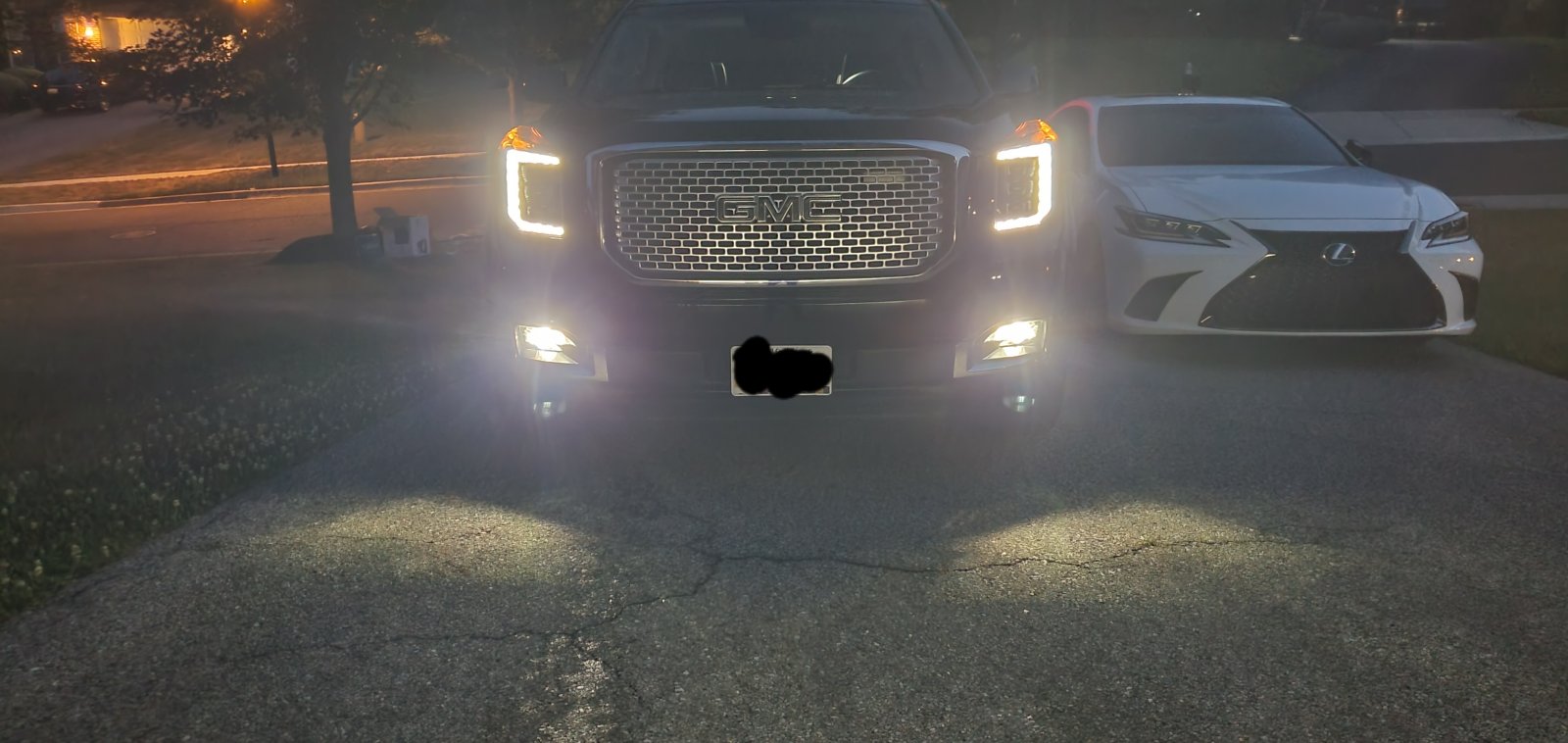

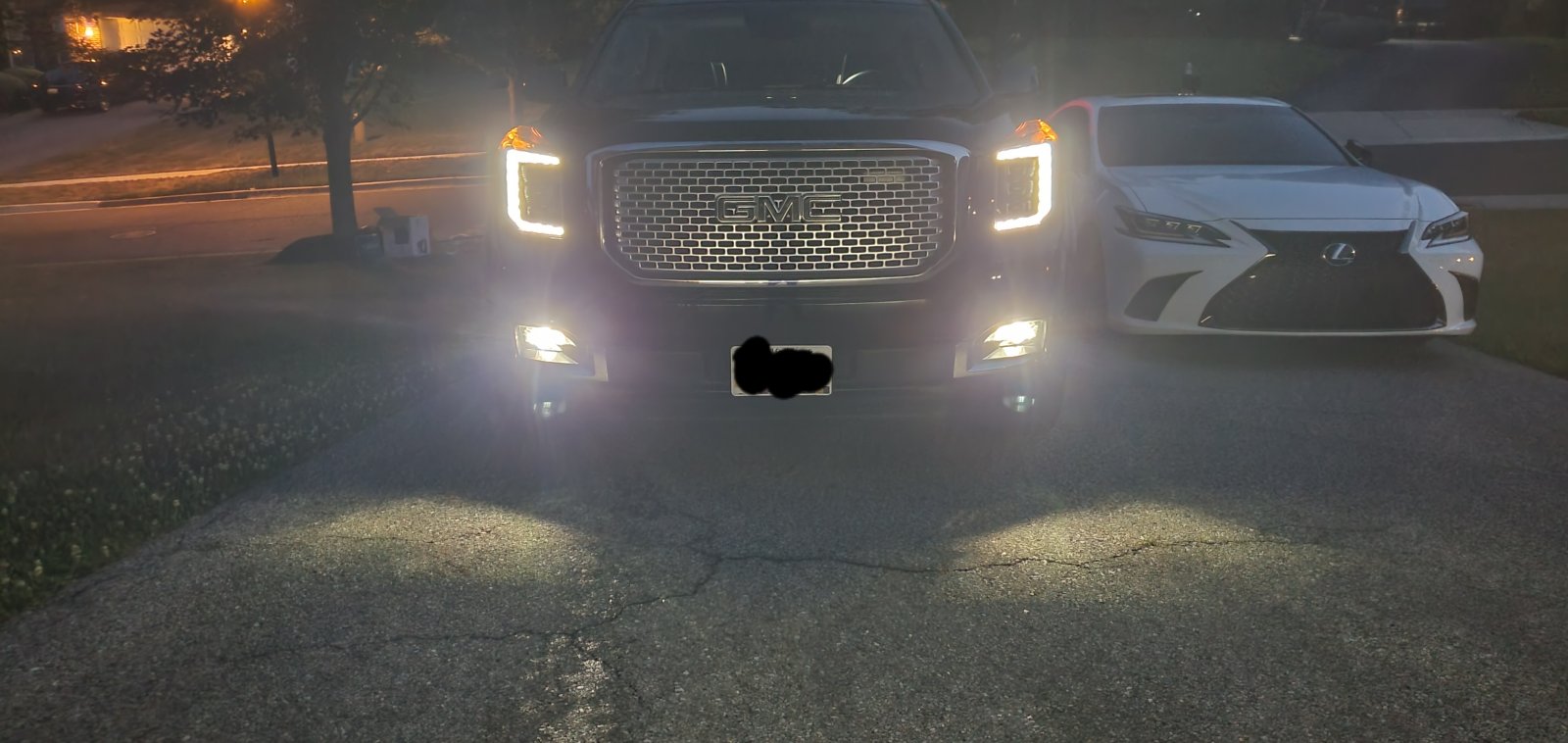

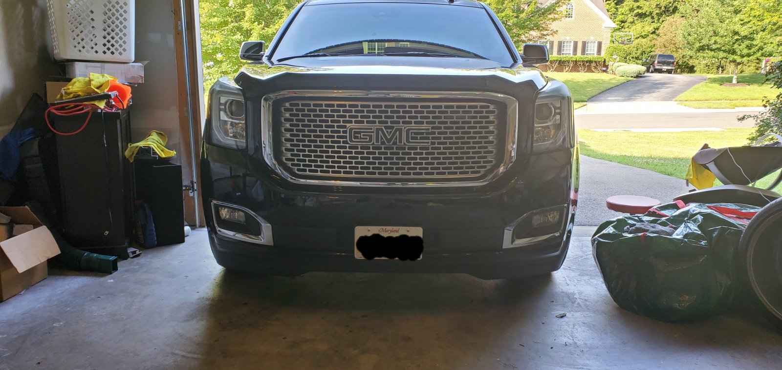

I finally had some downtime and installed the headlights. I had purchased the foglights with these a year ago and had them sitting for the last year. I put those in as well. Straightforward install. Fitment in the headlights could be better but they're not bad and are beautiful in person.
Haven't had a chance to check light output at night but they looked pretty dam good during the day. I'll get some night shots this week along with changing the grill.

Whenever you take some night pictures, could you snap a fog light only pic? I bought the same Morimoto fogs to go with the headlights and they don't seem to be as bright as I was expecting.

I'll definitely get some fog only shots. I had some 5000K leds in the stock housings and they were bright as hell. Could use them without headlights at night and have no trouble seeing but I suspect due to the scattered reflection of those housings I was blinding oncoming traffic. I have been highbeamed alot and could see clearly into the back of people's cars with just the fogs on.

Thanks. Mine look to be about the same brightness. My old fogs where exactly what you described, ridiculously bright and basically acted as a third headlight. I guess I wasn't expecting the Morimoto's to be less lumens and more focused from the projector.. but honestly that's probably a good thing, I rarely got flashed with the old ones but I know they probably annoyed people with how bright they where.
