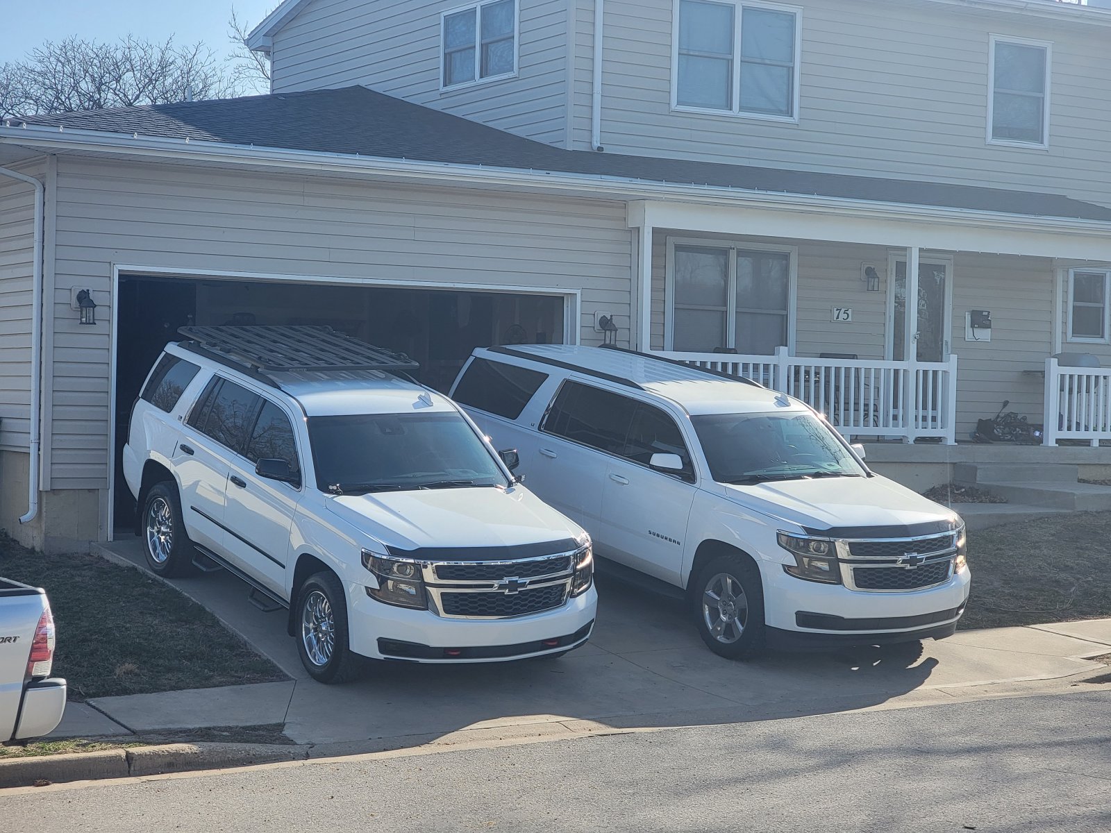

Wife drives a 2016 Suburban and I drive a 2018 Tahoe. Love them both.
