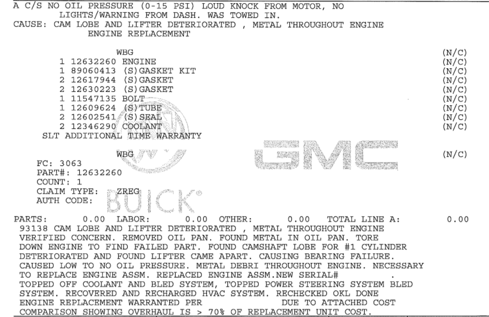

A few weeks prior i was getting random check engine lights that would go on / off and would say #1 cylinder misfire. I did the standard troubleshooting steps prior to that such as fuel injector, all new plugs / wires etc
Just recently my 5.3L LC9 engine decided to grenade itself (I think) due to the AAM - Active Fuel Management going crazy and causing #1 cylinder to grind down, and tweak out the lifter and what not. I had 0 oil pressure and the thing was knocking like crazy!
Luckily the guys at GM decided it wasnt worth it to try and fix the motor so they gave me a brand new crate motor (I know there will be some doubters so I attached the service order)
Since I have reset the clock on this motor and basically have a brand new vehicle (minus the transmission / rear end). Ive been looking at doing some upgrades right out of the gate since my warranty is almost up and probably wont get another motor!
