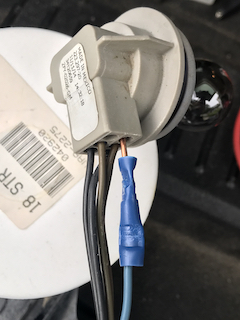

I replaced some bulbs and the only light I can't get to work is the LH brake light. Any tips on this?

Thanks for the info. Today I have to get the left brake light working. I'll check for power and if that doesn't work I'll do as someone here suggested and run a jumper wire from the right side.

The brake light problem turned out to be a bad socket. I'm ordering a new harness but did a quick fix for the inspection. I covered it with electrical tape as well.

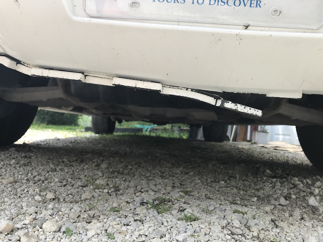

1. The front bumper is missing the air dam and is a bit ragged as per the photo below. I don't think the tabs at the bottom can be fixed so I'm thinking of cutting them off to make it look a bit cleaner. I may get a new bumper cover and air dam in the future.

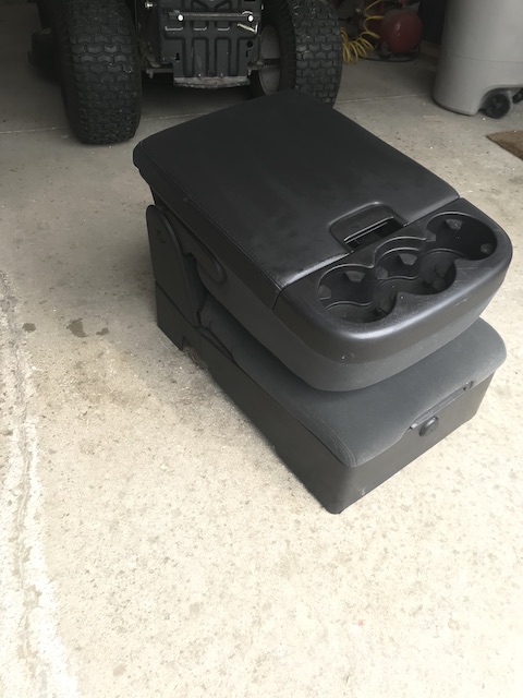

2. The vehicle came with a center console jump seat. However, it was just sitting there and is missing the 2 steel frame pieces to attach it to the front seat bolts. These don't seem to be available anywhere so I'm looking for ideas about what to do with this. If I can secure it to the floor somehow I'll keep it.
Thanks for any ideas.

These guys might be able to help.
Those look good. Thanks.
