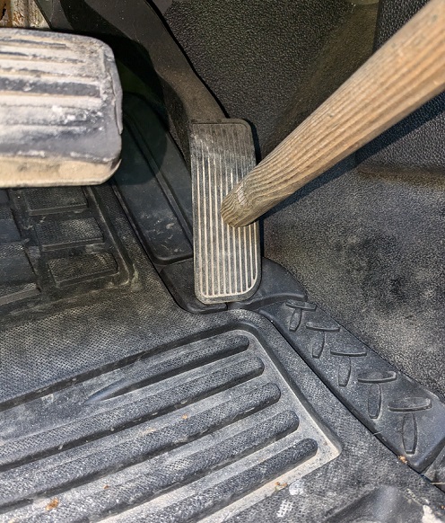

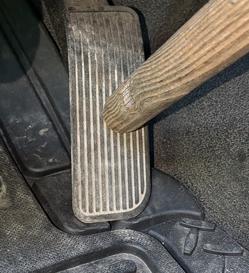

Thank you for all the helpful responses!! This place has a really good support network!!!
Sadly, after closer inspection I think I'm gonna go back to driver error.
I don't think my floor mats are spec, and when I tromped the pedal I believe it wedged into the mat.
Here's pics of what it looks like when depressed...
That little rubber ridge/crevice is really close to aligning perfectly with the pedal's edge, and I suspect on that road trip it got jostled into the sweet spot, ready to lock the pedal.
That mat has been removed.
With the big rubber floor in the PPV, I'm curious as to what the proper mat actually looks like...

You didn't need to get rid of the entire mat, just cut off the ridges in question.
Does the rubber floor have ANY floor mat retention features?

Well the mat is removed but not tossed out so I definitely can try that.
That's a good idea to trim it back and see if it's enough to prevent a reoccurrence.
Neither the floor nor the mat have any positive retention features that I can see.
