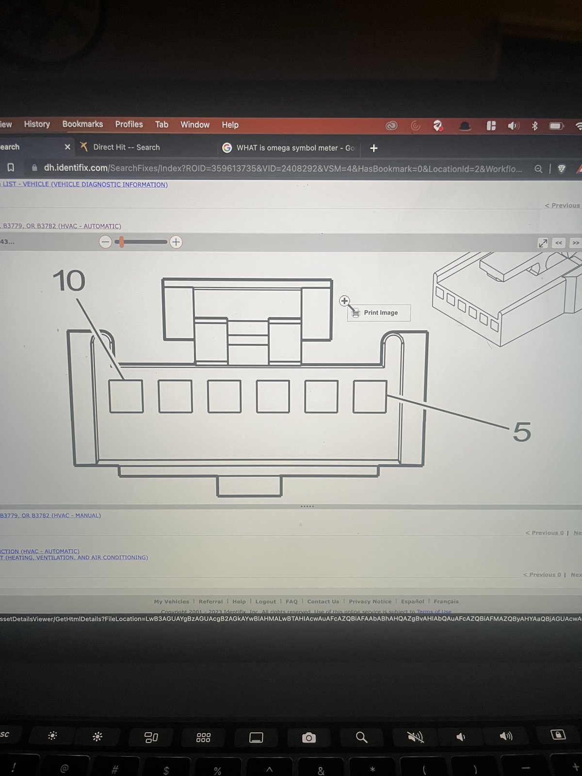

Hi Everyone, I’m really struggling with a rear hvac issue. The issue is that is only blows hot in rear . I’ve scanned it with a tech 2 and get code B0433. It shows symptom byte 5 and 4. I’ve cleared it and it has also shown symptom byte 2. Below is all of the thing I have tried with no luck.
Clearing the code and relearn
Replaced the actuators with OEM parts.
Swapped the actuators to verify that this is not the issue.
Checked blend door function.
On the tech 2 I can get the front hvac actuators to move in both directions, but the rear hvac actuators will not move all the way to cold or hot / floor or ceiling when I issue that command.
I’m leaning towards wiring or the hvac module.
Can anyone point me in the right direction. I can test the wiring for 12v and ground but don’t know how to test for the 5v signal. I have no ideas how to test the hvac module itself.

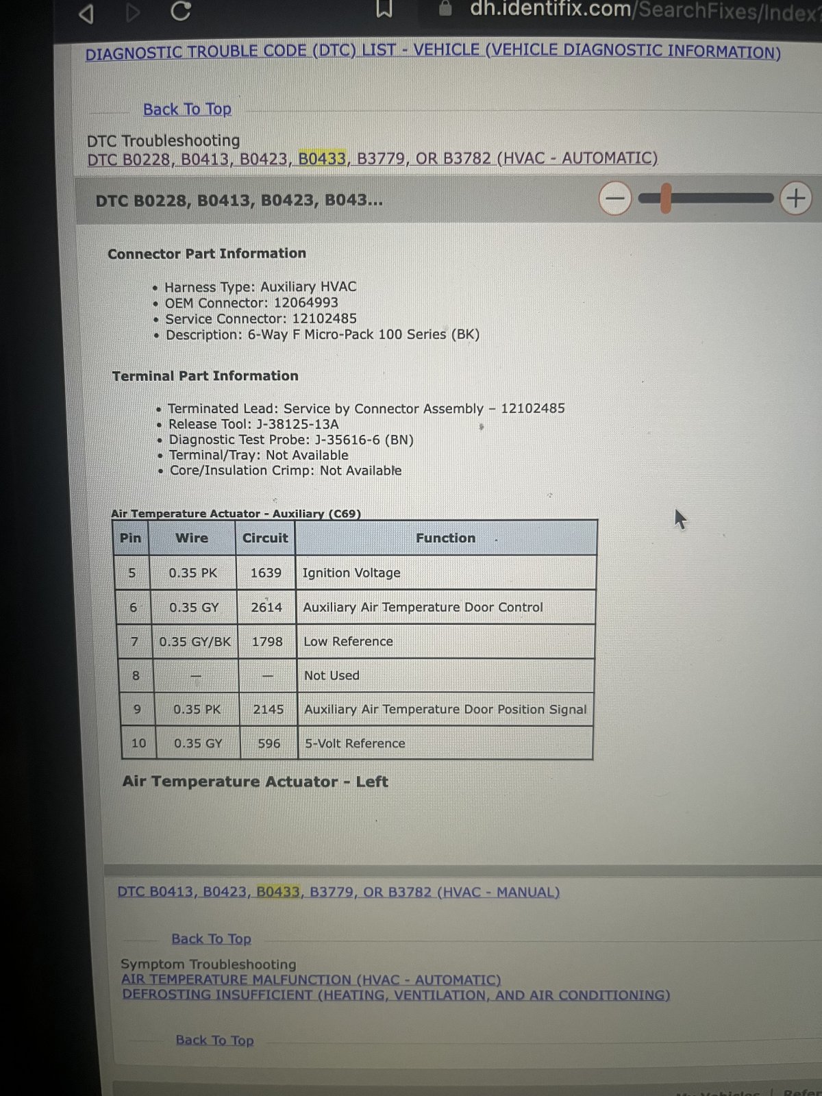

I have done some circuit testing.
When testing the low reference circuit I get a reading of 337 ohm. I think I now need to pull the hvac control module and test for continuity on this wire.
12 volt and 5 volt tested ok.
If the wire isn’t bad I believe this only leaves the hvac control module. Is
It common for these to go bad? Seems silly this would be bad on just the low reference circuit.
It’s not common, but it’s also not unheard of here. The electronics on these rigs are aging and we’ll start seeing more of these problems crop up as they go. My old ‘94 Acura started having multiple modules go bad in the last few years I owned it - usually the capacitors on the boards.

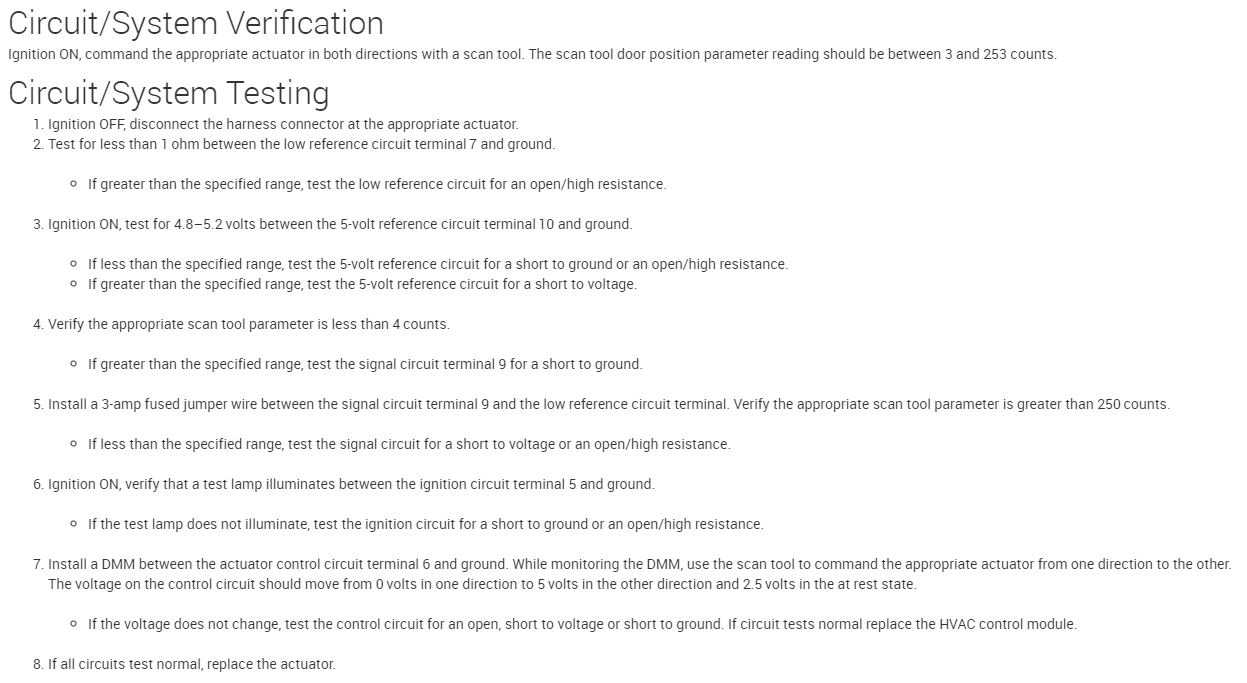

See earlier post from me on the same topic different chat. Its easy to fix, but you need to test the door position output voltage first.
