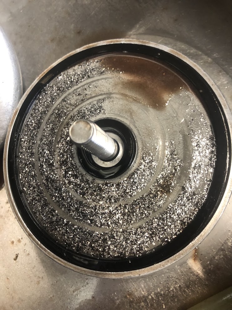

If you primarily drive local, the risk of waiting until parts need replaced is low. Worse case, you get a tow if you break down. If you make long distance trips, the risk of a major failure are greater as you'll be potentially stranded. My torque converter failed this January when I was 5 hours from home and I had to coordinate getting the truck shipped back as well as scramble to find a rental car on a Saturday. My torque converter was showing signs of wear with shuddering when coming to a stop for a couple of months before it gave out. I should have been more proactive but lesson learned.
As @Geotrash notes, it's much cheaper to pay for a torque converter replacement before it fails as once it goes, you get metal throughout your entire system. You're then looking at a more expensive rebuild. Here's what mine looked like post failure.
