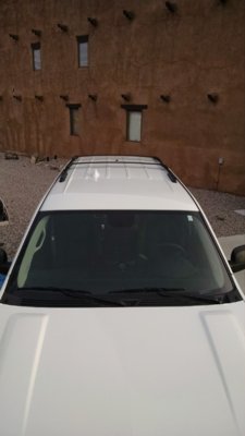

Finally got all the parts, the rivnuts, the bolts (I had 4, had to order 6, cheapest I saw was on eBay, $2.62 a piece, dealer $5-something)
I also bought a rivnut tool, I know it can be done with a bolt etc too, but I wanted something easy to use and NOT scratch up the roof or dent it. (I did a few test runs on washers, works pretty easy).
I bought the luggage rack from a salvage yard (in Dallas) for $165 (complete with all the trim pieces) and it was dirty, but no scratches, not bleached by the sun and it cleaned up really nice (almost as new) with "armor all". I was not too worried about the condition to begin with, one rain/snow/sand storm and it probably is back to how I saw it first.
I had to buy some rivnuts ($0.99 on eBay, and the said bolts, 10 of each), these rivnuts actually have a bead of sealant on the shank. The bolts have some rubbery sealant too.
Oh and I didn't have to do any drilling, the holes were already there (hex shaped holes, the rivnuts' shaft is hex too).
I'll attach the pics, from no rack to done.
Ron
(Yeah I can see the comments coming, "she has a nice rack" or "nice rack on that hoe" *lol*)
View attachment 190119 View attachment 190120 View attachment 190121

wouldn't let me post the last one. so here it is
Ron
