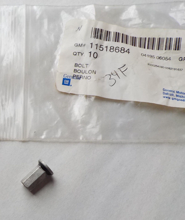

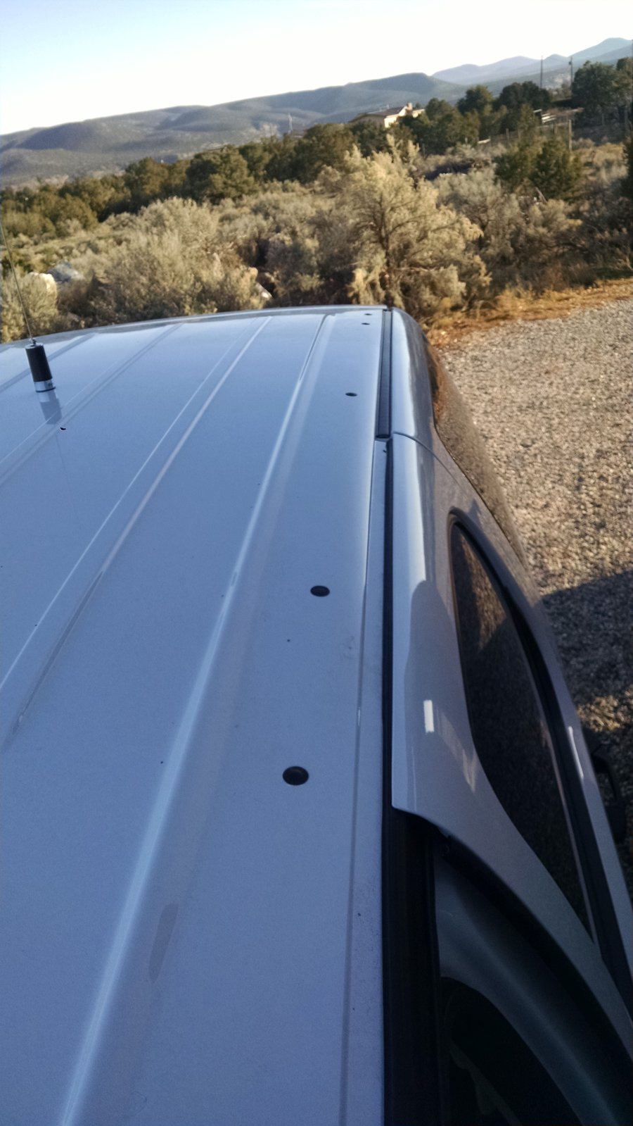

After I was done with the CB radio, I checked one of the holes for the luggage rack rails. I am pretty sure that the "G63: PROVISIONS LUGGAGE CARRIER, ROOF" basically means "holes in the right spot". I poked around in one of the holes, but didn't see/feel anything. Did anyone ever install or replace those rails?
Ron
PS: I attached a pic of one of these fasteners/nuts. The holes in the roof are hexagonal, and it looks like the nut/fastener goes in from the top. I wonder if it expands in a rivet sort of way?

Take a pick of the hole on roof and of the top and bottom of the ‘fastener’

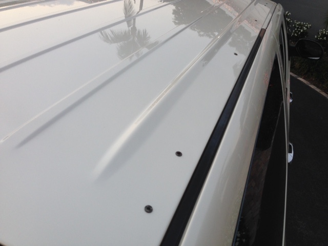

07-14 will fit no problem, (actually i think from nbs years up 00-14 will fit) i find it hard to believe the holes are in the roof with no nut in there. But then again, gm has done and does strange stuff...also escalade racks fit also.
Edit: Im answering you because i have a ‘civi’ 13 tahoe lt. (In case you’re wondering) i have no problem pulling my caps and taking pics for you btw.
Edit #2: looks like im wrong. You prob have to epoxy those nuts in there. Here’s a longbody with racks off20327AB7-6D82-46F5-9FD2-DCAFC69B8C81.jpeg

Oh I was able to take the plugs out, they are not glued even. They are rubber and are pretty snug (plug is a bit bigger than the hole). I poked around in the hexagonal hole and there doesn't seem to be anything there, on the inside. When I saw a pic of the nut (online) I wondered how it works.
I noticed the same rack (by GM part number) goes on several different models of GM truck/SUVs
I didn't take a pic, because after I pulled the plug, I saw nothing but a black hole, I think I would have seen the threads if there were any. I saw these nuts/fasteners on ebay for $0.99, so I guess GM found a ways to save almost $10 :)
Looks like yours has one hole more. Mine has the 2-1-2 'pattern of holes, looks like yours has a 2-1-1-2 kinda pattern (is it a Suburban?)

Yes thats a suburban, not mine though, another members here. I was just showing you what it would look like with the nuts in. I would guesvthey are epoxied in. Good luck

Hmm... but except for some 'thin' sheet metal, there is nothing in there that you can epoxy to. From what I see on that Suburban, and what the nut/fastener looks like it seems that the nut/fastener expands, sorta like a rivet. if it was in there epoxy-ed, I would wonder if a good gust of wind could actually pull it off.
