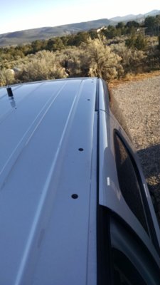

After I was done with the CB radio, I checked one of the holes for the luggage rack rails. I am pretty sure that the "G63: PROVISIONS LUGGAGE CARRIER, ROOF" basically means "holes in the right spot". I poked around in one of the holes, but didn't see/feel anything. Did anyone ever install or replace those rails?

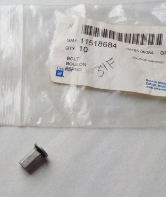

PS: I attached a pic of one of these fasteners/nuts. The holes in the roof are hexagonal, and it looks like the nut/fastener goes in from the top. I wonder if it expands in a rivet sort of way?

Take a pick of the hole on roof and of the top and bottom of the ‘fastener’

Oh I was able to take the plugs out, they are not glued even. They are rubber and are pretty snug (plug is a bit bigger than the hole). I poked around in the hexagonal hole and there doesn't seem to be anything there, on the inside. When I saw a pic of the nut (online) I wondered how it works.
I noticed the same rack (by GM part number) goes on several different models of GM truck/SUVs
I didn't take a pic, because after I pulled the plug, I saw nothing but a black hole, I think I would have seen the threads if there were any. I saw these nuts/fasteners on ebay for $0.99, so I guess GM found a ways to save almost $10 :)

Me neither, but "parts drawings" show the nut/fastener goes in from the top, The suburban pic also shows the flange of that fastener, and you can't see the hex-hole. I think the hole is hex shaped, so the fastener doesn't turn when you put the screw in.
I'm not positive, but for some reason I was thinking they used well nuts...
https://www.google.com/search?q=wel...n5LYAhWEG5AKHQyTBa8Q_AUICygC&biw=1920&bih=888
That is exactly what I was thinking (the name 'well nut" I couldn't remember). That would make sense, and actually be better than epoxying it. The screws I saw are machine screws.

I just received a message from a GM dealer, these nuts are called rivnuts, and they may need a special tool for installation(but also there are different 'techniques' to install one
I was told the thread size is: M6 x 1 x 16 I wonder if I indeed need a rivnut tool, or if the screw will crush them correctly by itself

I think that is what "G63: PROVISIONS LUGGAGE CARRIER, ROOF" is, holes in the right places. I am still thinking (and searching). Since the rivnuts have a hex shaft, maybe they don't need the install but just tightening the bolt while keeping the rails down. The rivnut tools I see are more for versions that are round instead of hex, but also, I think you can go either way.
