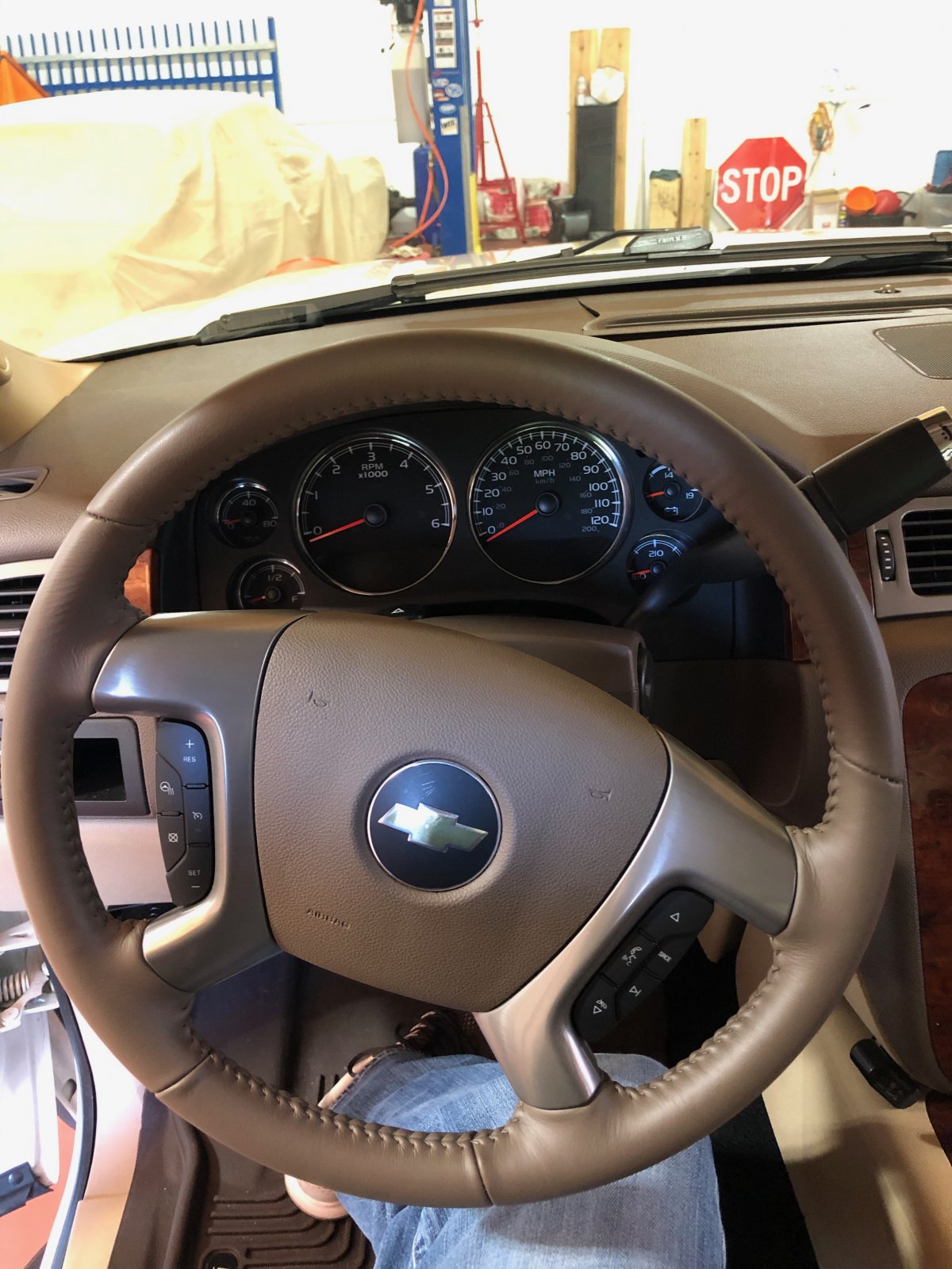

Hey guys, hoping someone can answer this. I have a 2013 suburban LTZ. It has cashmere colored steering wheel that is heated. Needs replacement. The GM wheel is being discontinued and I cannot find a 'new' wheel anywhere. Also the clock spring seems to be a specific model number if you have a heated steering wheel?? the reason I am asking is I found a new cashmere steering wheel that is NOT heated and does not have the radio controls. I am hoping to be able to convert the volume and phone switches on the right to the new wheel. If that goes well my concern is being that the heating element is not there will this be a plug and play and work with the clock spring???? Thanks for your experiences and help

Youll be fine. Everything will match up and you can move the controls from the old wheel to the new wheel. Since your new wheel isnt heated there wont be a plug from for the heated part to connect from the clockspring.

Received the new wheel yesterday. Brand new with the plastic on the wheel! I completely stripped everything from my wheel and transferred it over to the new wheel. I didn't want to use the new cruise button w/o heat as I was worried about the clock spring compatibility . So all my buttons and airbag onto new wheel. As Kee mentioned there are two plugs for the heated steering wheel. I plugged in the green one that powers up the harness for heat but obviously there is no element plug on the new wheel to plug into. Everything worked perfectly and all I lose is the heated steering wheel. I am cool with this compromise to get a brand new wheel. This was the perfect finishing touch on my truck. I had already detailed every inch of the interior and exterior, new everything including carpet. It is almost showroom new. The damaged and crappy wheel really took away from the truck. Now my OCD and truck are very happy!!
Thanks guys!!

feeling fresh!
