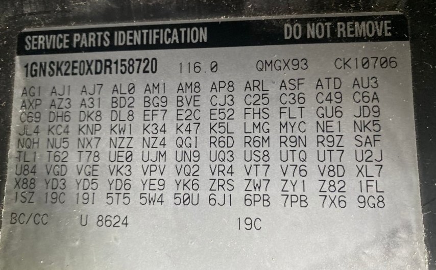

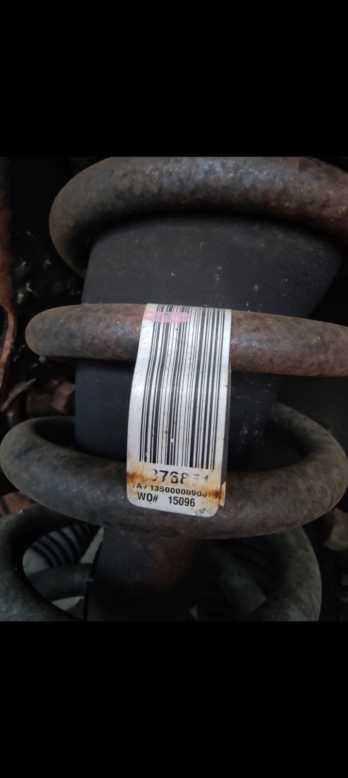

Front driver side is leaning down, from ground to top of wheel well is 33"and some change passenger side is just short of 35 at 34" 7/8 looking for parts not sure what I need for OEM parts as a lot of parts say without police package, really not sure if that matters, pics of front coil assembly and rpo codes, any help is appreciated
Any recommendations on upgrades for these would also be appreciated
